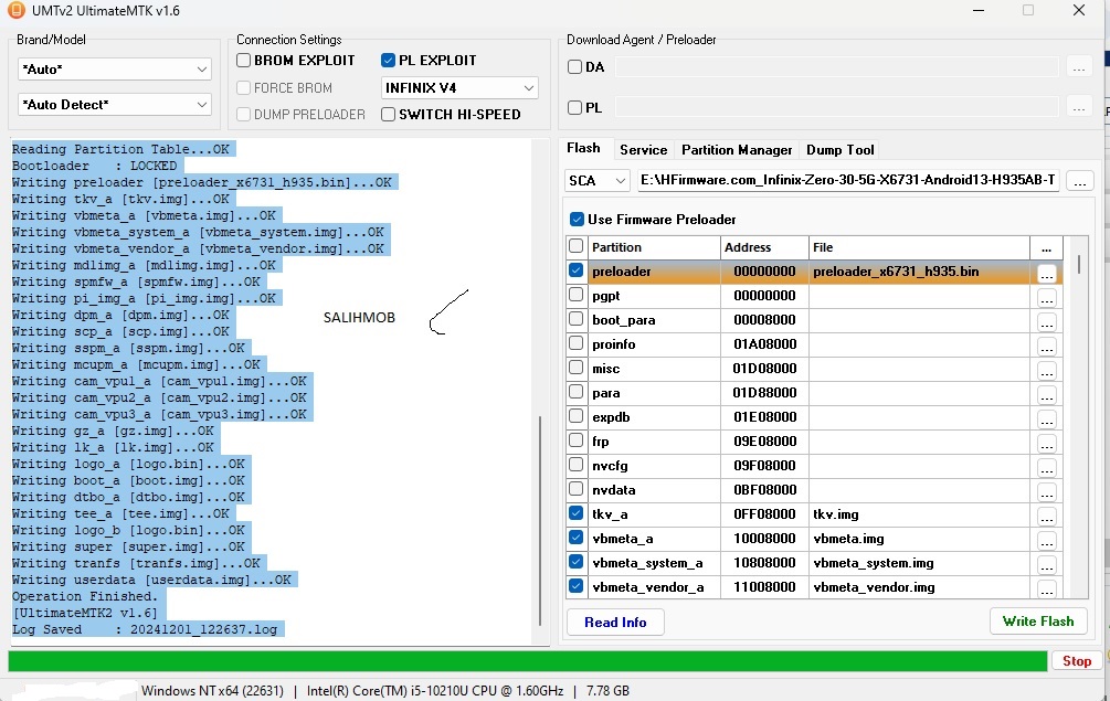

    INFINIX ZERO 30  5G (READ FLASH - WRITE - RESET FRP - FACTORY RESET)
    Brand/Model : *Auto* / *Auto Detect*
    Operation : Flash Scatter
    USING PL_EXLOIT [INFINIX V4]
    Using Preloader from Firmware
    BOOT CFG : [PL_EXPLOIT : ON]
    Waiting for Device...Found
    Port : MediaTek PreLoader USB VCOM_V1633 (Android) (COM40)
    Device Path : \\?\usb#vid_0e8d&pid_2000#5&1f44e00&0&2#{a5dcbf10-6530-11d2-901f-00c04fb951ed}
    Driver : MediaTek Inc., 3.0.1504.0 [usb2ser.sys]
    Mode : PRELOADER
    Hw ID : MT6893 [0950] Dimensity 1200
    Details : 8A00,CA00,0000
    Sec. Config : [SBA:True] [SLA:False] [DAA:True]
    MEID : B439047E3E73A937340FC223635C83CA
    SoC ID[0] : C7AA602BCBD288B67B461D5A6764E117
    SoC ID[1] : 587917AAB0515E9C0E71D9F95D7D6609
    Using Internal DA!
    Sending 1st DA..OK
    Jump DA Address...OK
    Syncing...OK
    Checksum Level is Storage
    Connection : preloader
    Speed : HIGH-SPEED
    Reading RAM Configuration...OK
    Sending 2nd DA...OK
    HRID : 23D56CFC97701570B3E9242FC7CC2A4B
    Int. RAM : 0x0000000000070000 [448.00 KB]
    Ext. RAM : 0x0000000100000000 [4.00 GB]
    Flash ID : KLUEG4RHGB-B0E
    CID : CE014B4C55454734524847422D423045
    BOOT1 : 0x0000000000400000 [4.00 MB]
    BOOT2 : 0x0000000000400000 [4.00 MB]
    RPMB : 0x0000000000400000 [4.00 MB]
    USERAREA : 0x0000003B96000000 [238.34 GB]
    PRE EOL : NORMAL
    Life. Est.A : 0%-10% LIFE TIME USED
    Life. Est.B : 0%-10% LIFE TIME USED
    Reading Partition Table...OK
    Bootloader : LOCKED
    Writing preloader [preloader_x6731_h935.bin]...OK
    Writing tkv_a [tkv.img]...OK
    Writing vbmeta_a [vbmeta.img]...OK
    Writing vbmeta_system_a [vbmeta_system.img]...OK
    Writing vbmeta_vendor_a [vbmeta_vendor.img]...OK
    Writing md1img_a [md1img.img]...OK
    Writing spmfw_a [spmfw.img]...OK
    Writing pi_img_a [pi_img.img]...OK
    Writing dpm_a [dpm.img]...OK
    Writing scp_a [scp.img]...OK
    Writing sspm_a [sspm.img]...OK
    Writing mcupm_a [mcupm.img]...OK
    Writing cam_vpu1_a [cam_vpu1.img]...OK
    Writing cam_vpu2_a [cam_vpu2.img]...OK
    Writing cam_vpu3_a [cam_vpu3.img]...OK
    Writing gz_a [gz.img]...OK
    Writing lk_a [lk.img]...OK
    Writing logo_a [logo.bin]...OK
    Writing boot_a [boot.img]...OK
    Writing dtbo_a [dtbo.img]...OK
    Writing tee_a [tee.img]...OK
    Writing logo_b [logo.bin]...OK
    Writing super [super.img]...OK
    Writing tranfs [tranfs.img]...OK
    Writing userdata [userdata.img]...OK
    Operation Finished.
    [UltimateMTK2 v1.6]
    Log Saved : 20241201_122637.log
