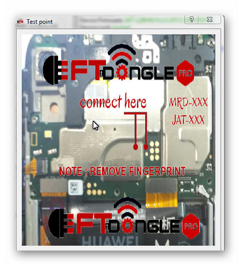

كود:
Waiting fastboot device ...Device found
Reading device Info ...
Device Model			:	JAT-L29
Device Firmware		:	JAT-L29HW 9.1.0.451(C185E3R1P2)
Country			:	MIDDLE EAST and AFRICA
Current Status			:	SAFE
FB Lock			:	LOCK
FRP Unlock			:	LOCK
1. Power off device
2. Remove Install battery if needed
3. Connect USB cable to powered off device
4. For New sec. Press and Hold Both Volume keys for Brom Mode
5. For Old sec. Press and Hold Volume UP for Brom Mode
6. Do not press any Key for PreLoader Mode
7. Install drivers if needed
- Connection : Flash Mode
- Method : By Model
- Brand : Huawei
- Model : JAT-AL29 (Honor 8A Pro)
- Process : Reset FRP
Authenticating  ...  DONE
Initializing ... DONE
Waiting for device ...
Device found
MediaTek USB Port (COM32)
Mode : BootRom
Port : COM32
Handshaking ...  DONE
Initializing :  DONE
Hw code: MT6765 - Helio P35/G35
Hw sub code: 8A00
Hw version: CA00
Sw version: 0000
Watchdog disable ...  DONE
Protection disable ...  DONE
Preparing Download Agent ...
DA Version : MTK_AllInOne_DA_v3.3001.2018/10/18.17:38_452898
Drivers : MediaTek Inc.
Driver Date : 11/06/2014
Driver Version : 2.0.1136.0
Handshaking : DONE
Loading Preloader : DONE
Booting device : DONE
Chip name :  [MT6765]
Syncing with DA : DONE
Identifying Hardware ID ...
ChipID 		:	MT6765
Software Ver 	:	0000
Hardware Ver 	:	CA00
Secure Ver 	:	00
BootLdr Ver	:	00
Ext RAM		:	0xC0000000
SRAM		:	0x00080000
Storage		:	0x0E91000000
RAM Size	:	3.000 GB
SRAM Size	:	512.000 KB
Storage Size	:	58.266 GB
Storage Type	:	EMMC
Getting partition details : DONE
Partition count : 47
Searching FRP data...  DONE
Resetting FRP...
USING ALGO - 1
Reset FRP DONE
Please disconnect device and reboot it manually
UAT PRO : 150.01 | 02 - كانون*الثاني - 2023  [ 03:48:25 م ]
Elapsed Time  :  17 seconds
