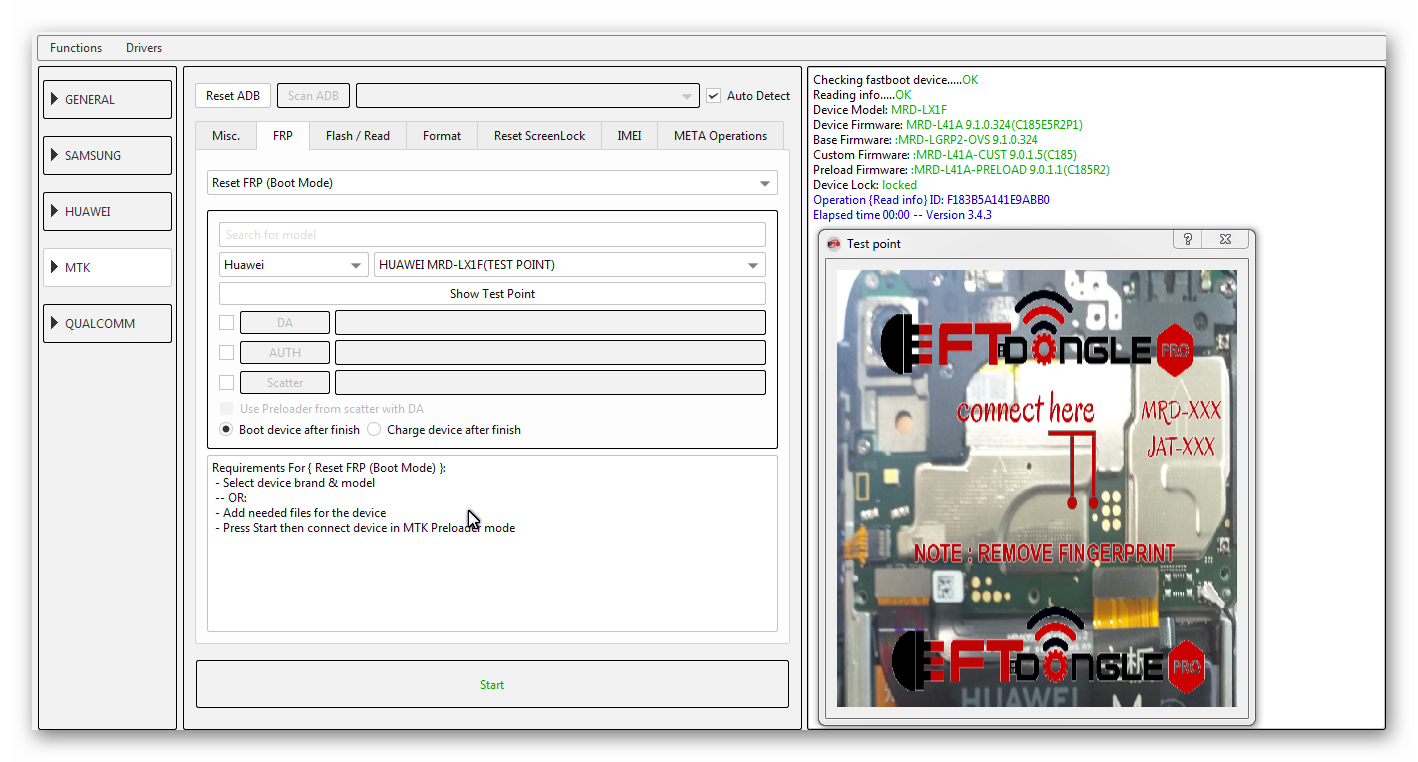

    افتراضي ازالة قفل FRP لهاتف Huawei Y6 Prime 2019 MRD-LX1F بالتيست بوينت 9.1.0.324
    نفس الطريقه بالموضوع هنا
    لكن الحمايه اعلى 9.1.0.324

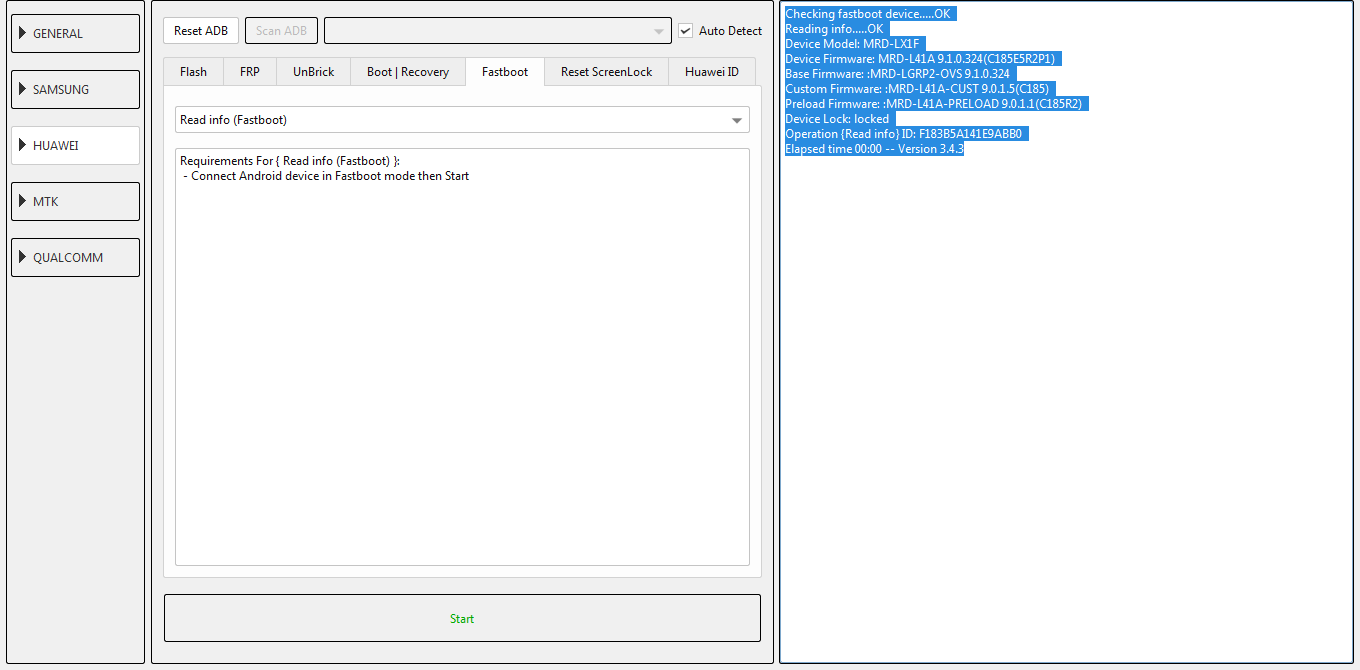

    كود:
    Checking fastboot device.....OK Reading info.....OK
    Device Model: MRD-LX1F
    Device Firmware: MRD-L41A 9.1.0.324(C185E5R2P1)
    Base Firmware: :MRD-LGRP2-OVS 9.1.0.324
    Custom Firmware: :MRD-L41A-CUST 9.0.1.5(C185)
    Preload Firmware: :MRD-L41A-PRELOAD 9.0.1.1(C185R2)
    Device Lock: locked
    Operation {Read info} ID: F183B5A141E9ABB0
    Elapsed time 00:00 -- Version 3.4.3

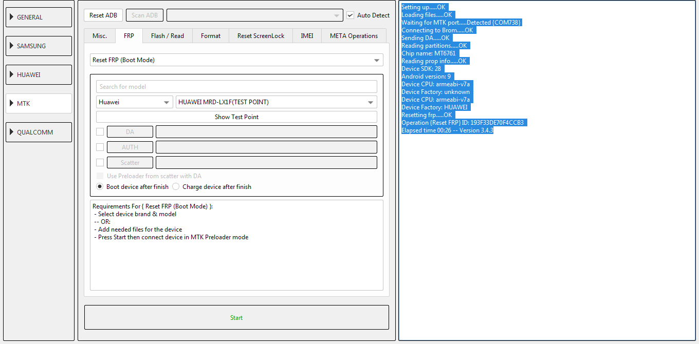

    Setting up.....OK
    Loading files.....OK
    Waiting for MTK port.....Detected {COM738}
    Connecting to Brom.....OK
    Sending DA.....OK
    Reading partitions.....OK
    Chip name: MT6761
    Reading prop info.....OK
    Device SDK: 28
    Android version: 9
    Device CPU: armeabi-v7a
    Device Factory: unknown
    Device Factory: HUAWEI
    Resetting frp.....OK
    Operation {Reset FRP} ID: 193F33DE70F4CCB3  Elapsed time 00:26 -- Version 3.4.3
