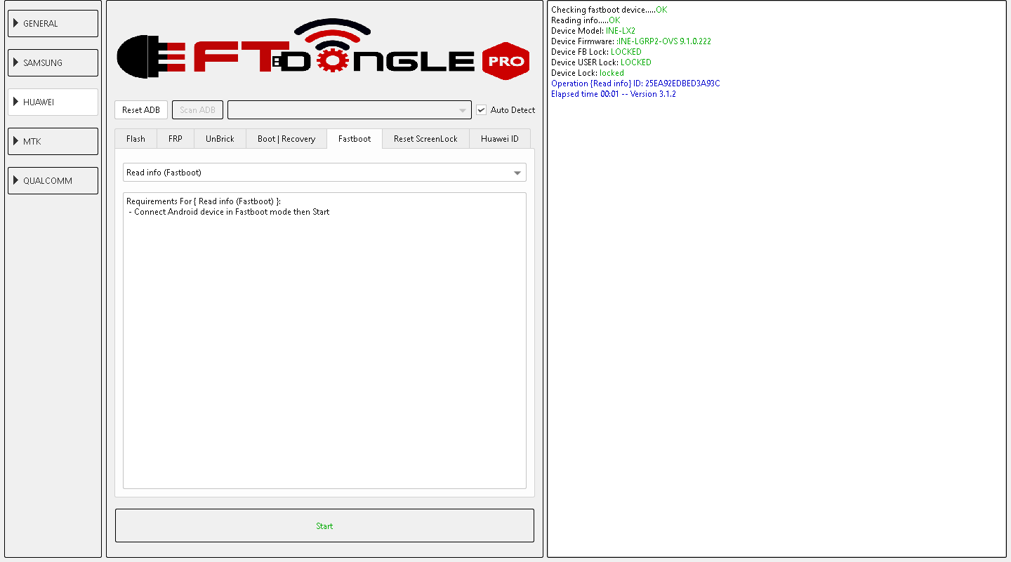

    هات ريد انفو من الدونغل لو سمحت
    +/963988244977+
    Feb 2020
    ريد انفو من الدونغل
    https://img.gem-flash.com/images/609...5857575278.png
    Checking fastboot device.....OK
    Reading info.....OK
    Device Model: INE-LX2
    Device Firmware: :INE-LGRP2-OVS 9.1.0.222
    Device FB Lock: LOCKED
    Device USER Lock: LOCKED
    Device Lock: locked
    Operation {Read info} ID: 25EA92EDBED3A93C
    Elapsed time 00:01 -- Version 3.1.2
