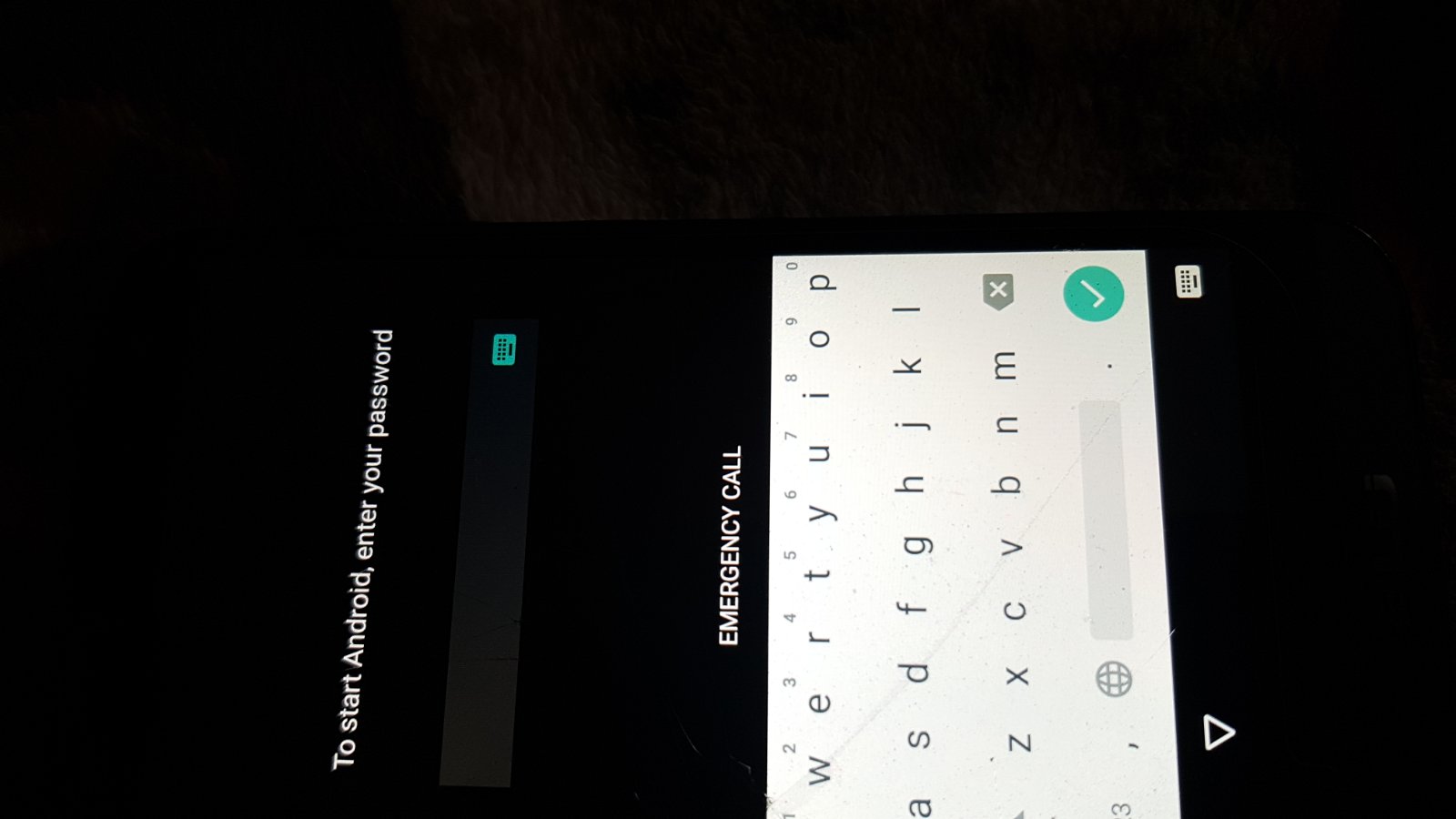

    شباب عند تشغيل يعطي التالي واملك دنقل eft وللعلم لم اتحصل على روم له
    Wating Device..........OK
    CPU: MT6580
    Chip Version: 0x0000ca00
    Chip Ext Clock: EXT_26M
    Writing Mode..........OK
    Internal RAM:
    Internal SRAM Size: 128.00 KB
    External RAM: Type DRAM
    External Ram Size: 1.00 GB
    EMMC:
    EMMC PART BOOT1 Size: 4.00 MB
    EMMC PART BOOT2 Size: 4.00 MB
    EMMC PART RPMB Size: 4.00 MB
    EMMC PART USER Size: 7.13 GB
    Battery:
    Battery Voltage: 4131
    Injection..........OK
    Detecting Parts info............OK
    [ID: 1] [preloader] BaseAddr(0x00000000) Size(0x00400000)
    [ID: 8] [pgpt] BaseAddr(0x00000000) Size(0x00080000)
    [ID: 8] [proinfo] BaseAddr(0x00080000) Size(0x00300000)
    [ID: 8] [nvram] BaseAddr(0x00380000) Size(0x00500000)
    [ID: 8] [protect1] BaseAddr(0x00880000) Size(0x00a00000)
    [ID: 8] [protect2] BaseAddr(0x01280000) Size(0x00a00000)
    [ID: 8] [seccfg] BaseAddr(0x01c80000) Size(0x00040000)
    [ID: 8] [lk] BaseAddr(0x01cc0000) Size(0x00060000)
    [ID: 8] [boot] BaseAddr(0x01d20000) Size(0x01000000)
    [ID: 8] [recovery] BaseAddr(0x02d20000) Size(0x01000000)
    [ID: 8] [para] BaseAddr(0x03d20000) Size(0x00080000)
    [ID: 8] [logo] BaseAddr(0x03da0000) Size(0x00800000)
    [ID: 8] [expdb] BaseAddr(0x045a0000) Size(0x00a00000)
    [ID: 8] [frp] BaseAddr(0x04fa0000) Size(0x00100000)
    [ID: 8] [nvdata] BaseAddr(0x050a0000) Size(0x02000000)
    [ID: 8] [metadata] BaseAddr(0x070a0000) Size(0x02760000)
    [ID: 8] [oemkeystore] BaseAddr(0x09800000) Size(0x00200000)
    [ID: 8] [secro] BaseAddr(0x09a00000) Size(0x00600000)
    [ID: 8] [keystore] BaseAddr(0x0a000000) Size(0x00800000)
    [ID: 8] [system] BaseAddr(0x0a800000) Size(0xa0000000)
    [ID: 8] [cache] BaseAddr(0xaa800000) Size(0x0e000000)
    [ID: 8] [userdata] BaseAddr(0xb8800000) Size(0x10e780000)
    [ID: 8] [flashinfo] BaseAddr(0x1c6f80000) Size(0x01000000)
    [ID: 8] [sgpt] BaseAddr(0x1c7f80000) Size(0x00080000)
    Detecting Device info.......OK
    Product: BLU
    Device Model: Dash XL
    ID: BLU_D710_V10_GENERIC 09-11-2016 20:00
    Sw Internal:
    Build Date: Wed Nov 9 19:50:50 CST 2016
    Chip Ver: S01
    Android Version: 6.0
    Architecture: armeabi-v7a
    All Done By EFT Dongle

    فرمط الجهاز اولا ان شاءالله يظبط معاك
    واذا اضطررت للتفليش
    اتبع التالي
    اولا عليك عمل باكاب قبل التفليش
    ثانيا اعمل مقارنه للفلاشه
    ثالثا اذا قمت بالتفليش لا تفلش البيرلودر
    https://mega.nz/#!EsQlSABR!d6HdeqW7w...BUO_5wD1dbk18Q

    الله يبارك فيك معلم على رد
    اولا عملتله فورمات ونفس المشكلة
    والان جاري تنزيل للسوفت

    معلم الملف مقدم من حضرتك غير صالح عند فك ضغط
    استفسار هل روم D710 يمشي او D710U
