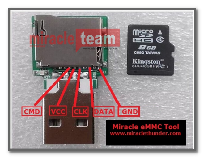

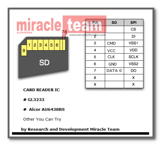

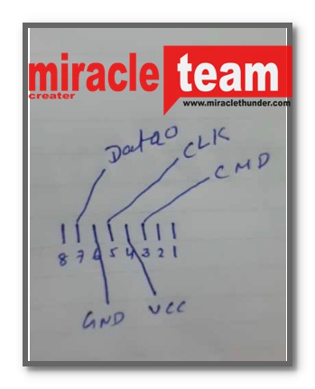

    MIRACLE eMMC Plus Tool
    How to Make eMMC Hardware with Card Reader
    update version emmc Plus
    Take Good Card Reader
    • Better Use GL3233 IC Based Card
    • Better Use Alcor AU6438BS IC Based Card
    Check Image 1
    imagenumber 2019 07 22 at 19 51 40
    Check Image 2
    imagenumber 2019 07 22 at 19 53 03
    Check Image 3
    imagenumber 2019 07 22 at 19 54 21
    Check Image 4
    imagenumber 2019 07 22 at 19 56 46
    Tested by Miracle Team
    Our main moto is give cheapest Solution, because making eMMC/Jtag/ISP Box is too expensive.
