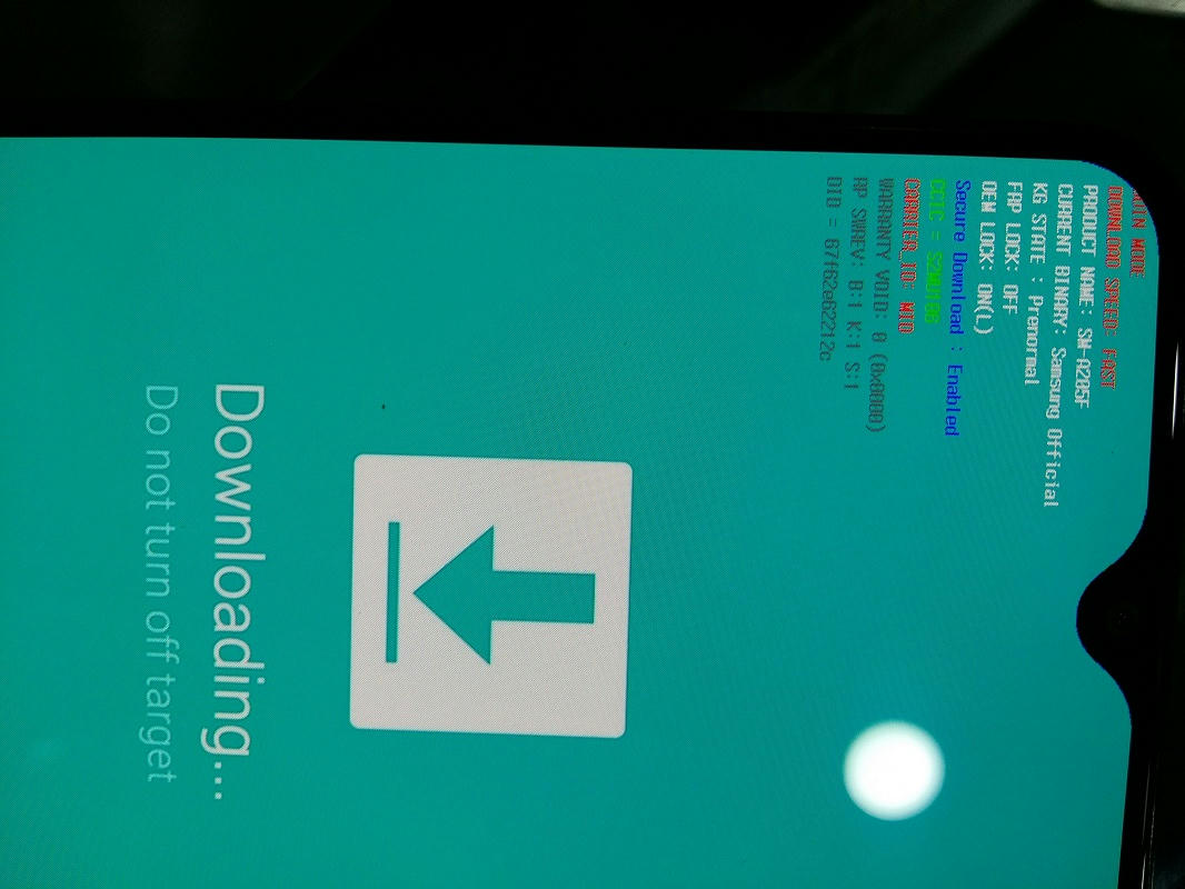

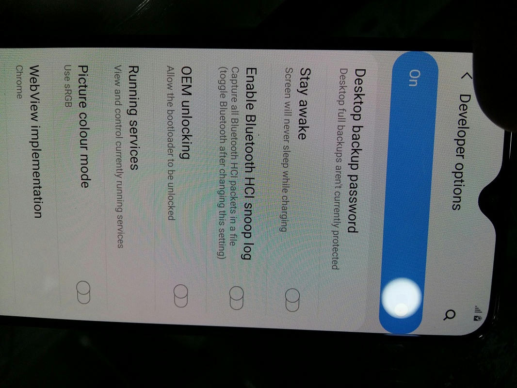

    لاوجود لل OEM UNLOCK
      online
    وضع الداونلود مود
    kt1vovibmv8ifaizg
    ازالة حماية KNOX GUARD KG STATE PRENORMAL

    Knox Guard Unlock started
    Gathering phone info...
    Collecting information. Be patient! Do NOT disconnect the phone!
    Model: SM-A205F
    Sales Code: MID
    Country Code: Iraq
    Timezone: Asia/Baghdad
    Android Version: 9 [PPR1.180610.011] [SDK 28]
    Build Date: Wed Mar 6 21:29:09 KST 2019
    PDA Version: A205FXXU1ASC5 [march 2019, rev5]
    Phone Version: A205FDDU1ASC6 [march 2019, rev6]
    CSC Version: A205FOJM1ASC5 [march 2019, rev5]
    Product Code: MID
    HIDSw Version: A205FXXU1ASC5/A205FOJM1ASC5/A205FDDU1ASC6/A205FXXU1ASC5
    Board Platform: EXYNOS5
    Modem Platform: SHANNON327
    Serial Number: R58M46XAFDW
    Imei: 357086103233860
    Unique Number: CBJ00C45CE86646
    Connections: AT,MTP
    Battery Status: 3.98V (65%)
    Network Type: GSM
    SIM Status: ABSENT,ABSENT
    Multisim Config: DSDS
    Knox Version: v30
    Warranty Bit: 0
    Security Patch: 2019-02-01
    Data Encryption State: encrypted

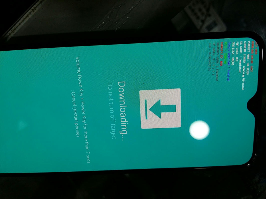

    Unlocking KnoxGuard...
    The operation is in progress. Be patient! Do NOT disconnect the phone!
    Current state: Prenormal
    New state: Completed
    Succeeded!
    Successfully finished.
    Finished at local time: [05.21.19 22:02:23]
    WorkID: 60285768
