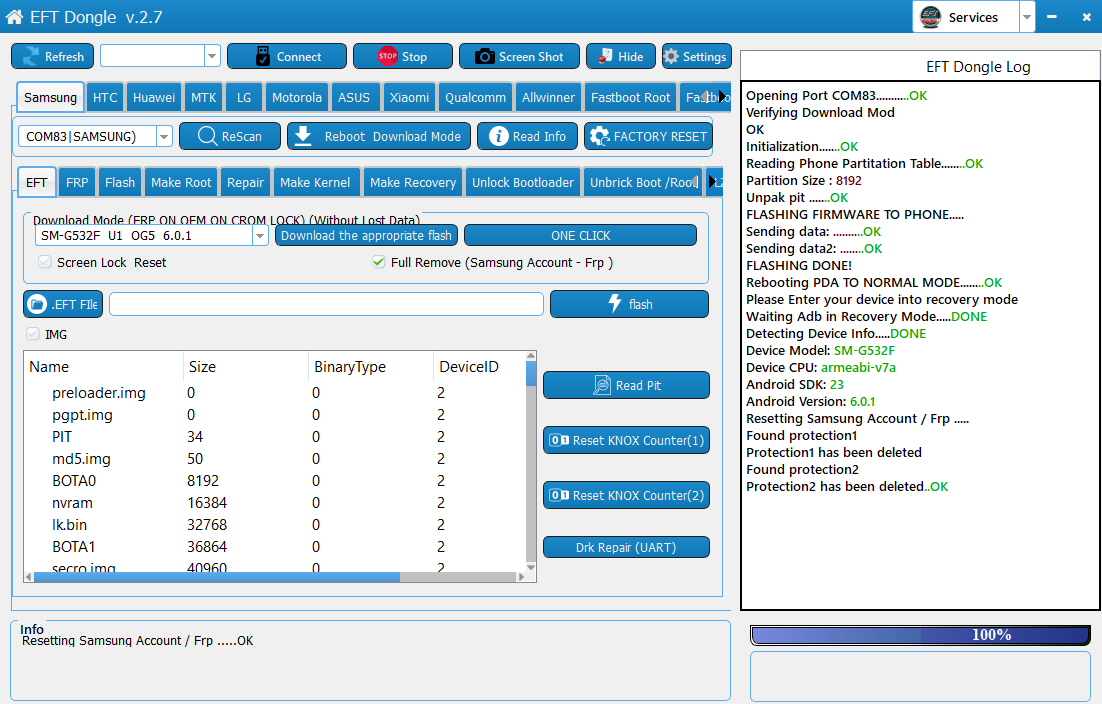

في حال علق الهاتف على اللوغو بعد العملية نقوم بتفليش الهاتف - طبعا رح نلاحظ ان FRP صار Off بوضع الداونلود
كود:
Opening Port COM83...........OKVerifying Download Mod
OK
Initialization.......OK
Reading Phone Partitation Table........OK
Partition Size : 8192
Unpak pit .......OK
FLASHING FIRMWARE TO PHONE.....
Sending data: ..........OK
Sending data2: ........OK
FLASHING DONE!
Rebooting PDA TO NORMAL MODE........OK
Please Enter your device into recovery mode
Waiting Adb in Recovery Mode.....DONE
Detecting Device Info.....DONE
Device Model: SM-G532F
Device CPU: armeabi-v7a
Android SDK: 23
Android Version: 6.0.1
Resetting Samsung Account / Frp .....
Found protection1
Protection1 has been deleted
Found protection2
Protection2 has been deleted..OK
إزالة قفل غوغل عن جهاز G532F بواسطة EFT Dongle بضغطة زر
