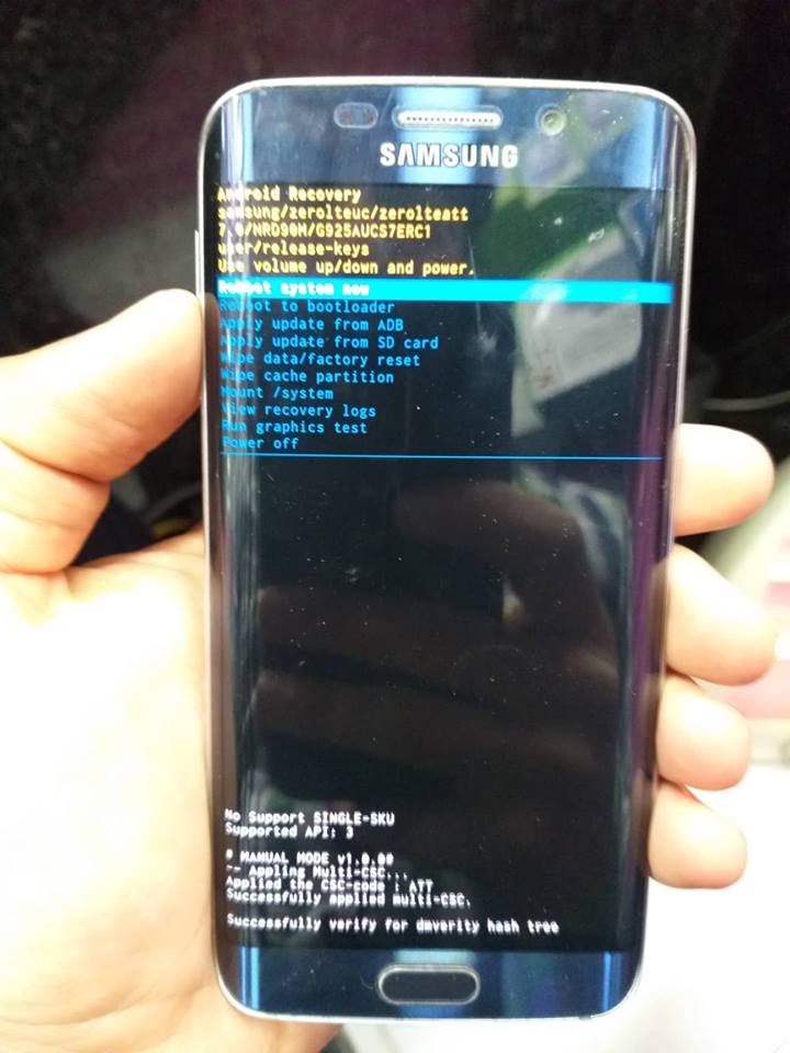

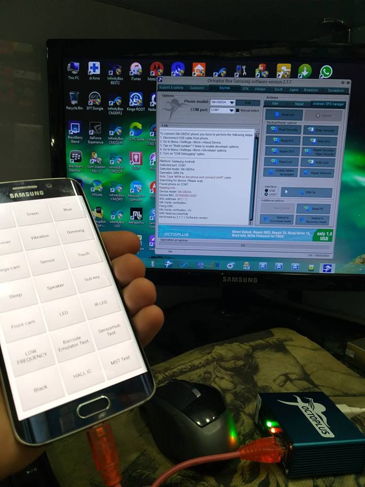

    تم وبحمد الله حل مشكلة DRK للجهاز G925A
    Android 7 حماية U7
    عن طريق كبل UART على OCTOPUS SAMSUNG
    هذه الصورة
    https://img.gem-flash.com/images/839...8731567970.jpg
    https://img.gem-flash.com/images/494...1156583665.jpg
    وهذا LOG العملية
    Welcome to Octoplus Box Samsung software version 2.7.7
    To connect SM-G925A phone you have to perform the following steps:
    1. Disconnect USB cable from phone.
    2. Go to Menu->Settings->More->About Device.
    3. Tap on "Build number" 7 times to enable developer options.
    4. Go to Menu->Settings->More->Developer options.
    5. Turn on "USB Debugging" option.
    Platform: Samsung Android
    Selected port: COM7
    Selected model: SM-G925A
    Operation: DRK Fix
    Note: Type *#0*# on the phone and connect UART cable.
    Searching for device. Please wait...
    Found phone on COM7
    Reading info...
    Device model: SM-G925A
    Device IMEI: 35794206010587
    MSL address: ‚‚أ،FC'‘~¨
    DM-Verity verification..
    Fixing DRK..
    DM-Verity verification..Ok!
    DRK fixed successfully
    Performed by 2.7.7.1 Software version.
