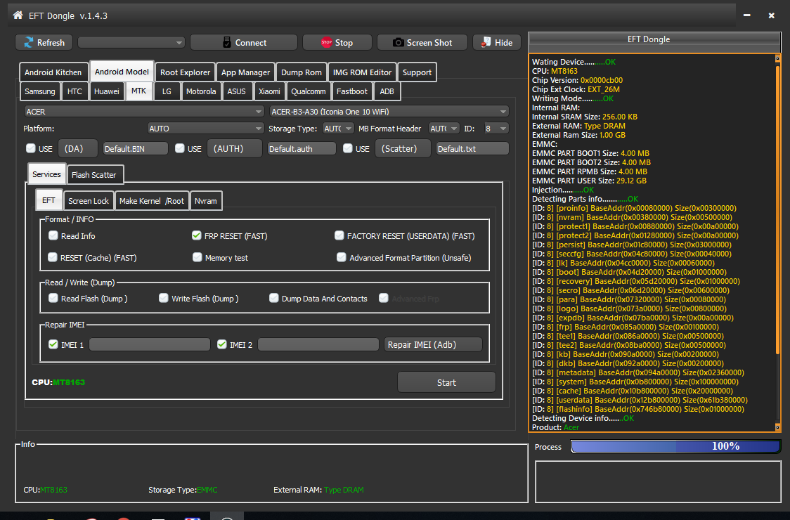

(منقول) ازالة قفل ال FRP لهاتف Acer B3-A30
Wating Device..........OK
CPU: MT8163
Chip Version: 0x0000cb00
Chip Ext Clock: EXT_26M
Writing Mode..........OK
Internal RAM:
Internal SRAM Size: 256.00 KB
External RAM: Type DRAM
External Ram Size: 1.00 GB
EMMC:
EMMC PART BOOT1 Size: 4.00 MB
EMMC PART BOOT2 Size: 4.00 MB
EMMC PART RPMB Size: 4.00 MB
EMMC PART USER Size: 29.12 GB
Injection..........OK
Detecting Parts info............OK
[ID: 8] [proinfo] BaseAddr(0x00080000) Size(0x00300000)
[ID: 8] [nvram] BaseAddr(0x00380000) Size(0x00500000)
[ID: 8] [protect1] BaseAddr(0x00880000) Size(0x00a00000)
[ID: 8] [protect2] BaseAddr(0x01280000) Size(0x00a00000)
[ID: 8] [persist] BaseAddr(0x01c80000) Size(0x03000000)
[ID: 8] [seccfg] BaseAddr(0x04c80000) Size(0x00040000)
[ID: 8] [lk] BaseAddr(0x04cc0000) Size(0x00060000)
[ID: 8] [boot] BaseAddr(0x04d20000) Size(0x01000000)
[ID: 8] [recovery] BaseAddr(0x05d20000) Size(0x01000000)
[ID: 8] [secro] BaseAddr(0x06d20000) Size(0x00600000)
[ID: 8] [para] BaseAddr(0x07320000) Size(0x00080000)
[ID: 8] [logo] BaseAddr(0x073a0000) Size(0x00800000)
[ID: 8] [expdb] BaseAddr(0x07ba0000) Size(0x00a00000)
[ID: 8] [frp] BaseAddr(0x085a0000) Size(0x00100000)
[ID: 8] [tee1] BaseAddr(0x086a0000) Size(0x00500000)
[ID: 8] [tee2] BaseAddr(0x08ba0000) Size(0x00500000)
[ID: 8] [kb] BaseAddr(0x090a0000) Size(0x00200000)
[ID: 8] [dkb] BaseAddr(0x092a0000) Size(0x00200000)
[ID: 8] [metadata] BaseAddr(0x094a0000) Size(0x02360000)
[ID: 8] [system] BaseAddr(0x0b800000) Size(0x100000000)
[ID: 8] [cache] BaseAddr(0x10b800000) Size(0x20000000)
[ID: 8] [userdata] BaseAddr(0x12b800000) Size(0x61b380000)
[ID: 8] [flashinfo] BaseAddr(0x746b80000) Size(0x01000000)
Detecting Device info.......OK
Product: Acer
Device Model: B3-A30
ID:
Sw Internal:
Build Date: Sat Oct 8 17:15:49 HKT 2016
Chip Ver: S01
Android Version: 6.0
Architecture: arm64-v8a
FRP RESET... [FRP] .....OK
All Done By EFT Dongle
