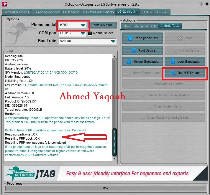

    اشارككم تجربة ازالة حساب قوقل لجهاز LG H790
    ع العملاق اكتوبلص غير مدعوم علي الزد
    كل ما عليك هو ادخال الجهاز وضع الداونلود مود بالضغط علي مفتاح رفع الصوت ثم توصيل كيبل الUSB
    ثم من واجهة البوكس نختار
    Reset FRP Lock
    49361111328348619111 thumb
    GEM-FLASH.COM Multi Uploader آ» Image Viewer
    [CODE]Checking data...OK
    Platform: LG Qualcomm
    Selected port: COM18
    Selected model: H790
    Please, put the phone into download mode manually (Power phone OFF, press and hold "Vol+" button and connect the cable).
    Reading info...
    IMEI: 353626-07
    Android version:
    Battery level: 20%
    SW Version: LGH790AT-00-V10f-NXS-XXX-OCT-0
    Mode: Emergency
    Initializing flash...OK
    SW version: LGH790AT-00-V10f-NXS-XXX-OCT-03-2015-32G-MDA89E-US
    Android version: 6.0
    LAF Version: 1.2
    Product ID: SM06S15
    IMEI: 353626-07
    Target operator: GOOGLE
    Hardware:
    After performing Reset FRP operation the phone may stuck on logo. To fix this problem You shall reflash the phone with the latest firmare.
    Perform Reset FRP operation at your own risk. Continue?
    Reading partitions...OK
    Resetting FRP Lock...OK
    Resetting FRP lock successfully completed!
    If the phone hang on logo or is restarting afetr performing the operation, please re-flash it using the same or higher version of firmware
    Performed by 2.8.3 Software version.
