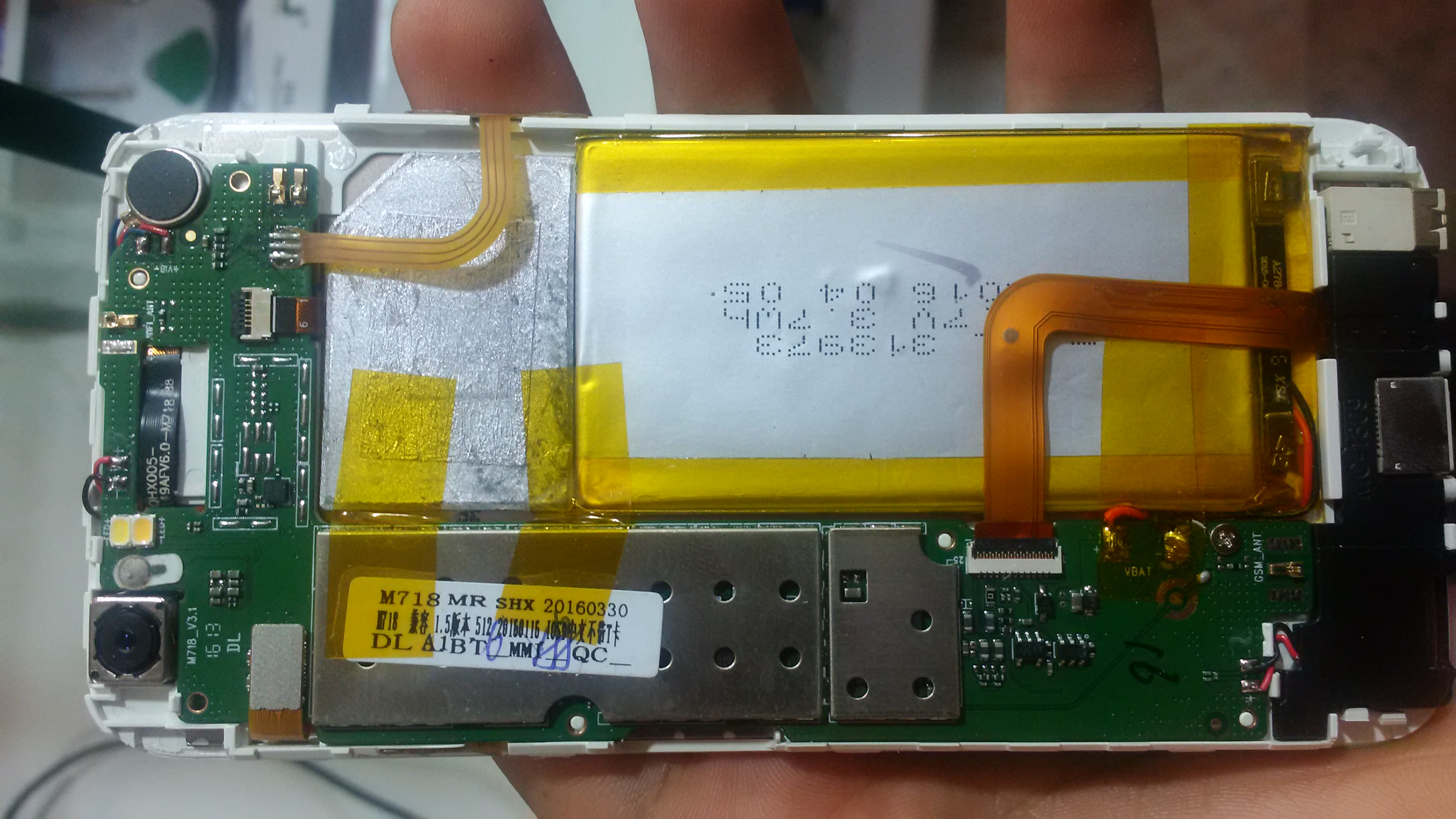

    Unhappy محتاج فلاشة iphone 6s mt6571
    need this rom
    iphone 6s
    mt6571
    [0]Part: PRELOADER Begin: 0x0 Len: 0x80000
    [1]Part: PRO_INFO Begin: 0x80000 Len: 0x100000
    [2]Part: NVRAM Begin: 0x180000 Len: 0x180000
    [3]Part: PROTECT_F Begin: 0x300000 Len: 0x180000
    [4]Part: SECCFG Begin: 0x480000 Len: 0x20000
    [5]Part: UBOOT Begin: 0x4a0000 Len: 0x80000
    [6]Part: BOOTIMG Begin: 0x520000 Len: 0x600000
    [7]Part: RECOVERY Begin: 0xb20000 Len: 0x600000
    [8]Part: SEC_RO Begin: 0x1120000 Len: 0x40000
    [9]Part: MISC Begin: 0x1160000 Len: 0x60000
    [10]Part: LOGO Begin: 0x11c0000 Len: 0x100000
    [11]Part: EXPDB Begin: 0x12c0000 Len: 0x200000
    [12]Part: ANDROID Begin: 0x14c0000 Len: 0x14f00000
    [13]Part: CACHE Begin: 0x163c0000 Len: 0x180000
    [14]Part: USRDATA Begin: 0x16540000 Len: 0x9080000
    [15]Part: BMTPOOL Begin: 0xffff0050 Len: 0x0
    Offset: 0x1f598000 Count: 16
    Warning, imei marker not found in nvram, nvram posible damaged
    Warning, nvram posible damaged!!
    If phone have damaged IMEI, write good nvram first.
    Partition table saved to: Android_MTK\partition_tables\
    Wait untill phone will start charging.
    All done.

    ما مشكلة جهاز

    اقتباس المشاركة الأصلية كتبت بواسطة ‏ASEM DANIAL مشاهدة المشاركة
    ما مشكلة جهاز
    شنق على شعار

    اعمل بكب اولا وجرب هاي
    GEM FLASH

    جرب الفلاشة
    جرب الفلاشة
    NAND: (4Gb+4096Mb) [Micron] MT29C4G96MAZAPCJA_5IT
    BOOT STYLE : NAND BOOT
    Size: 0x20000000 [0.500 GB]
    BlockSize: 2048 SpareSize: 64 BMT Blocks 80
    Detecting high speed port, wait......
    If driver not installed, install high speed port driver.
    If not need high speed port, disable it.
    After repeat opperation.
    Detected : DA USB VCOM Port (COM30)
    Warning, flashing preloader disabled!
    If you change android version, preloader must be flashed.
    Flash NAND Algo Start.
    Error FlashTool Download: S_STORAGE_NOT_MATCH
    All done.
    جرب الفلاشة
    فول فلاش
    Flash files count is :12
    Action : Firmware update.
    Selected 0-By CPU: MT6571_EMMC
    Exe version: NCKDongle AndroidMTK 2.5.6.2
    Scenario: Full Flash
    Reinsert phone battery.
    Battery must be charged.
    Phone must be off with battery inside.
    Please insert USB cable now...
    Detected : PreLoader USB VCOM Port (COM31)
    Phone detected...Please wait
    Sending DA agent, please wait...
    BaseBand CPU :MT6571_S00
    BaseBand CPU Secure Version : FF
    BaseBand CPU Bootloader Version : 01
    INT RAM: 128 KB SDRAM
    EXT RAM: 512 MB DRAM
    FORMAT NAND FLASH : BEGIN: 0x2d560000 - LEN: 0x8000000
    Error: Invalid begging and end addresses are given for read operation on Flash. Please check your start address and length again.
    Error: S_DA_INVALID_RANGE
    [EMPTY]WARNING ..format adress not detected!
    Warning: S_DA_INVALID_RANGE
    All done.

    ما هو وضع جهاز بعد تفليش

    تم حلها شكر
