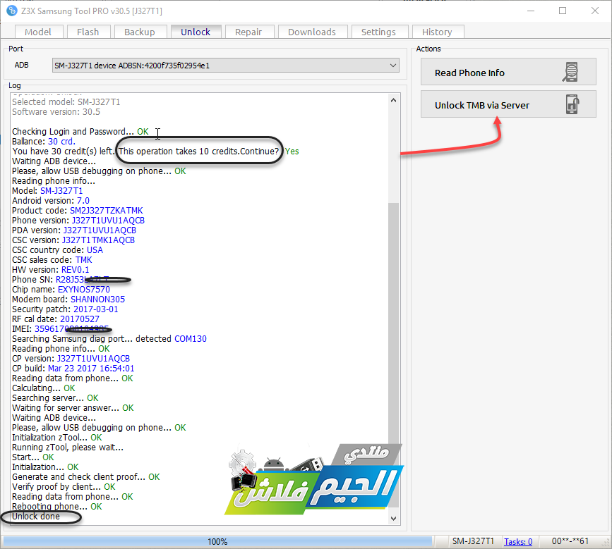

    افتراضي تجربة نحاجه لفك شفرة J327T1 T-Mobile عن طريق سيرفر الـ Z3x
    Unlock Done J327T1 Via ( Unlock TMB Via Server ) With Z3x Box
    تم سحب 10 كرديت لفك الجهاز
    لشراء الكرديت عن طريق الجيم فلاش سيرفر Server Service
    كود:
    Checking Login and Password... OKBallance: 30 crd.
    You have 30 credit(s) left. This operation takes 10 credits.Continue?  Yes
    Waiting ADB device...
    Please, allow USB debugging on phone... OK
    Reading phone info...
    Model: SM-J327T1
    Android version: 7.0
    Product code: SM2J327TZKATMK
    Phone version: J327T1UVU1AQCB
    PDA version: J327T1UVU1AQCB
    CSC version: J327T1TMK1AQCB
    CSC country code: USA
    CSC sales code: TMK
    HW version: REV0.1
    Phone SN: R28J5****
    Chip name: EXYNOS7570
    Modem board: SHANNON305
    Security patch: 2017-03-01
    RF cal date: 20170527
    IMEI: 359617080*****
    Searching Samsung diag port... detected COM130
    Reading phone info... OK
    CP version: J327T1UVU1AQCB
    CP build: Mar 23 2017 16:54:01
    Reading data from phone... OK
    Calculating... OK
    Searching server... OK
    Waiting for server answer... OK
    Initialization zTool... OK
    Running zTool, please wait...
    Start... OK
    Initialization... OK
    Generate and check client proof... OK
    Verify proof by client... OK
    Rebooting phone... OK
    Unlock done
    Done with Samsung Tool PRO v.30.5
