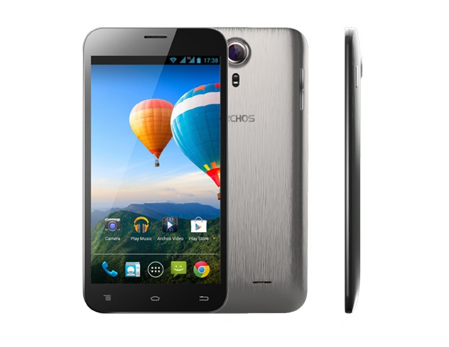

صوره الجهاز

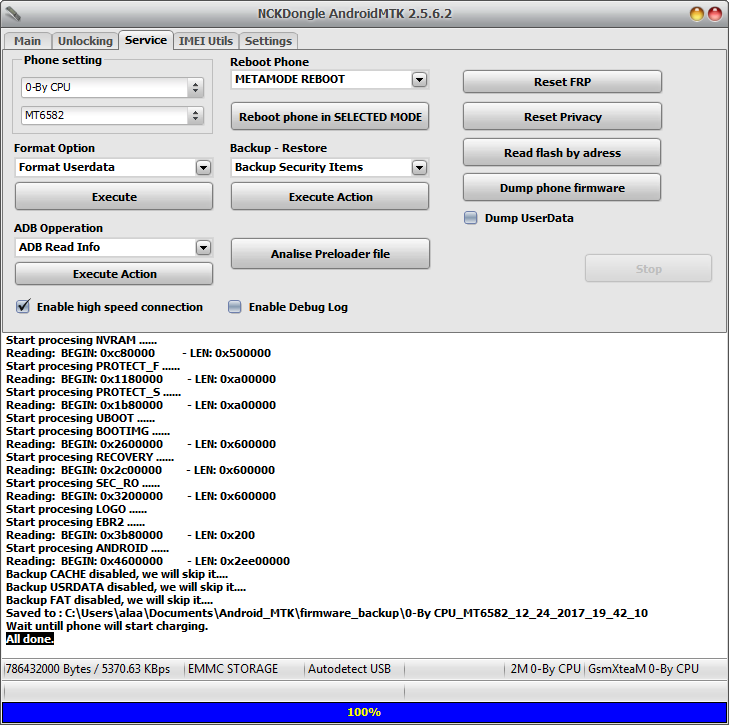

الانفو على الميراكل
Waiting for USB Port...
Set MTK USB Port (COM6)
Connected to Phone.
CPU: MT6582 SW:0001 Ver: CA01
Downloading Boot8 ...
EMMC Size: 0x00EC000000
Flash Type: EMMC
INT/EXT RAM Size: 0x0+0x0
Reading infr(EMMC)...
version:4.2.2
model:Archos 64 Xenon
brand:archos
manufacturer:archos
PRELOADER BaseAddr:0x0 Size:0x880000
MBR BaseAddr:0x880000 Size:0x80000
EBR1 BaseAddr:0x900000 Size:0x80000
PRO_INFO BaseAddr:0x980000 Size:0x300000
NVRAM BaseAddr:0xC80000 Size:0x500000
PROTECT_F BaseAddr:0x1180000 Size:0xA00000
PROTECT_S BaseAddr:0x1B80000 Size:0xA00000
SECCFG BaseAddr:0x2580000 Size:0x20000
UBOOT BaseAddr:0x25A0000 Size:0x60000
BOOTIMG BaseAddr:0x2600000 Size:0x600000
RECOVERY BaseAddr:0x2C00000 Size:0x600000
SEC_RO BaseAddr:0x3200000 Size:0x600000
MISC BaseAddr:0x3800000 Size:0x80000
LOGO BaseAddr:0x3880000 Size:0x300000
EBR2 BaseAddr:0x3B80000 Size:0x80000
EXPDB BaseAddr:0x3C00000 Size:0xA00000
ANDROID BaseAddr:0x4600000 Size:0x2EE00000
CACHE BaseAddr:0x33400000 Size:0x7E00000
USRDATA BaseAddr:0x3B200000 Size:0x40000000
FAT BaseAddr:0x7B200000 Size:0x6FF00000
>>Done.
صوره الانتهاء
