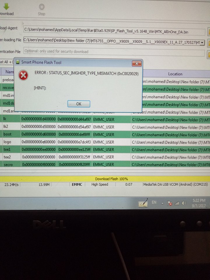

    ارفع صورة عن الخطا على برنامج الفلاش توول
    مشكور اخى الفاضل علي المساعده اول حاجه انا عندي جهزين واحد شغال تمام والتاني حصل المشكله دي وعند سحب الفلاشه من الجهاز اللي شغال تاجي الرساله دي
    مشكلف بعد السوفت oppo x9009
    ود الخطاا اللي بيظهر وانا بفليش علي sp flash

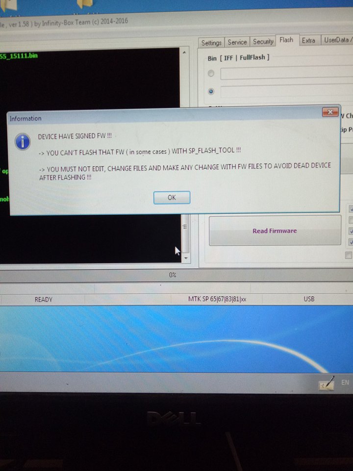

    بعد ما شيلت العلامه نفس المشكله
    Card found : S/N : D1F65F71 , v0134
    Chinese Miracle II [MTK module] v 1.58
    Scatter Load Ok , BaseBand : MT6755 , Project : oppo6755_15111 , Storage : EMMC
    Files found : 15 , Set to Flash : 14
    Created by Infinity-Box (c) Chinese Miracle II (c) 2016
    Device Brand : OPPO
    Device Model : X9009
    Device CPU : MT6755
    Device IntName : X9009
    Device Version : 5.1
    Device Compile : 5/27/2017 8:11:39 AM
    Device Project : X9009EX_11_A.27_170527
    Device ExtInfo : X9009
    Ready to Flash!
    Device Brand : OPPO
    Device CPU : MT6755
    Ready to Flash!
    Operation : Flash [ v1.58 ]
    ======= Flash
    1. Power Off Phone , Remove battery , Insert back
    2. Insert USB cable. In some cases require hold BootKey
    Wait for phone...
    Phone found! [ 214 ]
    Sync...
    Inital Boot Ok!
    BB_CPU_PID : 6755
    BB_CPU_NME : [MediaTek] Helio[P10]|MT6755_S00
    BB_CPU_EXT : 0xCB00 , 0x8A00 , 0x0000
    Processing BROM stage
    Settings for BROM configured!
    SecCfgVal : 0x01000000
    BromVer : 0x0005
    BLVersion : 0x00FE
    PreLoader : NOT Active [ Erased ]
    BootLdrSS : SIGNED with SPRELOADER
    Processing DA stage
    Sending and initialize DA ...
    DAgent configured successfully
    Connection agent : BROM
    DRAM configured from ScatFW!
    Link with DAgent established
    eMMC FlashIC initialized
    [eMMC] : FLASH_INF : [SAMSUNG] , BM41C
    [eMMC] : FLASH_CID : 150100524331344D420125C5C84F230B
    [eMMC] : FLASH_BRT : 0x00400000 , 0x00400000 , 0x00400000
    [eMMC] : FLASH_LEN : 0x0000000E8F800000
    [eMMC] : FLASH_UCP : 59640 MiB [eMMC 128 GiB]
    DEV RID : 0xA9A06B631C759C4FB5E0C908FE1FB198
    INT RAM : 0x00000000
    EXT RAM : 0x80000000 [2 GiB]
    [NAND] : FLASH : NOT INSTALLED
    [UFSM] : FLASH : NOT INSTALLED
    [HSUSB] : MODE : FULL-SPEED
    Boot Ok!
    ScatCFG : BaseBand : MT6755 , Project : oppo6755_15111 , Storage : EMMC
    Setting : Flash Pre-Erase (Safe) : Enabled
    Setting : AFF verify : Enabled
    Setting : HW verify : Disabled
    M67BL : Skip HW_COMPATIBILITY_CHECK by User request!
    Selected forced PMT update
    Build new PMT ...
    Update Primary ...
    Main PMT update failed!
    Operation Failed
    Elapsed: 00:00:30
    Reconnect Power/Cable!
