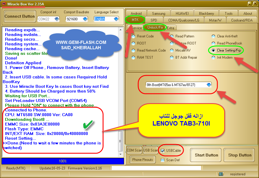

الموضوع: ازاله قفل جوجل للتاب لينوفو LENOVO TB3-710I_S000029_160318_ROW
    3354
    افتراضي ازاله قفل جوجل للتاب لينوفو LENOVO TB3-710I_S000029_160318_ROW
    تم بنجاح منقطع النظير
    ازاله قفل الجوجل
    FRB
    للتاب
    LENOVO TB3-710I
    علي الرهيب
    MIRACLE BOX
    لوج العمليه:
    انفو
    سحب الفلاشه للامان
    ازاله FRP
    كود:
     Welcome to use Miracle Box
     (World's First Fuzzy Logic Based Tool)
      Update:16-05-23
      Firmware Version:1.16

      Definition Applied
      Waiting for USB Port...
      Set PreLoader USB VCOM Port (COM54)
      Connected to Phone.
      CPU: MT6580 SW:0000 Ver: CA00
      Downloading Boot8 ...
      EMMC Size: 0x03A3E00000
      Flash Type: EMMC
      INT/EXT RAM  Size: 0x20000/0x40000000
      Reading infr(EMMC)...
      BT_ADDR:980CA5F05329
      WIFI MAC:980CA5F35329
      IMEI1:868981025070253
      IMEI2:FFFFFFFFFFFFFFF
      version:5.1
      model:Lenovo TB3-710I
      brand:Lenovo
      manufacturer:Lenovo
      PROINFO  BaseAddr:0x80000  Size:0x300000
      NVRAM  BaseAddr:0x380000  Size:0x500000
      PROTECT1  BaseAddr:0x880000  Size:0xA00000
      PROTECT2  BaseAddr:0x1280000  Size:0xA00000
      SECCFG  BaseAddr:0x1C80000  Size:0x40000
      LK  BaseAddr:0x1CC0000  Size:0x60000
      BOOT  BaseAddr:0x1D20000  Size:0x1000000
      RECOVERY  BaseAddr:0x2D20000  Size:0x1000000
      PARA  BaseAddr:0x3D20000  Size:0x80000
      LOGO  BaseAddr:0x3DA0000  Size:0x800000
      EXPDB  BaseAddr:0x45A0000  Size:0xA00000
      FRP  BaseAddr:0x4FA0000  Size:0x100000
      NVDATA  BaseAddr:0x50A0000  Size:0x2000000
      METADATA  BaseAddr:0x70A0000  Size:0x2760000
      OEMKEYSTORE  BaseAddr:0x9800000  Size:0x200000
      SECRO  BaseAddr:0x9A00000  Size:0x600000
      KEYSTORE  BaseAddr:0xA000000  Size:0x800000
      SYSTEM  BaseAddr:0xA800000  Size:0x77000000
      CACHE  BaseAddr:0x81800000  Size:0x10000000
      USERDATA  BaseAddr:0x91800000  Size:0x311580000
      FLASHINFO  BaseAddr:0x3A2D80000  Size:0x1000000
      Done.
      Definition Applied
      Connected to Phone.
      Flash Type: EMMC
      Reading preloader...
      Reading pgpt...
      Reading proinfo...
      Reading nvram...
      Reading protect1...
      Reading protect2...
      Reading lk...
      Reading boot...
      Reading recovery...
      Reading logo...
      Reading expdb...
      Reading nvdata...
      Reading secro...
      Reading system...
      Reading cache...
      Saving as scatter file...
      Done!
      Definition Applied
      Connected to Phone.
      Flash Type: EMMC
      Reset Setting...
    >>Done.(Need to wait a few minutes the phone is switched)
    صوره للواجهه
    جاري رفع الفلاشه
    وعمل موضوع مستقل
    دمتم بخير
