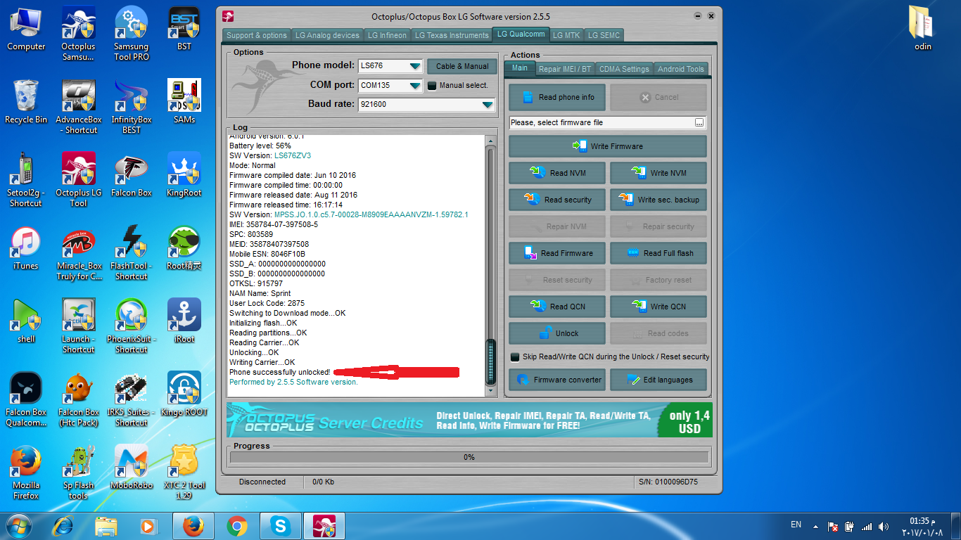

    تم بنجاح فك شفره lg ls676
    فعل وضع التطوير واختار الشحن فقط
    واتبع الارشادات من البوكس اثناءالعمليه لتفعيل وضع Diag
    وهذا لوغو العمليه
    Checking data...OK
    Platform: LG Qualcomm
    Selected port: COM135
    Selected model: LS676
    Reading info...Failed!
    Port busy
    Initializing ADB...OK
    Waiting for phone...OK
    Model ID: LGLS676
    Phone firmware version: LGLS676AT-00-ZV3-SPR-US-AUG-11-2016+00
    Kernel version: 3.10.49-g9c553a6 (lgmobile@LGEACI8R10) (gcc version 4.8 (GCC) ) #1 SMP PREEMPT Thu Aug 11 16:18:11 KST 201
    Android version: 6.0.1
    Hardware: Qualcomm Technologies, Inc MSM8909 0
    Please, type ##3424# to get SPC / MSL / Service Code...OK
    Input 803589, go to "Diag" menu and select "Enable" option.
    Found model LS676ZV3:?h `I at port COM221
    Reading info...
    Model ID: LGLS676
    IMEI: 358784-07-397508-5
    Battery level: 56%
    SW Version: LS676ZV3
    Mode: Normal
    Firmware compiled date: Jun 10 2016
    Firmware compiled time: 00:00:00
    Firmware released date: Aug 11 2016
    Firmware released time: 16:17:14
    SW Version: MPSS.JO.1.0.c5.7-00028-M8909EAAAANVZM-1.59782.1
    SPC: 803589
    MEID: 35878407397508
    Mobile ESN: 8046F10B
    SSD_A: 0000000000000000
    SSD_B: 0000000000000000
    OTKSL: 915797
    NAM Name: Sprint
    User Lock Code: 2875
    Switching to Download mode...OK
    Initializing flash...OK
    Reading partitions...OK
    Reading Carrier...OK
    Unlocking...OK
    Writing Carrier...OK
    Phone successfully unlocked!
    Performed by 2.5.5 Software version
