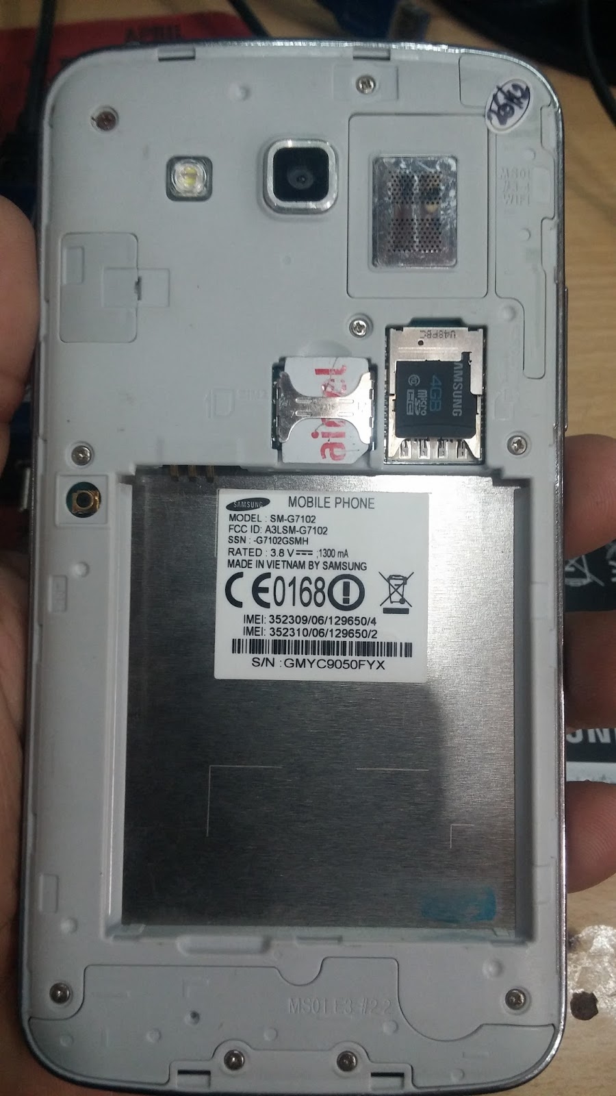

    صوره الهاتف

    الانفو علي بوكس الميراكل
    CPU: MT6582 SW:0001 Ver: CA01
    Downloading Boot8 ...
    EMMC Size:
    0x00E9000000
    Flash Type: EMMC
    Reading infr(EMMC)...
    BT_ADDR:0011E1E1F755
    WIFI MAC:0011E1E99870
    IMEI1:353867054258764
    IMEI2:353868054258762
    version:
    4.4.2
    model:
    SM-G7102
    brand:samsung
    manufacturer:Samsung
    BOOTIMG BaseAddr:0x2980000 Size:0x1000000
    RECOVERY BaseAddr:0x3980000 Size:0x1000000
    SEC_RO BaseAddr:0x4980000 Size:0x600000
    MISC BaseAddr:0x4F80000 Size:0x80000
    LOGO BaseAddr:0x5000000 Size:0x300000
    EBR2 BaseAddr:0x5300000 Size:0x80000
    EXPDB BaseAddr:0x5380000 Size:0xA00000
    ANDROID BaseAddr:0x5D80000 Size:0x48000000
    CACHE BaseAddr:0x4DD80000 Size:0x7E00000
    USRDATA BaseAddr:0x55B80000 Size:0x39C00000
    FAT BaseAddr:0x8F780000 Size:0x58C00000
    >>Done.
