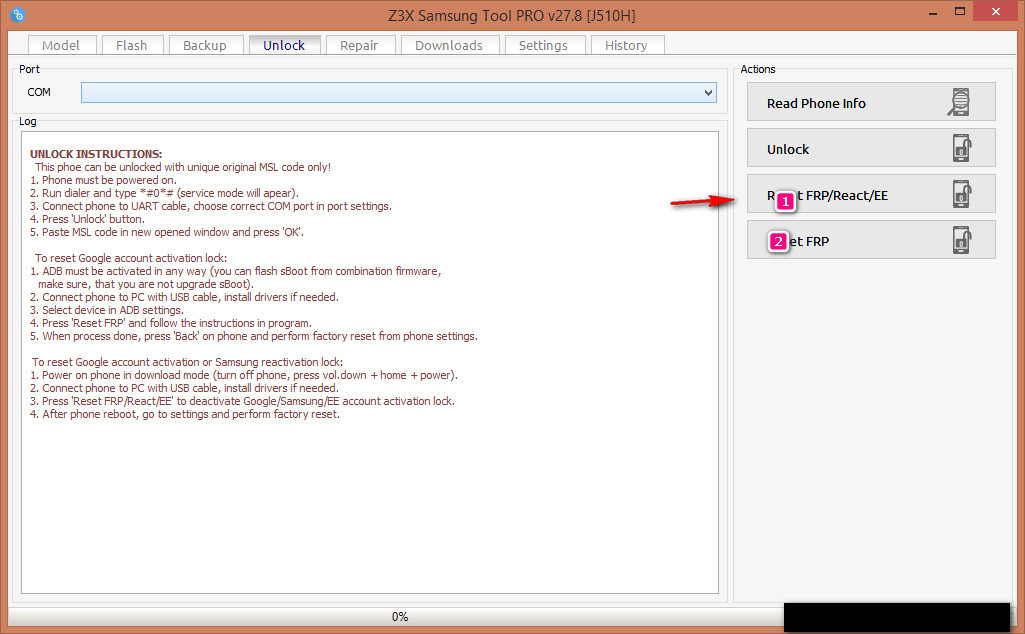

    الحمد لله فك قفل frp على العملاق z3x بنجاح
    انفو العملية
    كود:
    Operation: Reset FRP
    Selected model: SM-J510H
    Selected port:
    Software version: 27.8
    You must activate ADB before reset FRP  Yes
    Goto 'Terms and conditions' press 'NEXT' and 'AGREE' EULA  Yes
    Waiting ADB device... Ok
    Reading phone info...
    Model: SM-J510H
    Android version: 6.0.1
    Product code: SM-J510HZDDLYS
    Phone version: J510HXXU2APK6
    PDA version: J510HXXU2AQA3
    CSC version: J510HOJV2AQA3
    CSC country code: Libya
    CSC sales code: LYS
    HW version: MP 0.300
    Phone SN: RV1J1084GYY
    Chip name: MSM8216
    Modem board: MSM8916
    RF cal date: 2017.01.10
    IMEI:
    Bypass FRP... Ok
    For complete reset FRP, goto 'Backup and reset' and make 'Factory data reset'
    Done with Samsung Tool PRO v.27.8

    اسف شباب لم انتبه
    اولا عمل reset frp/react/ee
    والهاتف في وضع الداونلود بعدها شغل الهاتف وفعل وضع المطور واعمل Reset Frp
    frp  SM-J510H
