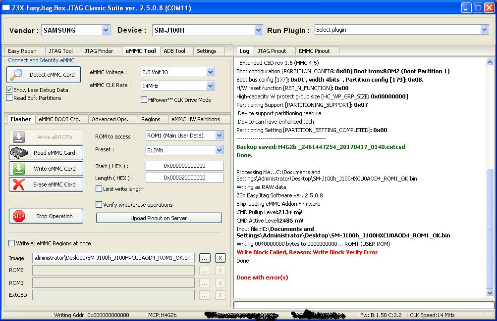

    افتراضي SM-J100H مشكله غريبه عند تمرير SM-J100h_J100HXCU0AOD4_ROM1
    الانفو
    Loading eMMC Addon Firmware... IO: 2800 mV
    Box S/N: 0700300B2D8069F5, ,FW Ver.: 01.58
    CMD Pullup Level:2134 mV
    CMD Active Level:2485 mV
    Box IO Level:2800 mV
    CLK Rate:14000 khz
    HiPower mode is off!
    ---------- eMMC Device Information ----------
    EMMC CID : 90014A4834473262110192B6B456527E
    EMMC CSD : D07F01320F5903FFFFFFFFEF8A4040DA
    EMMC Manufacturer ID: 0090 , OEM ID: 014A
    EMMC Date: 05/2015 Rev.0x1
    EMMC NAME: H4G2b , S/N: 2461447254
    EMMC NAME (HEX): 48344732622000
    EMMC ROM1 (Main User Data) Capacity: 3728 MB
    EMMC ROM2 (Boot Partition 1) Capacity: 4096 kB
    EMMC ROM3 (Boot Partition 2) Capacity: 4096 kB
    EMMC RPMB (Replay Protected Memory Block) Capacity: 4096 kB
    EMMC Permanent Write Protection: No
    EMMC Temporary Write Protection: No
    EMMC Password Locked: No
    Extended CSD rev 1.6 (MMC 4.5)
    Boot configuration [PARTITION_CONFIG: 0x08] Boot from:ROM2 (Boot Partition 1)
    Boot bus config [177]: 0x01 , width 4bits , Partition config [179]: 0x08.
    H/W reset function [RST_N_FUNCTION]: 0x00
    High-capacity W protect group size [HC_WP_GRP_SIZE: 0x00000000]
    Partitioning Support [PARTITIONING_SUPPORT]: 0x07
    Device support partitioning feature
    Device can have enhanced tech.
    Partitioning Setting [PARTITION_SETTING_COMPLETED]: 0x00
    Backup saved: H4G2b _2461447254_20170417_0140.extcsd
    Done.
    Processing file...C:\********s and Settings\Administrator\Desktop\SM-J100h_J100HXCU0AOD4_ROM1_OK.bin
    Writing as RAW data
    Z3X EasyJtag Software ver. 2.5.0.8
    Skip loading eMMC Addon Firmware
    Input file : C:\********s and Settings\Administrator\Desktop\SM-J100h_J100HXCU0AOD4_ROM1_OK.bin
    Writing 0040000000 bytes to 0000000000... ROM1 (USER ROM)
    Write Block Failed, Reason: Write Block Verify Error
    Done.
    Done with error(s)

    اخي حول تغير الفوت من خانة
    eMMc Vcltage
  5. الشَكر rabiegsm شَكر
  6. #3
    Feb 2016
    اخي الكريم اول شي انا بعرف ملف الدامب حجمو 1GB وانت محدد 512mb يعني لازم تحط 1GB تاني شي وعن تجربة مع هاد الجهاز العنيد لازم تحط ملف الدامب بخانةROM2 وبعدين تحدد معو ملف ext cd يلي عملتلو البوكس باكب وبعدين بتعطي امر الكتابة على الهارد ونشالله بيمشي الحال وبالنهاية اذا ما تمت العملية توجه لواجهة easy jtag plus وحدد ملف pit وبعدين فلاشة رسمية وعطي امر التفليش على الهارد فورا وهيك بتنحل المشكلة اكيد

    اخي هل الجهاز فاصل بوت؟
  9. الشَكر mohanad244 شَكر
  10. #5
    Feb 2016
    اي تمام اخي انا عم اعطيك حل مشكلة البوت ..فوت على واجهة easy jtag plus وفلش على الهار دايركت مع ملفpit ونشالله بتنحل مشكلتك
