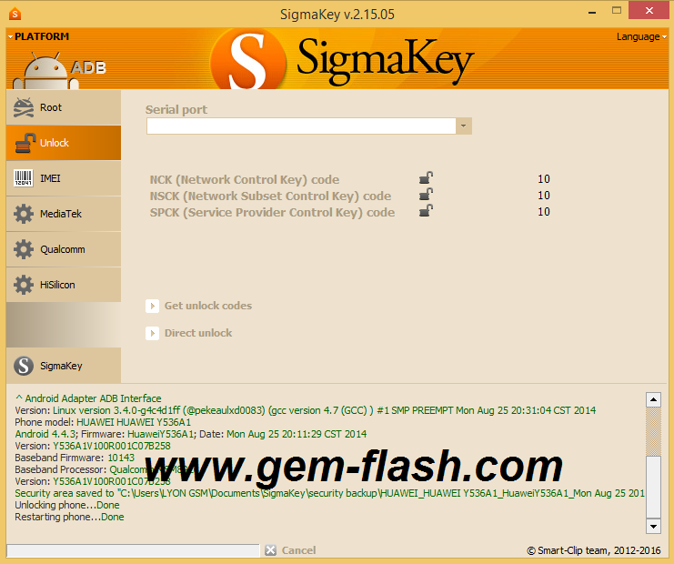

    لقد تم فك الشفرة بنجاح
    على السيجما بنجاح
    بعد ترويت الجهاز ببرنامج kingo root
    يتم اختيار Anroid ADB
    وبعدها حدد كوم الجهاز
    ثم اضغط Direct unlock
    كود:
    --------- 2016-03-26 15:53:54 ---------
    SigmaKey 2.15.05 ADB: Direct unlock
    * daemon not running. starting it now *
    * daemon started successfully *
    ^ Android Adapter ADB Interface
    Version: Linux version 3.4.0-g4c4d1ff (@pekeaulxd0083) (gcc version 4.7 (GCC) ) #1 SMP PREEMPT Mon Aug 25 20:31:04 CST 2014
    Phone model: HUAWEI HUAWEI Y536A1
    Android 4.4.3; Firmware: HuaweiY536A1; Date: Mon Aug 25 20:11:29 CST 2014
    Version: Y536A1V100R001C07B258
    Baseband Firmware: 10143
    Baseband Processor: Qualcomm MSM8926
    Security area saved to "C:\Users\LYON GSM\********s\SigmaKey\security backup\HUAWEI_HUAWEI Y536A1_HuaweiY536A1_Mon Aug 25 201129 CST 2014.skb"
    Unlocking phone...Done
    Restarting phone...Done
    تم فك شفرة هواوي Y536A1
