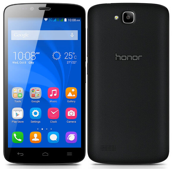

    الجهاز دا جاى ملغم فيروسات تمت المعالجة والحذف على الانفينتى بس اول مافتحت الواى فاى عينك ماتشوف الا النور تطبيقات وفيروسات على السريع طبعا مافيش قدامى غير التفليش رزعتو الفلاشة وبالشفا كلة تمام الفيروسات بح :D
    انفوا الجهاز قبل التفليش
    كود:
    Wait for phone...
    Phone found! [ 38 ]
    Sync...
    Inital Boot Ok!
    BB_CPU_PID : 6582
    BB_CPU_NME : [MediaTek] MT6582_S00
    BB_CPU_EXT : 0xCA01 , 0x8A00 , 0x0000
    Processing BROM stage
    Settings for BROM configured!
    SecCfgVal : 0x00000000
    BromVer   : 0x00FF
    BLVersion : 0x0001
    BootLdrSS : NORMAL with SPRELOADER
    Processing DA stage
    DA Select done, will use MTK_AllInOne_DA_v5.1620.10.01
    Sending and initialize DA ...
    Running DA ver.4.2 on BBID : 0x87
    NAND Flash : NOT INSTALLED
    eMMC Flash : 1501004B3858564D42067849DEE25249
    Initialize Memory ...
    DAgent sent , init HW now
    eMMC FlashIC initialized
    [eMMC] : FLASH_INF : [SAMSUNG] , BMVX8
    [eMMC] : FLASH_CID : 1501004B3858564D42067849DEE25249
    [eMMC] : FLASH_BRT : 0x00400000 , 0x00400000 , 0x00400000
    [eMMC] : FLASH_LEN : 0x00000003A3E00000
    [eMMC] : FLASH_UCP : 14910 MiB [eMMC 16 GiB]
    DEV RID    : 0xCF15537D7653A67DADC21EC01A8FE446
    INT RAM    : 0x00020000
    EXT RAM    : 0x40000000 [1 GiB]
    BOOT TYPE  : EMMC_FLASH_BOOT
    SOC VERIFY : C1
    Boot Ok!
    [AP] : Initial info read Ok!
    Brand     : HUAWEI
    ProdName  : Hol-U19
    ProdModel : Hol-U19
    Device    : HWHol-U
    AndroidVer: 4.4.2
    MTKxCPU   : MT6582
    MTKxPRJ   : Holly-U19V100R001C328B110_A
    MODEM :
    BaseBand  : MT6582_S00_MOLY_WR8_W1315_MD_WG_MP_V51_1_wg_n
    EXTRA :
    LCD [0] : hx8394a_hd720_xinli_at803
    LCD [1] : nt35521_hd720_dsi_vdo_dijing
    LCD [2] : hx8394d_hd720_dsi_vdo_dijing
    LCD [3] : otm1283a_hd720_dsi_vdo_trust
    LCD [4] : dummy_lcm
    LCD Res : 1280x720
    TOUCH [0] : GT9XXS
    CAM [0] : s5k4h5yx_mipi_raw
    CAM [1] : ov8858_mipi_raw
    CAM [2] : gc2235_mipi_raw
    CAM [3] : hi258_mipi_yuv
    CAM [4] : hi258_mipi_yuv_shengtai
    CAM [5] : #gc0329_yuv
    MODEM : huaqin82_wet_b2b_kk_hspa_900_2100
    LOCALE : en_US ru_RU zh_CN ar_EG fa_IR fr_FR hi_IN pt_PT de_DE es_ES el_GR
    Done!
