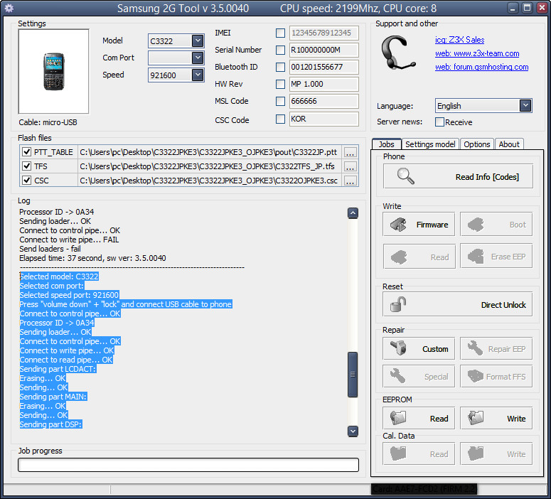

تفليش جهاز GT-C3322 على Z3X بنجاح

لادخال الهاتف لوضع الداونلود الضغط على زر الهوم
كود:
Selected model: C3322
كود:
Selected com port:
Selected speed port: 921600
Press "volume down" + "lock" and connect USB cable to phone
Connect to control pipe... OK
Processor ID -> 0A34
Sending loader... OK
Connect to write pipe... OK
Connect to read pipe... OK
Sending part LCDACT:
Erasing... OK
Sending... OK
Sending part MAIN:
Erasing... OK
Sending... OK
Sending part DSP:
Erasing... OK
Sending... OK
Sending part ROOT:
Erasing... OK
Sending... OK
Sending boot sector:
Erasing... OK
Sending... OK
Sending TFS... OK
Sending CSC... OK
Download - ok
Elapsed time: 437 second, sw ver: 3.5.0040
