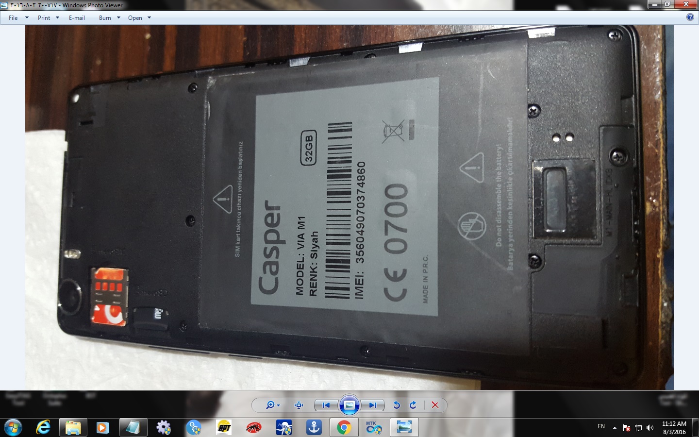

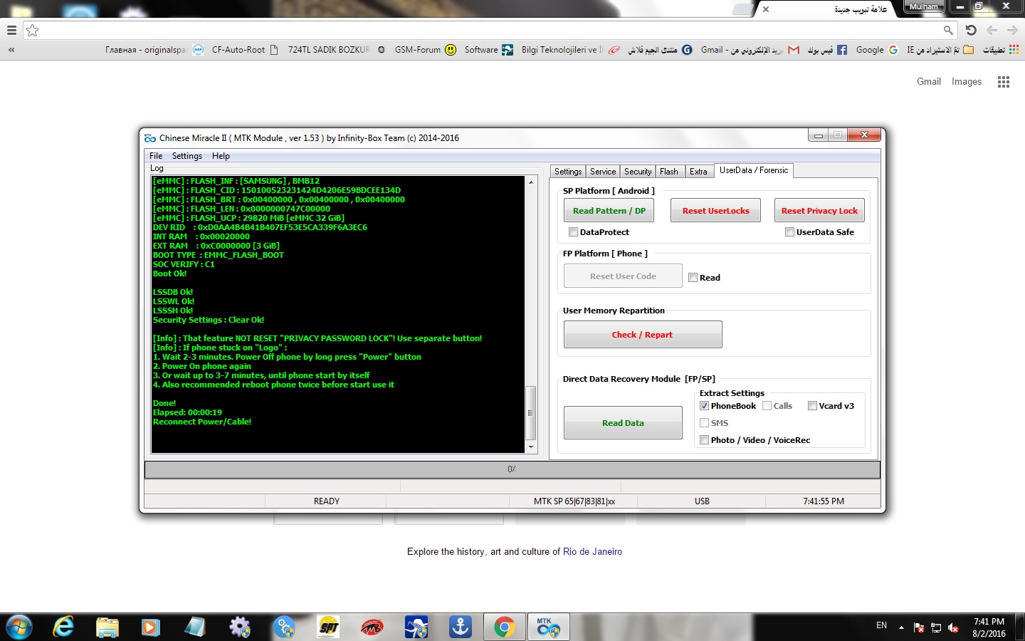

    تم بعون الله فك جوجل اكونت لهاتف CASPER VIA M1 على العملاق الانفنتي
    الهاتف معالجه MT 6735
    حصريا فك جوجل اكونت لهاتف CASPER  VIA M1  على العملاق وهذه صورة العملية
    الهاتف بعد العملية طول لاشتغل متخفش ده طبيعي وهذا لوغ العملية

    Operation : Clear UserLocks [Pin/Pwd/Pattern/FVLock/GoogleAcc] [ v1.53 ]
    1. Power Off Phone , Remove battery , Insert back
    2. Insert USB cable. In some cases require hold BootKey
    Wait for phone...
    Phone found! [ 13 ]
    Sync...
    Inital Boot Ok!
    BB_CPU_PID : 6735
    BB_CPU_NME : [MediaTek] MT6735_S00
    BB_CPU_EXT : 0xCA00 , 0x8A00 , 0x0000
    Processing BROM stage
    Settings for BROM configured!
    SecCfgVal : 0x00000000
    BromVer   : 0x00FF
    BLVersion : 0x0001
    BootLdrSS : NORMAL with SPRELOADER
    Processing DA stage
    Sending and initialize DA ...
    Running DA ver.4.2 on BBID : 0x93
    NAND Flash : NOT INSTALLED
    eMMC Flash : 520001154D4231329BE506424D3BEEDC
    Initialize Memory ...
    DAgent sent , init HW now
    eMMC FlashIC initialized
    [eMMC] : FLASH_INF : [SAMSUNG] , BMB12
    [eMMC] : FLASH_CID : 150100523231424D4206E59BDCEE134D
    [eMMC] : FLASH_BRT : 0x00400000 , 0x00400000 , 0x00400000
    [eMMC] : FLASH_LEN : 0x0000000747C00000
    [eMMC] : FLASH_UCP : 29820 MiB [eMMC 32 GiB]
    DEV RID    : 0xD0AA4B4B41B407EF53E5CA339F6A3EC6
    INT RAM    : 0x00020000
    EXT RAM    : 0xC0000000 [3 GiB]
    BOOT TYPE  : EMMC_FLASH_BOOT
    SOC VERIFY : C1
    Boot Ok!
    LSSDB Ok!
    LSSWL Ok!
    LSSSH Ok!
    Security Settings : Clear Ok!
    [Info] : That feature NOT RESET "PRIVACY PASSWORD LOCK"! Use separate button!
    [Info] : If phone stuck on "Logo" :
    1. Wait 2-3 minutes. Power Off phone by long press "Power" button
    2. Power On phone again
    3. Or wait up to 3-7 minutes, until phone start by itself
    4. Also recommended reboot phone twice before start use it
    Done!
    Elapsed: 00:00:19
    Reconnect Power/Cable!
