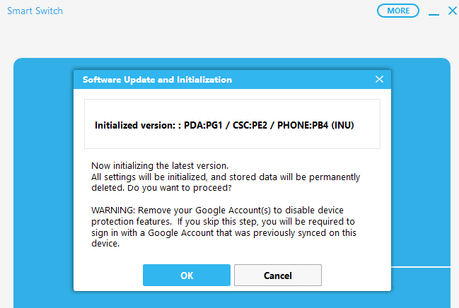

    .To Know your mobile Region
    2.1: Download Smart switch in you Pc
    2.3:Select Emergency Software Recovery And Initialization
    2.4:Go to Device Initialization
    2.5:Type your model number Ex- SM-N910G and search
    2.6:Enter the Serial Number of your Device
    2.7:There you can see your Device Region
