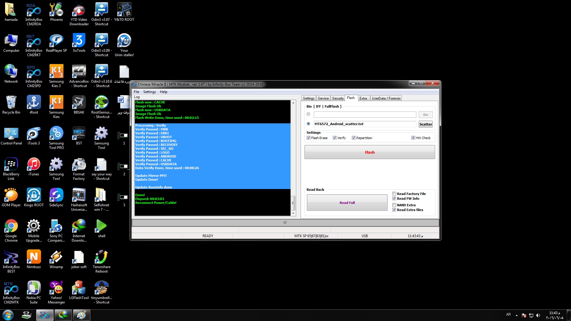

تفليش وتعريب Hisense u939e_5 بنجاح على الدونجل الرائع انفينتى واصلاح سريال الهاتف

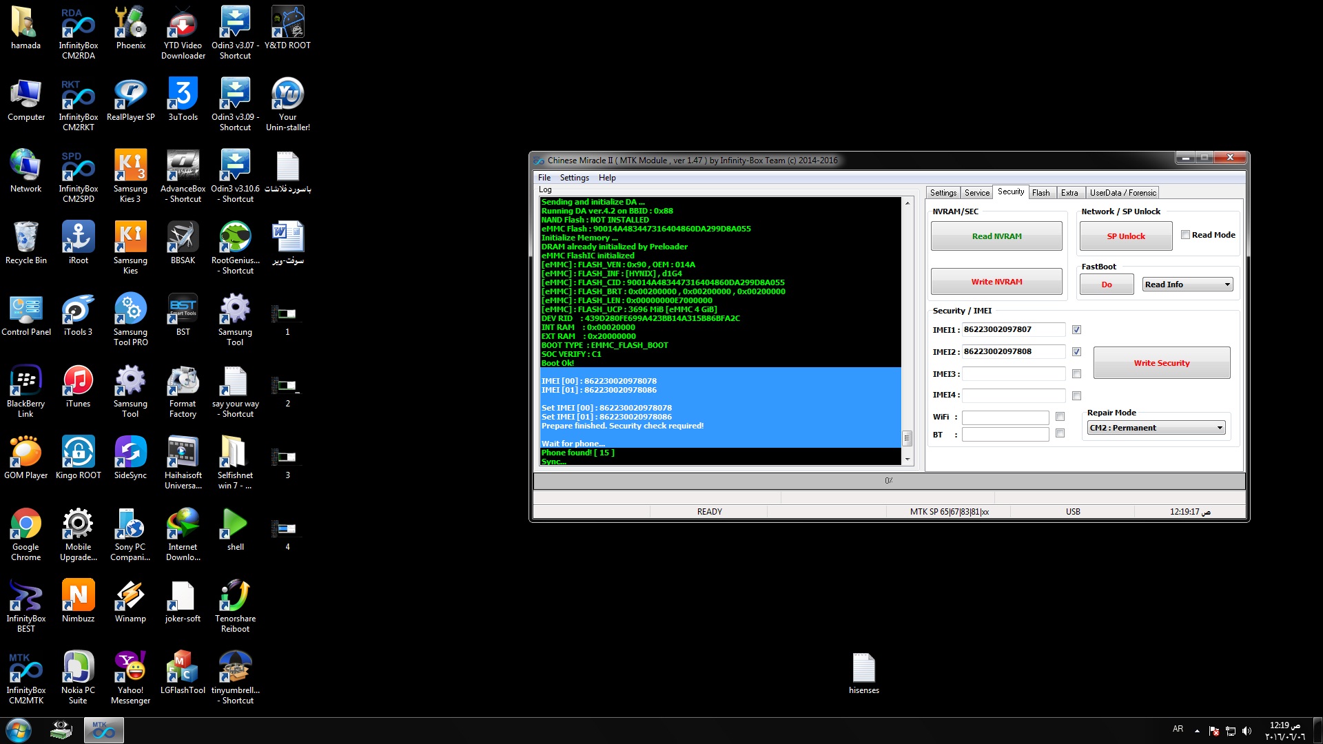

انفو الجهازكود:Operation : Check / Read Info [ v1.48 ] 1. Power Off Phone , Remove battery , Insert back 2. Insert USB cable. In some cases require hold BootKey Wait for phone... Phone found! [ 38 ] Sync... Inital Boot Ok! BB_CPU_PID : 6572 BB_CPU_NME : [MediaTek] MT6572_S00 BB_CPU_EXT : 0xCA01 , 0x8A00 , 0x0000 Processing BROM stage Settings for BROM configured! SecCfgVal : 0x00000000 BromVer : 0x00FF BLVersion : 0x0001 PreLoader : Active [ Boot with PL ] BootLdrSS : NORMAL with SPRELOADER Processing DA stage DA Select done, will use MTK_AllInOne_DA_v5.1616.01.01 Sending and initialize DA ... Running DA ver.4.2 on BBID : 0x88 NAND Flash : NOT INSTALLED eMMC Flash : 90014A483447316404860DA299D8A055 Initialize Memory ... DRAM already initialized by Preloader DAgent sent , init HW now eMMC FlashIC initialized [eMMC] : FLASH_VEN : 0x90 , OEM : 014A [eMMC] : FLASH_INF : [HYNIX] , d1G4 [eMMC] : FLASH_CID : 90014A483447316404860DA299D8A055 [eMMC] : FLASH_BRT : 0x00200000 , 0x00200000 , 0x00200000 [eMMC] : FLASH_LEN : 0x00000000E7000000 [eMMC] : FLASH_UCP : 3696 MiB [eMMC 4 GiB] DEV RID : 0xB86BFA2C439D280FE699A423BB14A315 INT RAM : 0x00020000 EXT RAM : 0x20000000 BOOT TYPE : EMMC_FLASH_BOOT SOC VERIFY : C1 Boot Ok! [AP] : Initial info read Ok! Brand : Hisense ProdName : u939e_5 ProdModel : HS-U939 Device : u939e_5 AndroidVer: 4.2.2 MTKxCPU : MT6572 MTKxPRJ : W864.6.03.00.EG00 EXTRA : LCD [0] : otm8018b_fwvga_vdo_booyi_hs LCD [1] : nt35512_fwvga_vdo_tm_hs LCD [2] : hx8379a_fwvga_vdo_truly_hs LCD Res : 854x480 TOUCH [0] : ft6206 CAM [0] : ov5645_mipi_yuv CAM [1] : sp0a28_yuv MODEM : hisense72_we_jb3_hspa_eg_newmodem LOCALE : en_US ru_RU ar_EG fr_FR hi_IN zh_CN fa_IR pt_PT hdpi Done! Elapsed: 00:00:16 Reconnect Power/Cable!

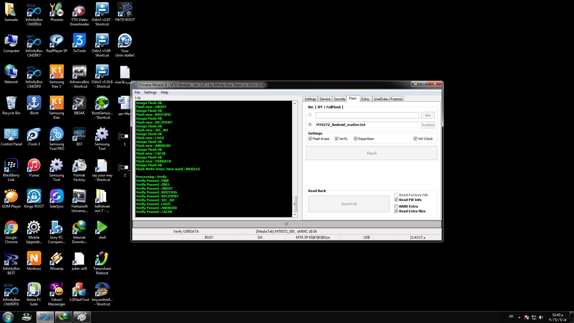

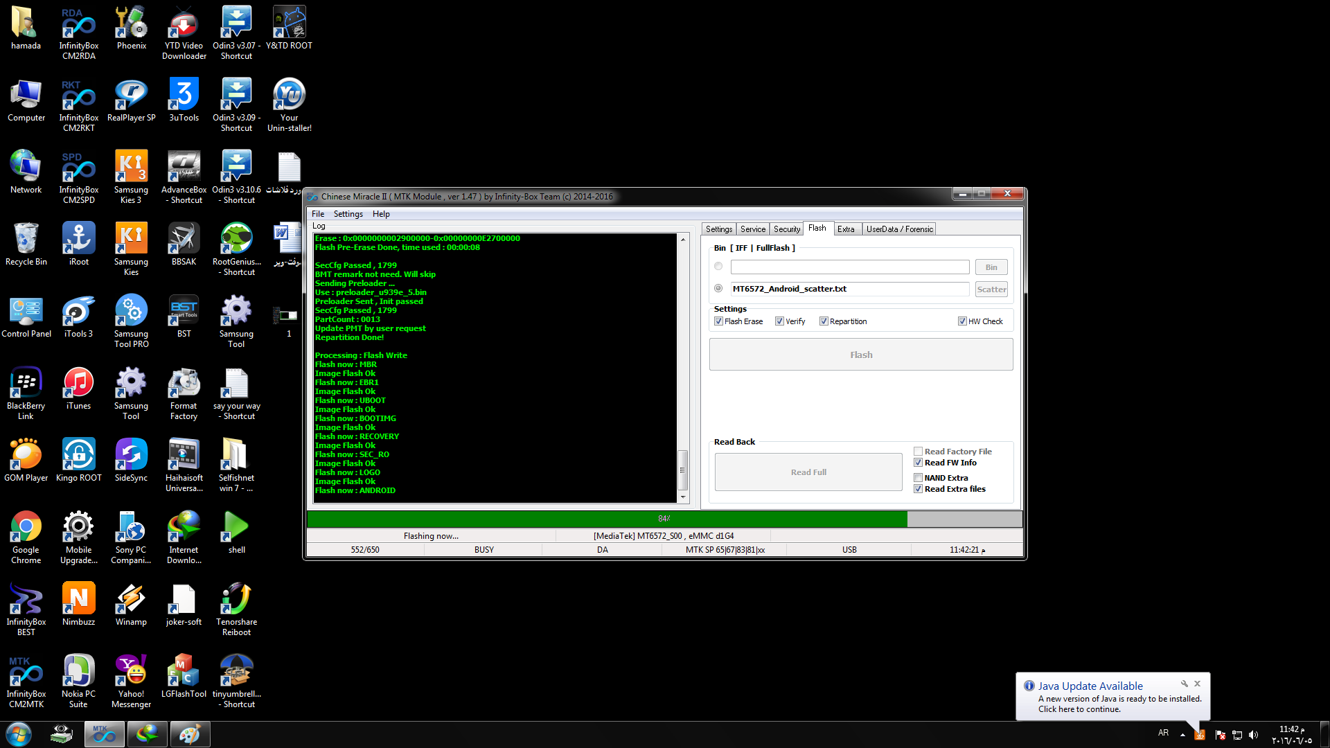

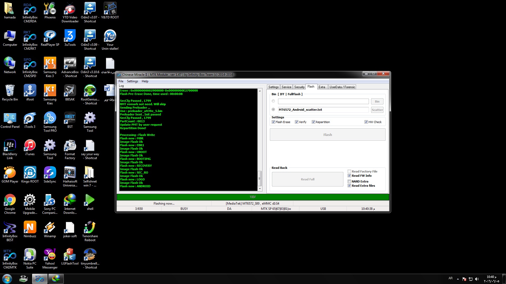

مشكلة الهاتف كان واقف على الافتتاحية عملت فورمات من ريكفرى وعلى الدونجل وفضل نفس المشكلة تم التفليش بهذة الفلاشة من منتدانا الغالى
فلاشة حصريا hisense u939e_5 - الصفحة 1
بعد التفليش وجدت الهاتف ضرب ايمى وتم الاصلاح ايضا على الدونجل الرائع
