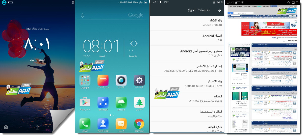

    Inital Boot Ok! BB_CPU_PID : 6752 BB_CPU_NME : [MediaTek] MT6732|MT6752_S00 BB_CPU_EXT : 0xCA01 , 0x8A00 , 0x0000 Processing BROM stage Settings for BROM configured! SecCfgVal : 0x00000000 BromVer : 0x00FF BLVersion : 0x0001 PreLoader : Active [ Boot with PL ] BootLdrSS : NORMAL with SPRELOADER Processing DA stage DA Select done, will use MTK_AllInOne_DA_v5.1612.01.01 Sending and initialize DA ... Running DA ver.4.2 on BBID : 0x8F NAND Flash : NOT INSTALLED eMMC Flash : 150100523832314D420009C6C607625B Initialize Memory ... DRAM already initialized by Preloader eMMC FlashIC initialized [eMMC] : FLASH_VEN : 0x15 , OEM : 0100 [eMMC] : FLASH_INF : [SAMSUNG] , BM128 [eMMC] : FLASH_CID : 150100523832314D420009C6C607625B [eMMC] : FLASH_BRT : 0x00400000 , 0x00400000 , 0x00400000 [eMMC] : FLASH_LEN : 0x00000003A3E00000 [eMMC] : FLASH_UCP : 14910 MiB [eMMC 16 GiB] DEV RID : 5B762F1AB9E64734BB70EFA3D144577D INT RAM : 0x00020000 EXT RAM : 0x80000000 BOOT TYPE : EMMC_FLASH_BOOT SOC VERIFY : C1 Boot Ok! [AP] : Initial info read Ok! Brand : Lenovo ProdName : aio_otfp ProdModel : Lenovo K50a40 Device : K50a40 AndroidVer: 6.0 MTKxCPU : MT6752 MTKxPRJ : K50a40_USR_S322_1603142105_mp1V2.39_ROW SECURITY : IMEI_SW [1] : 867970027244017 IMEI_SW [2] : 867970027244025 BTMAC Addr : A032990E86DE WiFi MAC : A032991F86DE MODEM : BaseBand : MT6752_S00_AIO_5M_ROW_LTG_M_V10_1_ltg_n EXTRA : LCD : Not info available :( LCD Res : 1920x1080 TOUCH [0] : GT9XX_hotknot CAM [0] : ov13850sunny_mipi_raw CAM [1] : ov13850ofilma50_mipi_raw CAM [2] : ov5670_mipi_raw CAM [3] : ov5670lite_mipi_raw MODEM : STOM_MODEM=mt6752_k52_md1_lwg_dsds_combo_mp7_custom mt6752_k52_md1_lttg_dsds_combo_mp7_custom LOCALE : en_US zh_CN zh_TW es_ES pt_BR ru_RU fr_FR de_DE tr_TR vi_VN ms_MY in_ID th_TH it_IT ar_EG hi_IN bn_IN ur_PK fa_IR pt_PT nl_NL el_GR hu_HU tl_PH ro_RO cs_CZ ko_KR km_KH iw_IL my_MM pl_PL es_US bg_BG hr_HR lv_LV lt_LT sk_SK uk_UA de_AT da_DK fi_FI nb_NO sv_SE en_GB hy_AM zh_HK et_EE ja_JP kk_KZ sr_RS sl_SI ca_ES

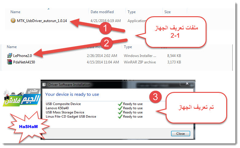

    اولا : تعريفات الموبايل حتى يتم العمل بشكل سليم .
    هذه التعريفات او الدرايفر لأغلب اجهزه MTK وخاصة أجهزة لينوفو
    فلاشة عربية نادره مارشميلو Android Marshmallow6 Lenovo K3 Note K50a40
    Lenovo_USB+pdanet_Drivers & MTK_UsbDriver_autorun_1.0.14

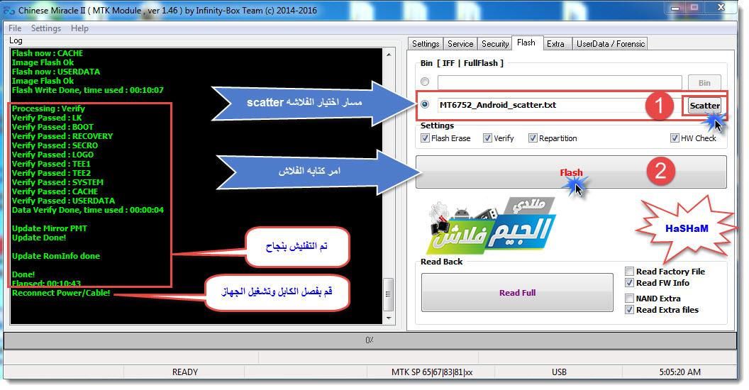

    ثانياً : فتح برنامج CM2MTK ونتابع الشرح المصور ....
    الموبايل مغلق نوصله بال USB ثم نقوم بالضغط 3 ثواني على ال POWER

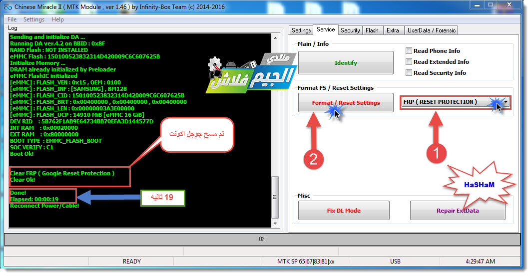

    هنا مسح جوجل اكونت FRP

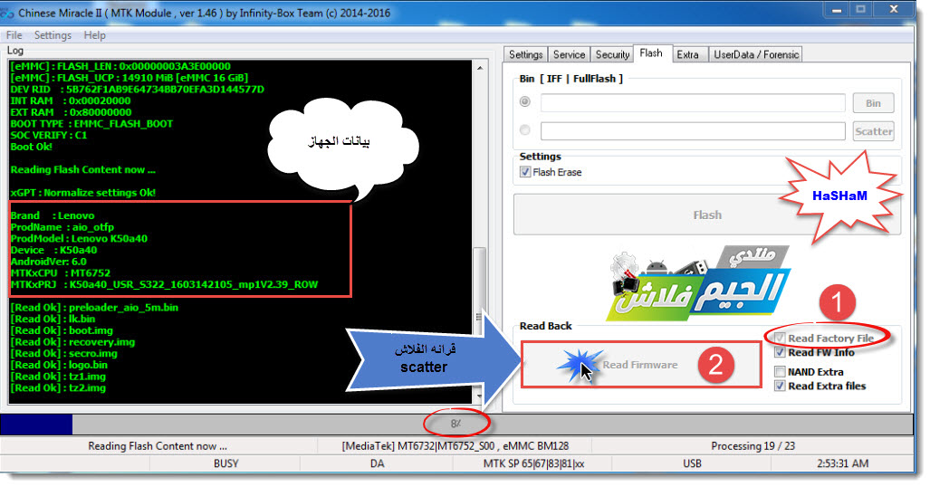

    هنا مرحلة نسخ الروم من الموبايل بصيغة اسكاتر.

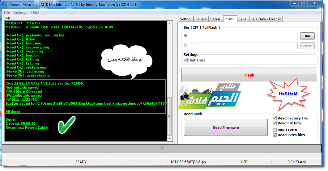

    الانتهاء من عمل نسخه اسكاتر.

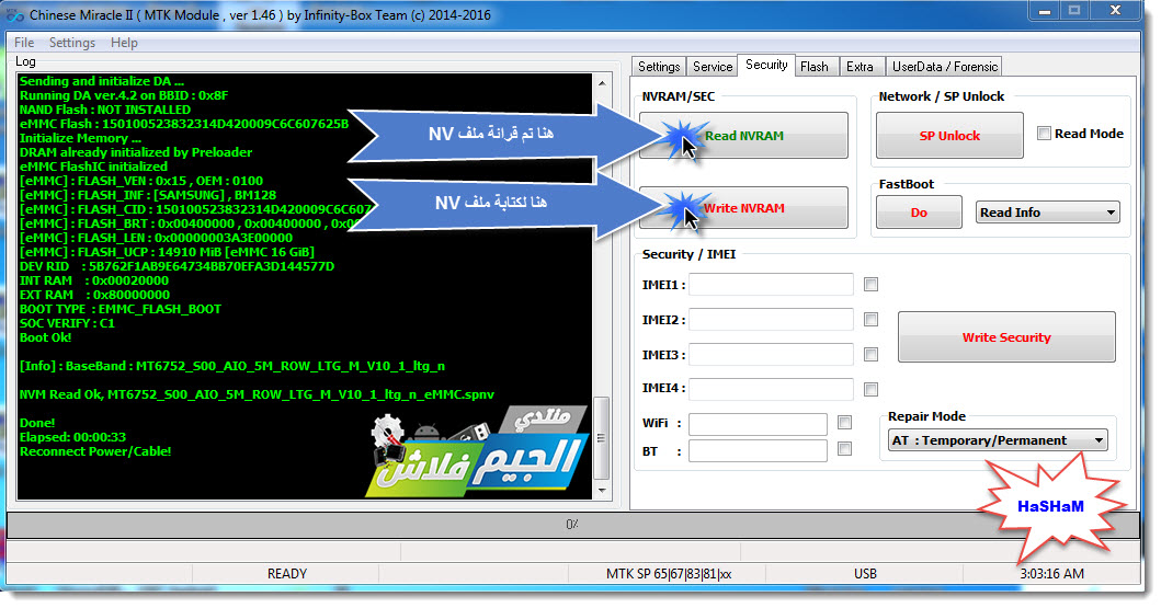

    هنا تم نسخ ملف NV وهو المسؤول عن الشبكات والواي فاي والبلوتوث.
    تم عمل سوفت للجهاز بنجاح بعد عمل باكب للتأكد من سلامتها .

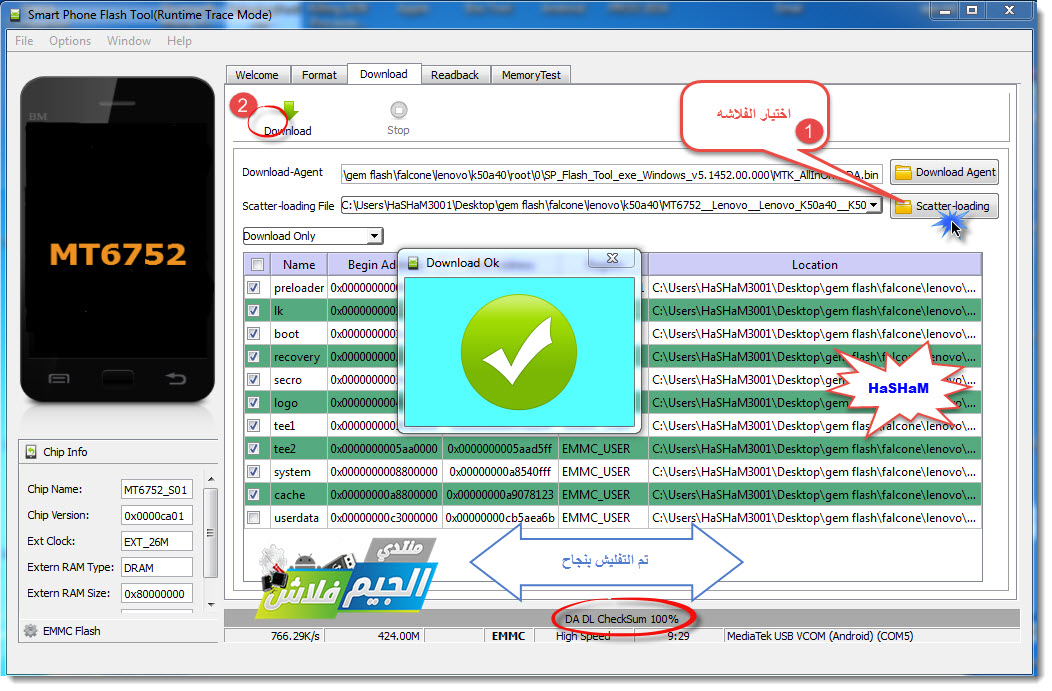

    ايضاً تم تجربتها على الاس بي تول بنجاح .

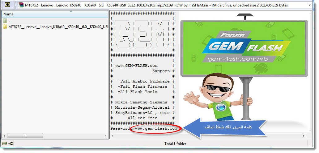

    جميع الملفات مشفره على
    كود:
    www.gem-flash.com
