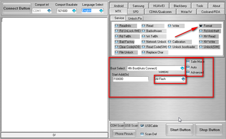

    جرب فورمات علي برنامج Sp Flash Tool او من بوكس الميركل اختر كما باصوره

    اخي بعد التجربة نفس المشكلة وهذا الانفو فورمات كامل وتفليش Welcome to use Miracle Box (World's First Fuzzy Logic Based Tool)
    Update:16-03-19
    Firmware Version:1.16
    Connected OK.
    Fuzzy Logic Method is very safe and reliable !
    License Expire Date: 2016-11-07
    Check Authentication...
    Check the new version.
    ______________________________
    Miracle Box Version 2.32
    Release: 27th April 2016
    # So Many World's First Features.
    (Authorized Distributors and Resellers - GSM-Forum)
    Falcon Box : HTC Pack Coming
    __________[FACEBOOK]__________
    http://facebook.com/amiracleteam
    ___________SUPPORT]___________
    http://support.amiracleteam.com
    Definition Applied
    Definition Applied
    you can Set Formatting Addr
    Waiting for USB Port...
    Set MTK USB Port (COM109)
    Connected to Phone.
    CPU: MT6572 SW:0000 Ver: CA01
    Downloading Boot8 ...
    EMMC Size: 0x00E7000000
    Flash Type: EMMC
    Formatting Nand Flash...
    Format Satrt Addr??0x600000, Size: 0x3C240000
    Format nand OK(Android Need to wait a few minutes the phone is switched)
    MT65xx ANDROID EMMC File:
    Definition Applied
    The File Information:
    N/A
    Connected to Phone.
    Flash Type: EMMC
    Set DA USB VCOM Port (COM395)
    Writing(Nand/eMMC)...
    Writing MBR
    Writing EBR1
    Writing PRO_INFO
    Writing NVRAM
    Writing PROTECT_F
    Writing PROTECT_S
    Writing SECCFG
    Writing UBOOT
    Writing BOOTIMG
    Writing RECOVERY
    Writing SEC_RO
    Writing MISC
    Writing LOGO
    Writing EXPDB
    Writing ANDROID
    Writing CACHE
    Writing USRDATA
    Writing FAT
    Checking Sum...
    Write Done.
    >>Total time: 15 mins 0 s
