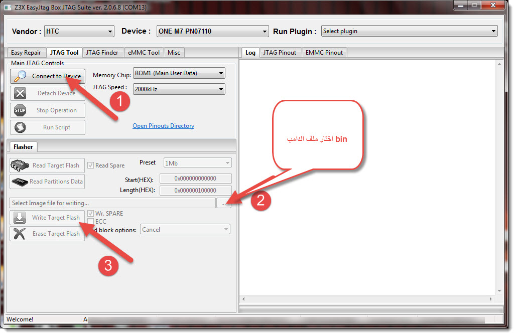

Initialising: HTC ONE M7 PN07130 Config ver.:1.00
I/O Level set to : 2200 mV
Box S/N: XXXXXXXXXXXX ,FW Ver.: 01.52
Connecting to Target...
JTAG device: APQ8064T.
CPU IDCODE : 0x4F1F0F0F Mfg.: 0x787, Part: 0xf1f0, Ver.: 0x4
CPU Manufacturer: Samsung , CPU Name: ARM7GEN
CPU IDCODE : 0x207150E1 Mfg.: 0x070, Part: 0x0715, Ver.: 0x2
CPU Manufacturer: QUALCOMM , CPU Name: APQ8064T Rev 1.0
Halting CPU...
Initialize hardware...
Starting target communication...
Detecting emmc memory parameters of bank (0) ...
EMMC #0 : ID : 0x006F0065 Name : M MOR Size : 1.8 G , (3848192) Blocks
EMMC #1 : ID : 0x006F0065 Name : M MOR Size : 2.0 M , (4096) Blocks
eMMC flash device(s) found, Device ID : 0x0065006f
