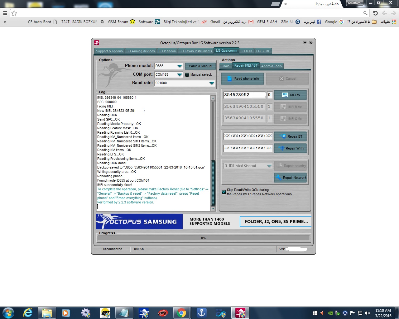

    تم بعون الله عمل ربيير ايمي لهاتفLG G3 بنجاح على الاكتو بلاس
    لاتمام العملية يجب توصيل الهاتف بوصلة P999 وهذا لوغ العملية والصور
    Welcome to Octoplus/Octopus Box LG Software version 2.2.3
    Platform: LG Qualcomm
    Selected port: COM163
    Selected model: D855
    Reading info...
    Model ID: LG-D855
    IMEI: 356349-04-105550-1
    Android version: 5.0
    Battery level: 94%
    Mode: Normal
    Firmware compiled date: Nov 14 2014
    Firmware compiled time: 06:00:00
    Firmware released date: Nov 26 2014
    Firmware released time: 15:35:08
    SW Version: MPSS.DI.2.0.1.c1.13-00046-M8974AAAAANPZM-1
    SPC: 000000
    Performed by 2.2.3 software version.
    Checking data...OK
    Reading info...
    Model ID: LG-D855
    Battery level: 94%
    Mode: Normal
    SPC: 000000
    Fixing IMEI...
    New IMEI: 354523-05-29
    Reading QCN...
    Send SPC...OK
    Reading Mobile Property...OK
    Reading Feature Mask...OK
    Reading Roaming List 0...OK
    Reading NV_Numbered Items...OK
    Reading NV_Numbered SIM1 Items...OK
    Reading NV_Numbered SIM2 Items...OK
    Reading NV Items...OK
    Reading EFS...OK
    Reading Provisioning Items...OK
    Reading QCN done!
    Backup saved to "D855_356349041055501_22-03-2016_10-15-31.qcn"
    Writing security area...OK
    Rebooting phone...
    Found model D855 at port COM164
    IMEI successfully fixed!
    To complete the operation, please make Factory Reset (Go to "Settings" -> "General" -> "Backup & reset" -> "Factory data reset", press "Reset phone" and "Erase everything" buttons).

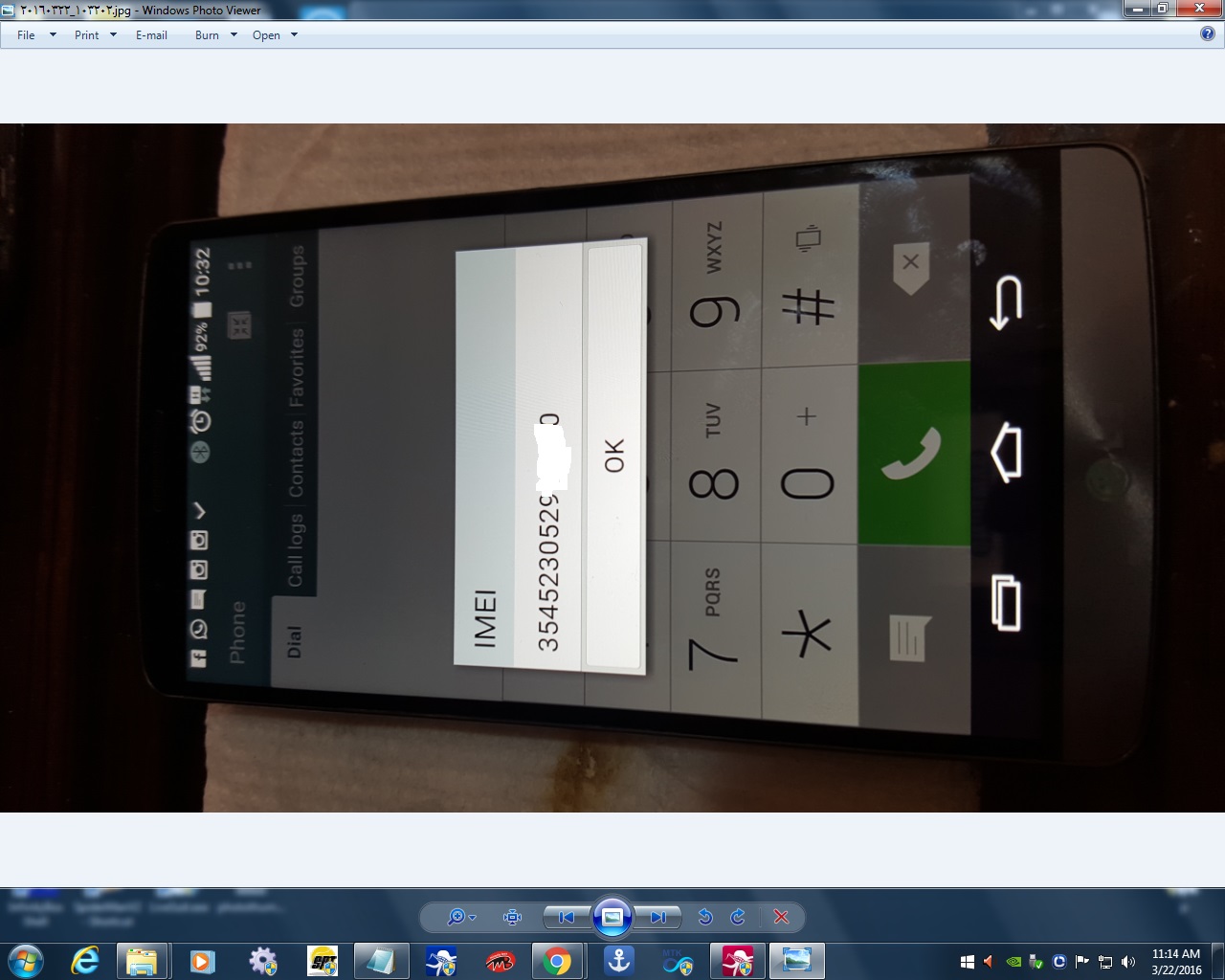

    وهذه صورة الهاتف والشبكة موجودة
    تفيير ايمي lg g3 بنجاح على الاكتو بلاس
