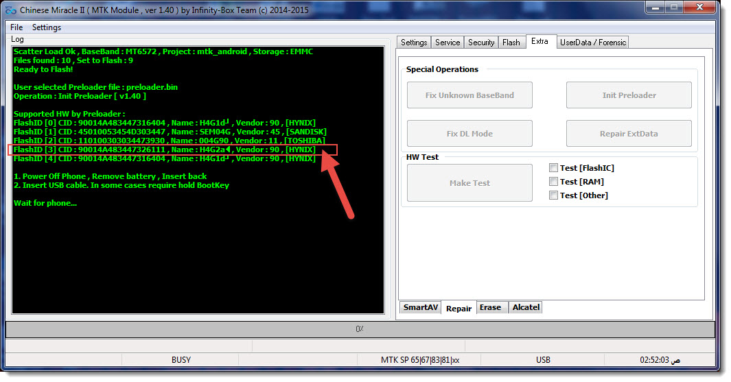

    بارك الله فيكم تم احياء الهاتف بنجاح
    لوغ العملية على الانفينيتي
    كود:
    User selected Preloader file : preloader.bin
    Operation : Init Preloader [ v1.40 ]
    Supported HW by Preloader :
    FlashID [0] CID : 90014A483447316404 , Name : H4G1d , Vendor : 90 , [HYNIX]
    FlashID [1] CID : 45010053454D303447 , Name : SEM04G , Vendor : 45 , [SANDISK]
    FlashID [2] CID : 110100303034473930 , Name : 004G90 , Vendor : 11 , [TOSHIBA]
    FlashID [3] CID : 90014A483447326111 , Name : H4G2a , Vendor : 90 , [HYNIX]
    FlashID [4] CID : 90014A483447316404 , Name : H4G1d , Vendor : 90 , [HYNIX]
    1. Power Off Phone , Remove battery , Insert back
