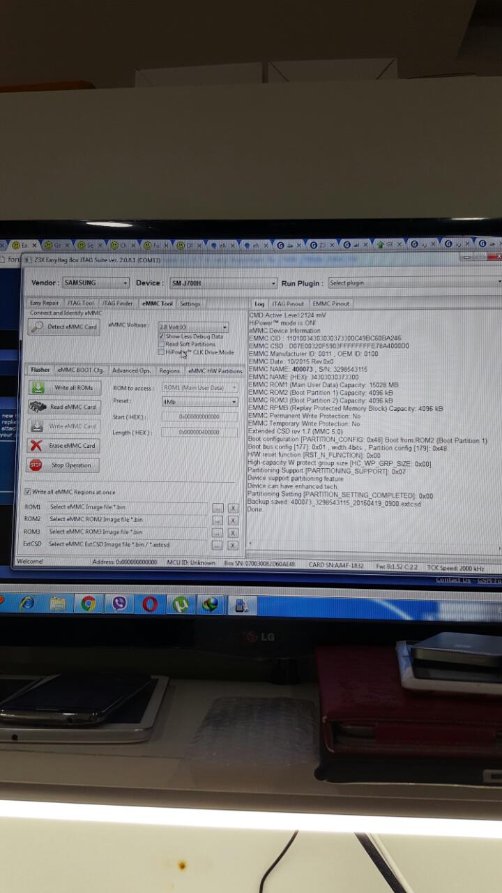

    اخي هل يوجد اخطاء في هذه القرائة
    CMD Pullup Level:484 mV
    CMD Active Level:2320 mV
    HiPower™ mode is off!
    eMMC Device Information
    EMMC CID : 11010034303030373300C49BC60BA246
    EMMC CSD : D07E00320F5903FFFFFFFFE78A4000D0
    EMMC Manufacturer ID: 0011 , OEM ID: 0100
    EMMC Date: 10/2015 Rev.0x0
    EMMC NAME: 400073 , S/N: 3298543115
    EMMC NAME (HEX): 34303030373300
    EMMC ROM1 (Main User Data) Capacity: 15028 MB
    EMMC ROM2 (Boot Partition 1) Capacity: 4096 kB
    EMMC ROM3 (Boot Partition 2) Capacity: 4096 kB
    EMMC RPMB (Replay Protected Memory Block) Capacity: 4096 kB
    EMMC Permanent Write Protection: No
    EMMC Temporary Write Protection: No
    Extended CSD rev 1.7 (MMC 5.0)
    Boot configuration [PARTITION_CONFIG: 0x48] Boot from:ROM2 (Boot Partition 1)
    Boot bus config [177]: 0x01 , width 4bits , Partition config [179]: 0x48.
    H/W reset function [RST_N_FUNCTION]: 0x00
    High-capacity W protect group size [HC_WP_GRP_SIZE: 0x00]
    Partitioning Support [PARTITIONING_SUPPORT]: 0x07
    Device support partitioning feature
    Device can have enhanced tech.
    Partitioning Setting [PARTITION_SETTING_COMPLETED]: 0x00
    Backup saved: 400073_3298543115_20160419_0740.extcsd
    Done.
