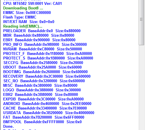

    انفو الهاتف علي الميراكل

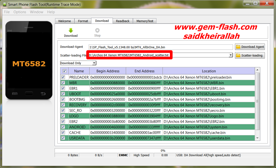

    يمكن تفليش الفلاشه علي الفلاش توول

    ملف الاسكاتر
    كود:
    #  General Setting
    - general: MTK_PLATFORM_CFG
      info:
        - config_version: V1.1.1
          platform: MT6582
          project: mtk_android
          storage: EMMC
          boot_channel: MSDC_0
          block_size: 0x20000
    #  Layout Setting
    - partition_index: SYS0
      partition_name: PRELOADER
      file_name: preloader.bin
      is_download: true
      type: SV5_BL_BIN
      linear_start_addr: 0x0
      physical_start_addr: 0x0
      partition_size: 0x880000
      region: EMMC_BOOT_1
      storage: HW_STORAGE_EMMC
      boundary_check: true
      is_reserved: false
      operation_type: BOOTLOADER
      reserve: 0x00
    - partition_index: SYS1
      partition_name: MBR
      file_name: MBR.bin
      is_download: true
      type: NORMAL_ROM
      linear_start_addr: 0x880000
      physical_start_addr: 0x880000
      partition_size: 0x80000
      region: EMMC_USER
      is_reserved: false
      operation_type: UPDATE
      reserve: 0x00
    - partition_index: SYS2
      partition_name: EBR1
      file_name: EBR1.bin
      is_download: true
      type: NORMAL_ROM
      linear_start_addr: 0x900000
      physical_start_addr: 0x900000
      region: EMMC_USER
      is_reserved: false
      reserve: 0x00
    - partition_index: SYS3
      partition_name: PRO_INFO
      file_name: NONE
      is_download: false
      type: NONE
      linear_start_addr: 0x980000
      physical_start_addr: 0x980000
      partition_size: 0x300000
      region: EMMC_USER
      is_reserved: false
      operation_type: PROTECTED
      reserve: 0x00
    - partition_index: SYS4
      partition_name: NVRAM
      file_name: NONE
      is_download: false
      type: NONE
      linear_start_addr: 0xC80000
      physical_start_addr: 0xC80000
      partition_size: 0x500000
      region: EMMC_USER
      is_reserved: false
      operation_type: INVISIBLE
      reserve: 0x00
    - partition_index: SYS5
      partition_name: PROTECT_F
      file_name: NONE
      is_download: false
      type: NONE
      linear_start_addr: 0x1180000
      physical_start_addr: 0x1180000
      partition_size: 0xA00000
      region: EMMC_USER
      is_reserved: false
      reserve: 0x00
    - partition_index: SYS6
      partition_name: PROTECT_S
      file_name: NONE
      is_download: false
      type: NONE
      linear_start_addr: 0x1B80000
      physical_start_addr: 0x1B80000
      region: EMMC_USER
      is_reserved: false
      reserve: 0x00
    - partition_index: SYS7
      partition_name: SECCFG
      file_name: NONE
      is_download: false
      type: NONE
      linear_start_addr: 0x2580000
      physical_start_addr: 0x2580000
      partition_size: 0x20000
      region: EMMC_USER
      is_reserved: false
      reserve: 0x00
    - partition_index: SYS8
      partition_name: UBOOT
      file_name: uboot.bin
      is_download: true
      type: NORMAL_ROM
      linear_start_addr: 0x25A0000
      physical_start_addr: 0x25A0000
      partition_size: 0x60000
      region: EMMC_USER
      is_reserved: false
      reserve: 0x00
    - partition_index: SYS9
      partition_name: BOOTIMG
      file_name: bootimg.bin
      is_download: true
      type: NORMAL_ROM
      linear_start_addr: 0x2600000
      physical_start_addr: 0x2600000
      partition_size: 0x600000
      region: EMMC_USER
      is_reserved: false
      reserve: 0x00
    - partition_index: SYS10
      partition_name: RECOVERY
      file_name: recovery.bin
      is_download: true
      type: NORMAL_ROM
      linear_start_addr: 0x2C00000
      physical_start_addr: 0x2C00000
      region: EMMC_USER
      is_reserved: false
      reserve: 0x00
    - partition_index: SYS11
      partition_name: SEC_RO
      file_name: secro.bin
      is_download: true
      type: NORMAL_ROM
      linear_start_addr: 0x3200000
      physical_start_addr: 0x3200000
      region: EMMC_USER
      is_reserved: false
      reserve: 0x00
    - partition_index: SYS12
      partition_name: MISC
      file_name: NONE
      is_download: false
      type: NONE
      linear_start_addr: 0x3800000
      physical_start_addr: 0x3800000
      region: EMMC_USER
      is_reserved: false
      reserve: 0x00
    - partition_index: SYS13
      partition_name: LOGO
      file_name: logo.bin
      is_download: true
      type: NORMAL_ROM
      linear_start_addr: 0x3880000
      physical_start_addr: 0x3880000
      region: EMMC_USER
      is_reserved: false
      reserve: 0x00
    - partition_index: SYS14
      partition_name: EBR2
      file_name: EBR2.bin
      is_download: true
      type: NORMAL_ROM
      linear_start_addr: 0x3B80000
      physical_start_addr: 0x3B80000
      region: EMMC_USER
      is_reserved: false
      reserve: 0x00
    - partition_index: SYS15
      partition_name: EXPDB
      file_name: NONE
      is_download: false
      type: NONE
      linear_start_addr: 0x3C00000
      physical_start_addr: 0x3C00000
      region: EMMC_USER
      is_reserved: false
      reserve: 0x00
    - partition_index: SYS16
      partition_name: ANDROID
      file_name: system.bin
      is_download: true
      type: YAFFS_IMG
      linear_start_addr: 0x4600000
      physical_start_addr: 0x4600000
      partition_size: 0x2EE00000
      region: EMMC_USER
      is_reserved: false
      reserve: 0x00
    - partition_index: SYS17
      partition_name: CACHE
      file_name: cache.bin
      is_download: true
      type: YAFFS_IMG
      linear_start_addr: 0x33400000
      physical_start_addr: 0x33400000
      partition_size: 0x7E00000
      region: EMMC_USER
      is_reserved: false
      reserve: 0x00
    - partition_index: SYS18
      partition_name: USRDATA
      file_name: userdata.bin
      is_download: true
      type: YAFFS_IMG
      linear_start_addr: 0x3B200000
      physical_start_addr: 0x3B200000
      partition_size: 0x40000000
      region: EMMC_USER
      is_reserved: false
      reserve: 0x00
    - partition_index: SYS19
      partition_name: FAT
      file_name: NONE
      is_download: false
      type: NONE
      linear_start_addr: 0x7B200000
      physical_start_addr: 0x7B200000
      partition_size: 0x6FF00000
      region: EMMC_USER
      is_reserved: false
      reserve: 0x00
    - partition_index: SYS20
      partition_name: BMTPOOL
      file_name: NONE
      is_download: false
      type: NONE
      linear_start_addr: 0xFFFF0000
      physical_start_addr: 0xFFFF0000
      partition_size: 0x1500000
      region: EMMC_USER
      boundary_check: false
      is_reserved: true
      operation_type: RESERVED
      reserve: 0x00
