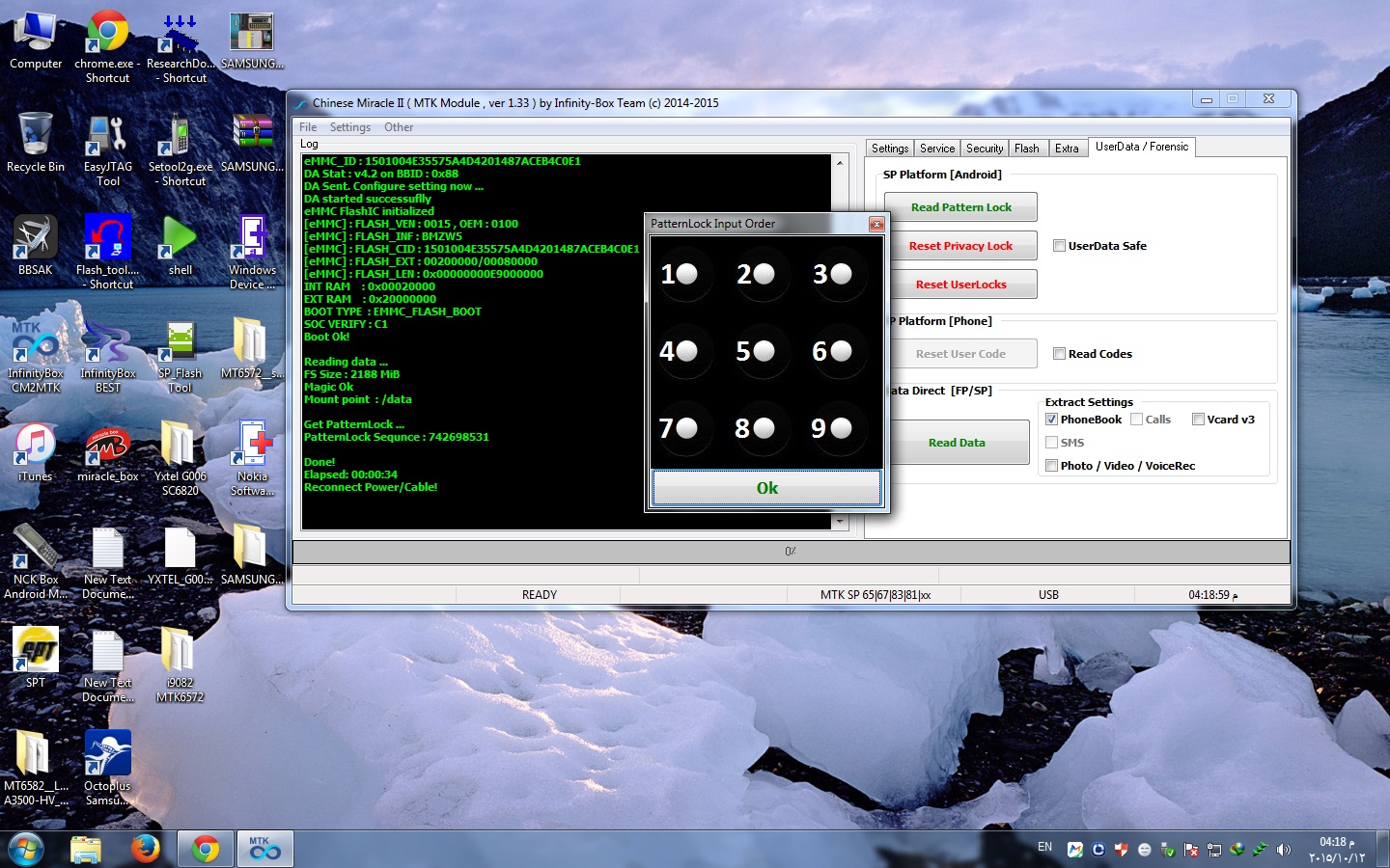

    افتراضي قرأة رمز الحماية ALCATEL ONE TOUCH 6012D بدون مسح البيانات ....
    Operation : Check / Read Info [ v1.33 ]
    1. Power Off Phone , Remove battery , Insert back
    2. Insert USB cable. In some cases require hold BootKey
    Wait for phone...
    Phone found! [ 17 ]
    Sync...
    Inital regs read done
    Boot Info :
    BB_CPU_ID : 6572
    BB_CPU_HW : CA01
    BB_CPU_SW : 8A00
    BB_CPU_SB : 0000
    BB_CPU_NM : [MediaTek] MT6572_S00
    Processing BROM stage
    BLVersion : 0x01
    SecCfgVal : 0x00000000
    BromVersion : 0xFF
    BLVersion : 0x01
    Preloader Status : Alive
    Processing DA stage
    DA Select done , sending
    DA Ver : MTK_AllInOne_DA_v7.1533.03
    NAND_ID : 00000000000000000000000000000000
    eMMC_ID : 1501004E35575A4D4201487ACEB4C0E1
    DA Stat : v4.2 on BBID : 0x88
    DA Sent. Configure setting now ...
    DA started successuflly
    eMMC FlashIC initialized
    [eMMC] : FLASH_VEN : 0015 , OEM : 0100
    [eMMC] : FLASH_INF : BMZW5
    [eMMC] : FLASH_CID : 1501004E35575A4D4201487ACEB4C0E1
    [eMMC] : FLASH_EXT : 00200000/00080000
    [eMMC] : FLASH_LEN : 0x00000000E9000000
    INT RAM : 0x00020000
    EXT RAM : 0x20000000
    BOOT TYPE : EMMC_FLASH_BOOT
    SOC VERIFY : C1
    Boot Ok!
    [AP] : Initial info read Ok!
    Brand : TCT
    ProdName : California
    ProdModel : ALCATEL ONE TOUCH 6012D
    Device : California
    AndroidVer: 4.2.2
    MTKxCPU : MT6572
    MTKxPRJ : ALPS.JB3.MP.V1
    Done!
    Elapsed: 00:00:11
    Reconnect Power/Cable!
    شكرا لعرض التجربه
