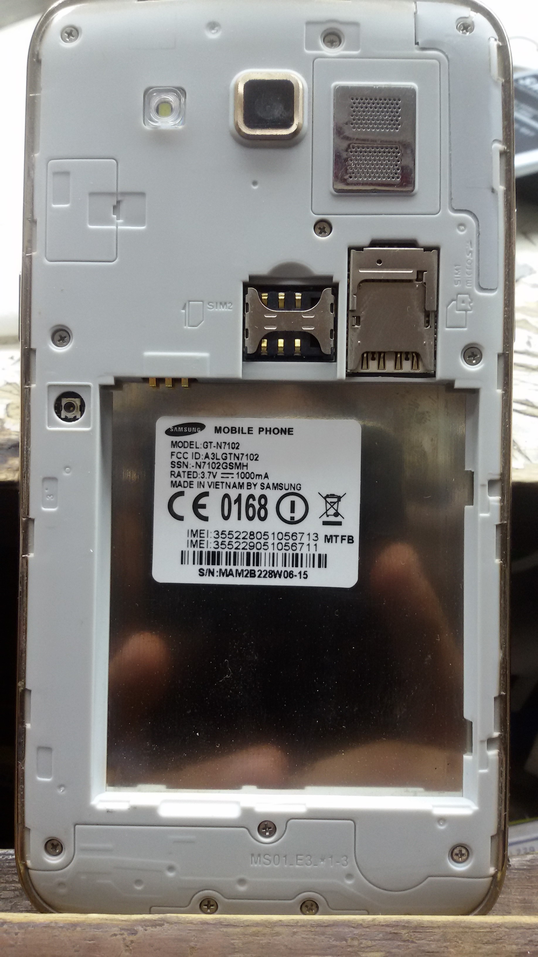

    Red face فلاشه GT-N7102 CPU MT6572 SW0000 Ver CA01 EMMC Size 0x00EC000000
    كود:
      Analysis of USB port,Please insert phone USB cable.
      Connecting...
      CPU TYPE:MT6572
      Hardware version:CA01
      Software version:0000
      SecCfgVal :0x00000000
      BromVersion :0xFF
      BLVersion :0x01
      Boot downloading complete!
      EMMC_ID:0x11010030303447453001E0D201222CD5
      EMMC_PRODUCT_NAME: SAMSUNG :0x303034474530
      EMMC_BOOT1_SIZE: 0x00200000
      EMMC_BOOT2_SIZE: 0x00200000
      EMMC_PRMB_SIZE: 0x00080000
      EMMC_GP1_SIZE: 0x00000000
      EMMC_GP2_SIZE: 0x00000000
      EMMC_GP3_SIZE: 0x00000000
      EMMC_GP4_SIZE: 0x00000000
      EMMC_USER_SIZE: 0x0EC000000(3.69 G)
      Analysis of system files...
      PRELOADER:  addr:0x000000 --length:0x880000
      MBR:  addr:0x880000 --length:0x080000
      EBR1:  addr:0x900000 --length:0x080000
      PRO_INFO:  addr:0x980000 --length:0x300000
      NVRAM:  addr:0xC80000 --length:0x500000
      PROTECT_F:  addr:0x1180000 --length:0xA00000
      PROTECT_S:  addr:0x1B80000 --length:0xA00000
      SECCFG:  addr:0x2580000 --length:0x020000
      UBOOT:  addr:0x25A0000 --length:0x060000
      BOOTIMG:  addr:0x2600000 --length:0x600000
      RECOVERY:  addr:0x2C00000 --length:0x600000
      SEC_RO:  addr:0x3200000 --length:0x040000
      MISC:  addr:0x3240000 --length:0x080000
      LOGO:  addr:0x32C0000 --length:0x300000
      EXPDB:  addr:0x35C0000 --length:0xA00000
      ANDROID:  addr:0x3FC0000 --length:0x2B200000
      CACHE:  addr:0x2F1C0000 --length:0x17800000
      USRDATA:  addr:0x469C0000 --length:0x52C00000
      FAT:  addr:0x995C0000 --length:0x519C0000
      BMTPOOL:  addr:0xFFFF00A8 --length:0x1500000
        Format addr:0x469C0000 --Format length:0x52C00000
    >>Read phone information success.
      Definition Applied
      Waiting for USB Port...
      Set MediaTek PreLoader USB VCOM Port (COM25)
      Connected to Phone.
      CPU: MT6572 SW:0000 Ver: CA01
      Downloading Boot8 ...
      EMMC Size: 0x00EC000000
      Flash Type: EMMC
      INT/EXT RAM  Size: 0x0+0x0
      Reading infr(EMMC)...
      PRELOADER  BaseAddr:0x0  Size:0x880000
      MBR  BaseAddr:0x880000  Size:0x80000
      EBR1  BaseAddr:0x900000  Size:0x80000
      PRO_INFO  BaseAddr:0x980000  Size:0x300000
      NVRAM  BaseAddr:0xC80000  Size:0x500000
      PROTECT_F  BaseAddr:0x1180000  Size:0xA00000
      PROTECT_S  BaseAddr:0x1B80000  Size:0xA00000
      SECCFG  BaseAddr:0x2580000  Size:0x20000
      UBOOT  BaseAddr:0x25A0000  Size:0x60000
      BOOTIMG  BaseAddr:0x2600000  Size:0x600000
      RECOVERY  BaseAddr:0x2C00000  Size:0x600000
      SEC_RO  BaseAddr:0x3200000  Size:0x40000
      MISC  BaseAddr:0x3240000  Size:0x80000
      LOGO  BaseAddr:0x32C0000  Size:0x300000
      EXPDB  BaseAddr:0x35C0000  Size:0xA00000
      ANDROID  BaseAddr:0x3FC0000  Size:0x2B200000
      CACHE  BaseAddr:0x2F1C0000  Size:0x17800000
      USRDATA  BaseAddr:0x469C0000  Size:0x52C00000
      FAT  BaseAddr:0x995C0000  Size:0x519C0000
      BMTPOOL  BaseAddr:0xFFFF00A8  Size:0x1500000
      BaseAddr:0x0  Size:0x0
    >>Done.
