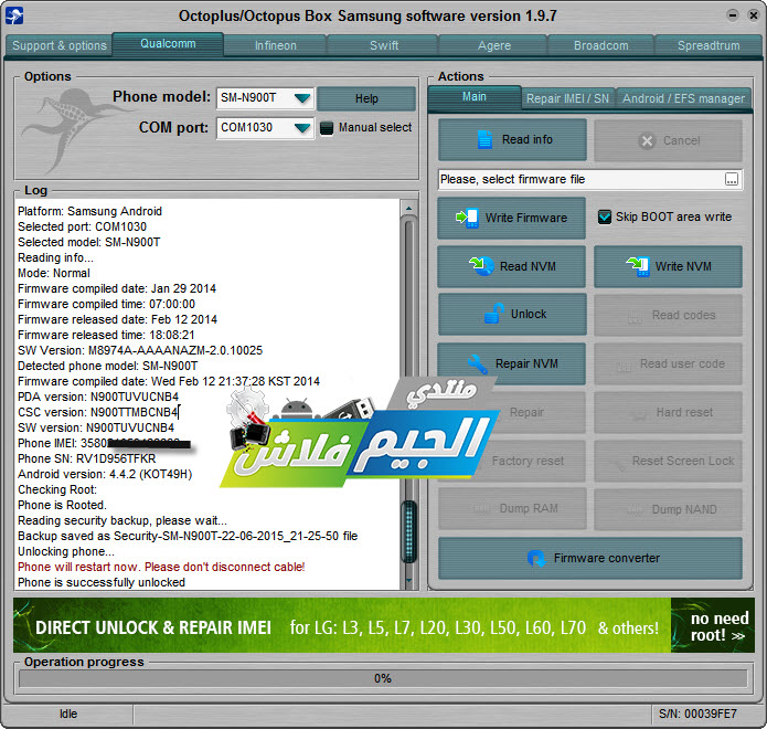

    تم فك شفرة N900T فيرجن 4.4.2 عن طريق بوكس Octopus
    Ulocked N900T V4.4.2 by Octopus Box
    لابد اولا من عمل روت للجهاز وملف الروت فى هذا الرابط CF-Root Download
    بعد ذلك قم بتحديد الموديل فى برنامج Octopus
    لوج الجهاز
    Welcome to Octoplus/Octopus Box Samsung software version 1.9.7
    To connect SGH-T889 phone you have to perform the following steps:
    1. Disconnect USB cable from phone.
    2. Go to Menu->Settings->Developer options.
    3. Turn on "USB Debugging" option.
    4. When message is appear press "Yes".
    5. Go to dial window.
    6. Enter "*#7284#" number.
    7. Set "UART" radio button to "MODEM" value.
    8. Go to "Qualcomm USB Settings".
    9. Select "DM+MODEM+ADB".
    10. Press Home button.
    11. Go to dial window.
    12. Enter "*#9090#" number.
    13. Select "DM/UM over HS-USB".
    14. Restart phone.
    15. Press "Read Info" in software.
    Platform: Samsung Android
    Selected port: COM1030
    Selected model: SM-N900T
    Reading info...
    Mode: Normal
    Firmware compiled date: Jan 29 2014
    Firmware compiled time: 07:00:00
    Firmware released date: Feb 12 2014
    Firmware released time: 18:08:21
    SW Version: M8974A-AAAANAZM-2.0.10025
    Detected phone model: SM-N900T
    Firmware compiled date: Wed Feb 12 21:37:28 KST 2014
    PDA version: N900TUVUCNB4
    CSC version: N900TTMBCNB4
    SW version: N900TUVUCNB4
    Phone IMEI: 358021xxxxxxxxx
    Phone SN: RV1D956TFKR
    Android version: 4.4.2 (KOT49H)
    Checking Root:
    Phone is Rooted.
    Reading security backup, please wait...
    Backup saved as Security-SM-N900T-22-06-2015_21-25-50 file
    Unlocking phone...
    Phone will restart now. Please don't disconnect cable!
    Phone is successfully unlocked
    To finish the operation, please restart the phone via phone's menu
    (don't disconnect the battery!)
