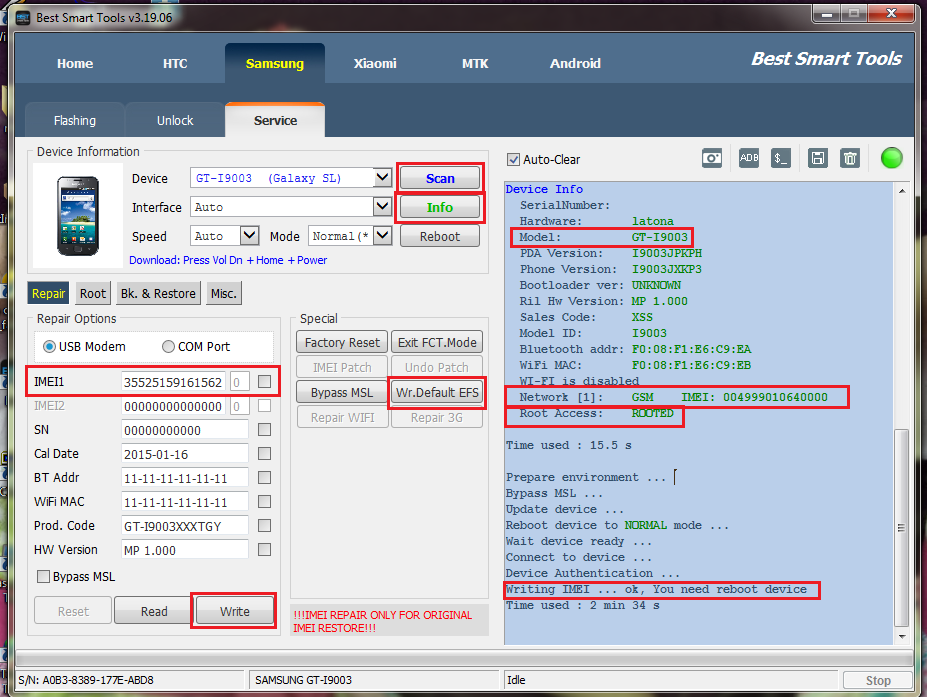

    افتراضي اصلاح وضع الطيران جوال جلاكسي GT-I9003
    كتابة ملف efs
    وكتابة سريل
    Scanning devices ... 1 found
    dev[1]
    Manufactory: SAMSUNG
    Model: GT-I9003
    Hardware: LATONA
    Mode: normal
    Download: Press Vol Dn + Home + Power
    UART Cable Resistor: 523 K
    ReadCodes/Unlock/Repair:
    Type *#9090# set Diag Config to LOG VIA USB.
    Cables: MicroUSB
    Interfaceï¼ڑAuto
    Read Info/Flashing/UserLock/Backup:
    Cables: MicroUSB
    Interface: Auto
    Checking environment ...
    System Info
    Display ID: GINGERBREAD
    System Ver: 2.3.6 REL
    API Level: 10
    Incremental: JPKPH
    Model: GT-I9003
    Brand: samsung
    Device: GT-I9003
    Platform: omap3
    Language: ar
    Rigion: AE
    Device Info
    SerialNumber:
    Hardware: latona
    Model: GT-I9003
    PDA Version: I9003JPKPH
    Phone Version: I9003JXKP3
    Bootloader ver: UNKNOWN
    Ril Hw Version: MP 1.000
    Sales Code: XSS
    Model ID: I9003
    Bluetooth addr: F0:08:F1:E6:C9:EA
    WiFi MAC: F0:08:F1:E6:C9:EB
    WI-FI is disabled
    Network [1]: GSM IMEI: 004999010640000
    Root Access: ROOTED
    Time used : 15.5 s
    Prepare environment ...
    Bypass MSL ...
    Update device ...
    Reboot device to NORMAL mode ...
    Wait device ready ...
    Connect to device ...
    Device Authentication ...
    Writing IMEI ... ok, You need reboot device
    Time used : 2 min 34 s
