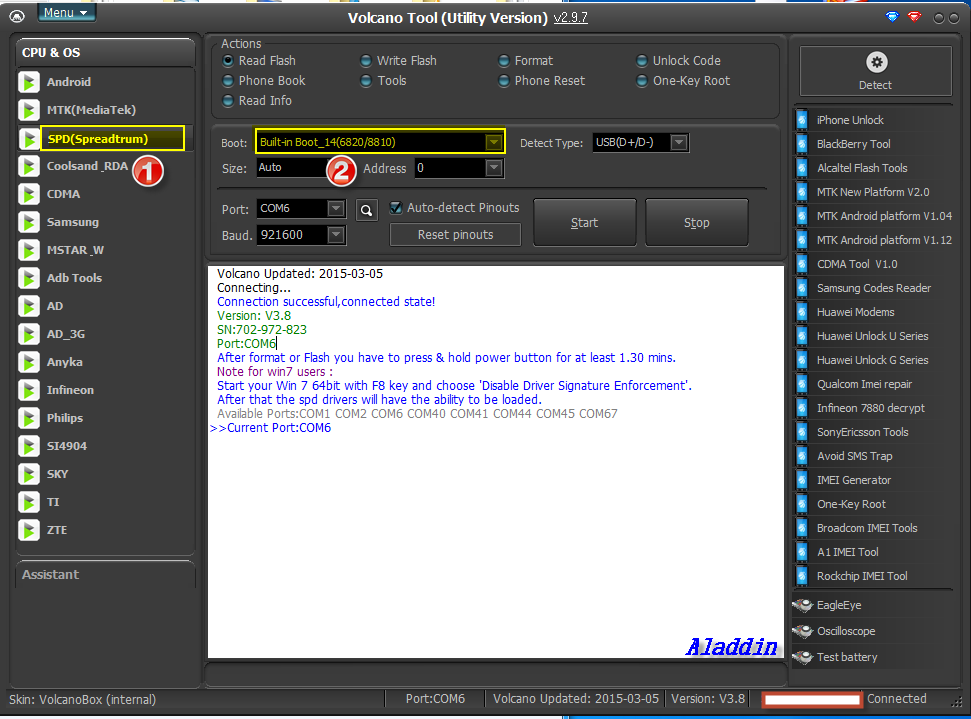

      لم أعرف نوعية CPU هل MTK أو SPD أو ...
      هل من طريقة لقرائته على VOLCANO

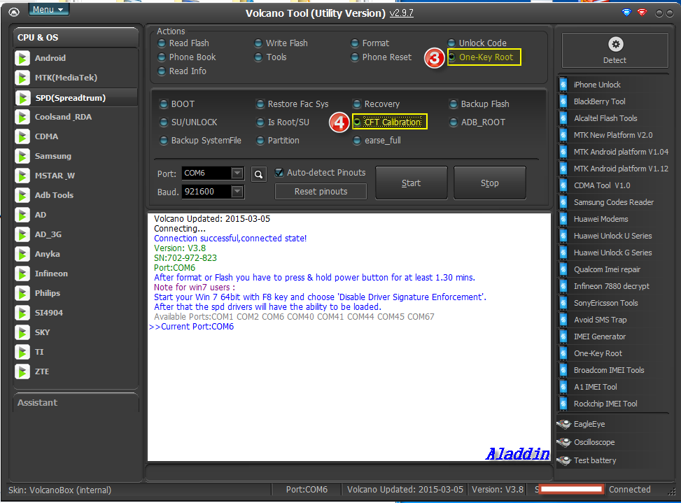

    تابع الخطوات
    مساعدة كود تليفون سامسونج صيني samsung galaxy s R940

    icon1
    Internal version: SPRD3
    Boot downloaded.
    Start boot please wait a moment....
    Spreadtrum Boot Block version 1.2
    CPU TYPE:SC6531 [65310000]
    FLASH ID: 00C8006000180000
    Flash Type:[GD] 25LQ128YIG
    Reading completed.
    The data has been saved in C:\Users\mezianipc\Desktop\volcano\FLASH&FIRMWARE\ SAMSUNG.SPD.R940\MOCOR_12B_6531.W13.07_Release_201 50311_111734_FullFlash.bin, size: 16 M.
    Failes to open the file!
    Screen Lock input order:
    ¢أ™ ¢أڑ ¢أ›
    ¢أœ ¢أ‌ ¢أ‍
    ¢أں ¢à ¢أ،
    [screen lock]:1111
    Software has two ways to find password, it may have different results to click button again.
    Simple search:
    [screen lock]:14
    1 2 3
    4 5 6
    7 8 9
    Looking for passwords,please wait...
    [Phone Lock] 1234
    [Phone Lock] 2020
    >>Looking for passwords complete.
