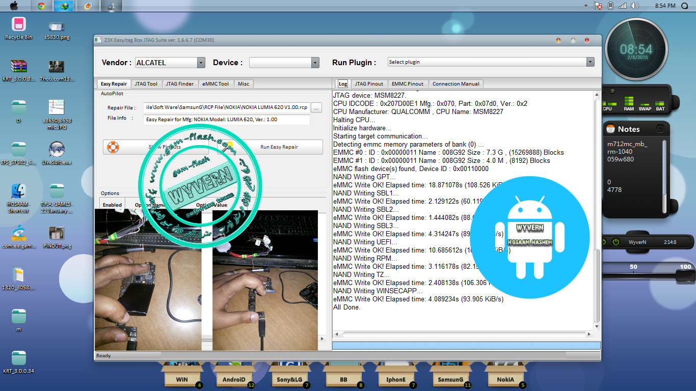

    attachmentphp?attachmentid105234&ampd1338387978
    تم بحمد الله اصلاح بوت
    lumia 620 repair dead boot done with Easy Jtag
    Lumia 620 Smart Shoot
    على العملاق
    Easy Jtag
    z3x jtag 400
    كود:
    Connecting to Target...
    كود:
    JTAG device: wyvern.
    CPU IDCODE : 0x4F1F0F0F Mfg.: 0x787, Part: 0xf1f0, Ver.: 0x4
    CPU Manufacturer: Samsung , CPU Name: ARM7GEN
    JTAG device: MSM8227.
    CPU IDCODE : 0x207D00E1 Mfg.: 0x070, Part: 0x07d0, Ver.: 0x2
    CPU Manufacturer: QUALCOMM , CPU Name: MSM8227
    Halting CPU...
    Initialize hardware...
    Starting target communication...
    Detecting emmc memory parameters of bank (0) ...
    EMMC #0 : ID : 0x00000011 Name : 008G92 Size : 7.3 G , (15269888) Blocks
    EMMC #1 : ID : 0x00000011 Name : 008G92 Size : 4.0 M , (8192) Blocks
    eMMC flash device(s) found, Device ID : 0x00110000
    NAND Writing GPT...
    eMMC Write OK! Elapsed time: 18.871078s (108.526 KiB/s)
    NAND Writing SBL1...
    eMMC Write OK! Elapsed time: 2.129122s (60.119 KiB/s)
    NAND Writing SBL2...
    eMMC Write OK! Elapsed time: 1.444082s (88.638 KiB/s)
    NAND Writing SBL3...
    eMMC Write OK! Elapsed time: 4.314247s (89.007 KiB/s)
    NAND Writing UEFI...
    eMMC Write OK! Elapsed time: 10.685612s (107.809 KiB/s)
    NAND Writing RPM...
    eMMC Write OK! Elapsed time: 3.116178s (82.152 KiB/s)
    NAND Writing TZ...
    eMMC Write OK! Elapsed time: 2.408138s (106.306 KiB/s)
    NAND Writing WINSECAPP...
    eMMC Write OK! Elapsed time: 4.089234s (93.905 KiB/s)
    All Done.
    و دمتم بخير
