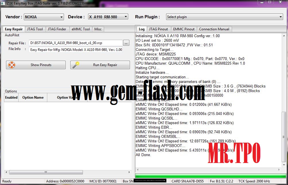

    اليوم بحمد الله تم عمل ربير بوت
    NOKIA X
    تم عمل ربير بوت NOKIA X
    كود
    كود HTML:
    EasyJtag Suite ver.: 1.7.0.2 / wxWidgets 3.1.0-W-U started.
    Operating system ver.: Windows 7 (build 7601, Service Pack 1).
    For support and updates visit http://easy-jtag.com
    Check security...OK
    Initialising: NOKIA X A110 RM-980 Config ver.:1.00
    I/O Level set to : 2600 mV
    Box S/N: 0D00101F13418472 ,FW Ver.: 01.51
    Connecting to Target...
    JTAG device: MSM8225
    CPU IDCODE : 0x007700E1 Mfg.: 0x070, Part: 0x0770, Ver.: 0x0
    CPU Manufacturer: QUALCOMM , CPU Name: MSM8225 Rev 1.0
    Halting CPU...
    Initialize hardware...
    Starting target communication...
    Detecting emmc memory parameters of bank (0) ...
    EMMC #0 : ID : 0x01000015 Name : S5XKMB Size : 3.6 G , (7634944) Blocks
    EMMC #1 : ID : 0x01000015 Name : S5XKMB Size : 4.0 M , (8192) Blocks
    eMMC flash device(s) found, Device ID : 0x00150000
    Loading repair file: 'D:\BST\NOKIA_X_A110_RM-980_boot_v1_00.rcp'
    Repair File ver. : Easy Repair for Mfg: NOKIA Model: X A110 RM-980, Ver.: 1.00
    Repair file options. : NONE
    Easy-Repair file load OK!
    Using EasyRepair Mode...
    Checking repair data...
    Check security...OK
    Halting CPU...
    EMMC Writing MBR...
    eMMC Write OK! Elapsed time: 0.012000s (41.667 KiB/s)
    EMMC Writing QCSBLHD...
    eMMC Write OK! Elapsed time: 0.093005s (215.042 KiB/s)
    EMMC Writing QCSBL...
    eMMC Write OK! Elapsed time: 1.970113s (126.896 KiB/s)
    EMMC Writing EBR...
    eMMC Write OK! Elapsed time: 0.210012s (304.744 KiB/s)
    EMMC Writing OEMSBL...
    eMMC Write OK! Elapsed time: 12.275702s (166.834 KiB/s)
    EMMC Writing APPSBOOT...
    eMMC Write OK! Elapsed time: 4.201240s (182.803 KiB/s)
    All Done.
    ملاحظة
    يجب كتاب ملف الدامب بعد عملية الربير
