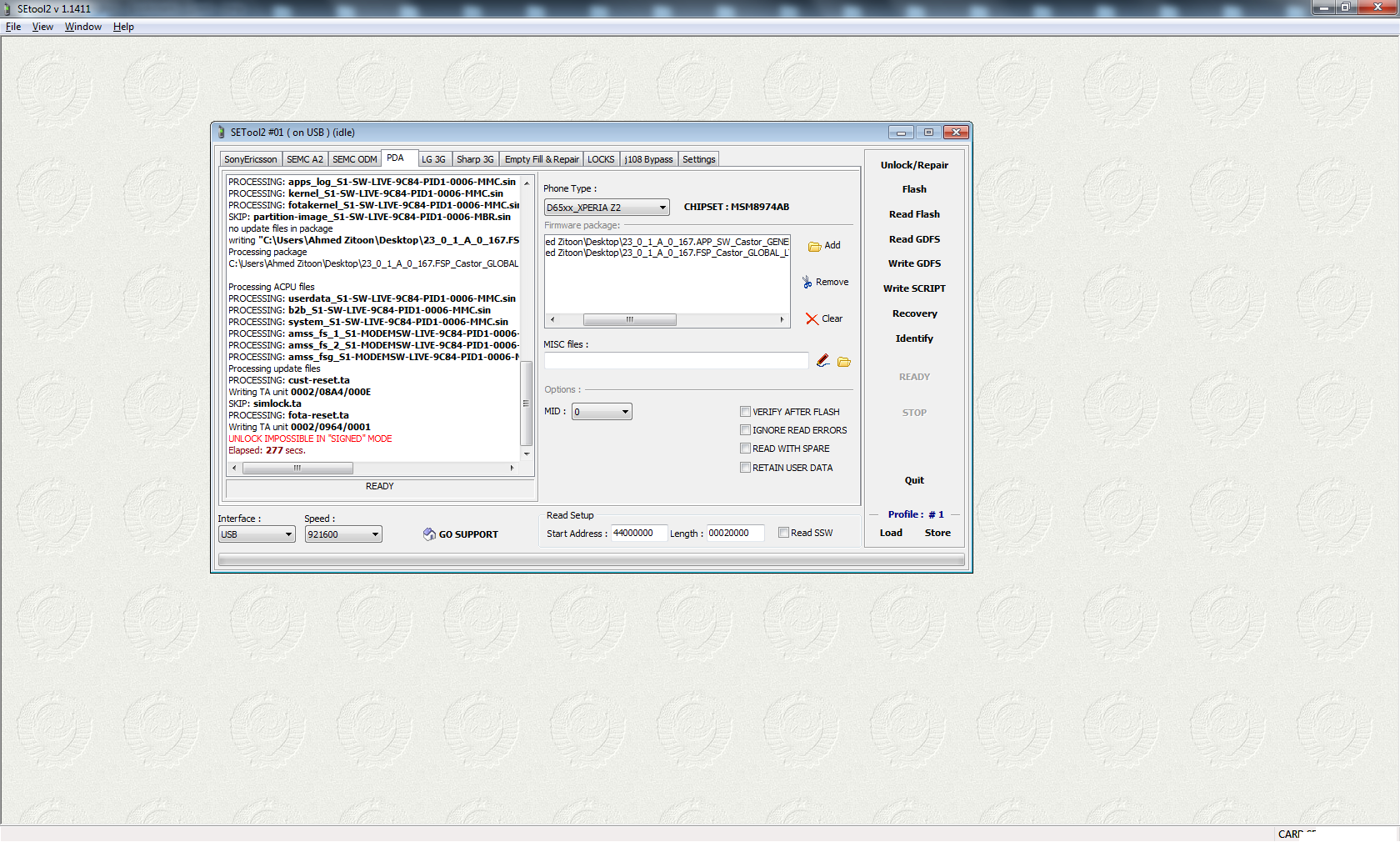

    السلام عليكمورحمه الله و بركاته
    اليوم طريقه تلفيش التابلت الغير مدعوم فالقائمه عاى السي تول
    الفلاشه المستخدمه العربيه
    23_0_1_A_0_167.FSP_Castor_GLOBAL_LTE_1282_3637_S1_SW_LIVE_9C84_PID1_0005_MMC.R2B.zip
    23_0_1_A_0_167.APP_SW_Castor_GENERIC_1278_4804_S1_SW_LIVE_9C84_PID1_0005_MMC.zip
    تلفيش Tablet Z2 على السى تول
    RUNNING v 1.1411/01.15/UNI
    CARD SERIAL 00090565
    PLEASE UPGRADE USBFLASH DRIVER 02.00.00.01
    SIGNED MODE (USING SERVER)
    CFG:101100000000
    PLEASE ATTACH TURNED OFF PHONE NOW
    PRESS AND HOLD "BACK" OR "VOLUME DOWN" BUTTON ...
    RUNNING S1_BOOT VER "S1_Boot_MSM8974AB_LA2.0.1_43-A"
    ACTIVE_COMP_AID : 0004
    HWCONF_AID : 0004
    LOADER_AID : 0004
    BOOT_AID : 0004
    DEVICE ID: 06655EEF
    FLASH ID: "0015/01000001"
    LOADER VERSION: "MSM8974AB_22"
    PHONE IMEI : 35294506022716
    writing "C:\Users\Ahmed Zitoon\Desktop\23_0_1_A_0_167.APP_SW_Castor_GENERIC_1278_4804_S1_SW_LIVE_9C84_PID1_0005_MMC.zip"
    Processing package
    WILL UPDATE BOOT TO : 1277-2049 S1_BOOT_MSM8974AB_LA3.0_55
    PARSING: "DEVELOPMENT"
    value OTP_LOCK_STATUS_1 : UNLOCKED, not match LOCKED
    PARSING: "TEST_OEM0_007B80E1"
    value OTP_LOCK_STATUS_1 : LOCKED, match LOCKED
    value OTP_DATA_1 : 00000100, not match 01000400
    value IDCODE_1 : 007B80E1, match 007B80E1
    PARSING: "PRECOMMERCIAL_007B80E1"
    value OTP_DATA_1 : 01000400, match 01000400
    PROCESSING : dbi_S1_Boot_MSM8974AB_LA3_0_55_AID_4_PLATFORM-MSM8974AB-LIVE-HWID007B80E1-SWID12-OEM1-AID4-DEBUG00_S1-BOOT-LIVE-9C8 ...
    PROCESSING : emmc_appsboot_S1_Boot_MSM8974AB_LA3_0_55_AID_4_PLATFORM-MSM8974AB-LIVE-HWID007B80E1-SWID09-OEM1-AID4-DEBUG00_S1-BOO ...
    PROCESSING : rpm_S1_Boot_MSM8974AB_LA3_0_55_AID_4_PLATFORM-MSM8974AB-LIVE-HWID007B80E1-SWID0A-OEM1-AID4-DEBUG00_S1-RPMFW-LIVE-9C ...
    PROCESSING : s1sbl_S1_Boot_MSM8974AB_LA3_0_55_AID_4_PLATFORM-MSM8974AB-LIVE-HWID007B80E1-SWID65-OEM1-AID4-DEBUG00_S1-BOOT-LIVE-9 ...
    PROCESSING : sbl1_S1_Boot_MSM8974AB_LA3_0_55_AID_4_PLATFORM-MSM8974AB-LIVE-HWID007B80E1-SWID00-OEM1-AID4-DEBUG00_S1-BOOT-LIVE-9C ...
    PROCESSING : tz_S1_Boot_MSM8974AB_LA3_0_55_AID_4_PLATFORM-MSM8974AB-LIVE-HWID007B80E1-SWID07-OEM1-AID4-DEBUG00_S1-BOOT-LIVE-9C84 ...
    PROCESSING : Castor_S1BootConfig_MiscTA.ta
    Writing TA unit 0002/084F/004E
    Writing TA unit 0002/08FD/0001
    BOOT UPDATED
    Processing ACPU files
    PROCESSING: cache_S1-SW-LIVE-9C84-PID1-0006-MMC.sin
    PROCESSING: apps_log_S1-SW-LIVE-9C84-PID1-0006-MMC.sin
    PROCESSING: kernel_S1-SW-LIVE-9C84-PID1-0006-MMC.sin
    PROCESSING: fotakernel_S1-SW-LIVE-9C84-PID1-0006-MMC.sin
    SKIP: partition-image_S1-SW-LIVE-9C84-PID1-0006-MBR.sin
    no update files in package
    writing "C:\Users\Ahmed Zitoon\Desktop\23_0_1_A_0_167.FSP_Castor_GLOBAL_LTE_1282_3637_S1_SW_LIVE_9C84_PID1_0005_MMC.R2B.zip"
    Processing package
    PROCESSING: userdata_S1-SW-LIVE-9C84-PID1-0006-MMC.sin
    PROCESSING: b2b_S1-SW-LIVE-9C84-PID1-0006-MMC.sin
    PROCESSING: system_S1-SW-LIVE-9C84-PID1-0006-MMC.sin
    PROCESSING: amss_fs_1_S1-MODEMSW-LIVE-9C84-PID1-0006-MMC.sin
    PROCESSING: amss_fs_2_S1-MODEMSW-LIVE-9C84-PID1-0006-MMC.sin
    PROCESSING: amss_fsg_S1-MODEMSW-LIVE-9C84-PID1-0006-MMC.sin
    Processing update files
    PROCESSING: cust-reset.ta
    Writing TA unit 0002/08A4/000E
    SKIP: simlock.ta
    PROCESSING: fota-reset.ta
    Writing TA unit 0002/0964/0001
    UNLOCK IMPOSSIBLE IN "SIGNED" MODE
    Elapsed: 277 secs.
    بالتوفيق احمد زيتون
