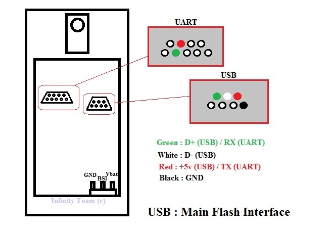

السلام عليكم ورحمه الله وبركاته مشكله في نوكيا 108 عليه رمز قفل عند تركيب الشريحه عند عمل ريست كود علي دونجل البيست Dead Mode is Selected Waiting for USB device... 1. Phone should be Off! 2. Battery must be charged and inserted! ( if not used external power ) - > If phone can't switch to BL - use battery or flash from Local mode! --- Insert USB cable now! --- Wait for phone... Phone found! [ 360 ] Sync... Sync Ok, read regs... Inital regs read done Boot Info : BB_CPU_ID : 625A BB_CPU_HW : CA01 BB_CPU_SW : 0001 BB_CPU_SB : 8000 BB_CPU_NM : [MediaTek] MT6250_S0001 BB_CPU_SN : 13F2CF5F80AB2F2F2DDA8464A6230982 BROM Protocol Version : 05 BROM Status : 1012 Comm Status : 0000 EXBL Status : Alive [ USB Load Active ] Switch to BL failed! (CMD not accepted, 0xAA) Check Power / Cable! BootLoader Init Failed (HW/Connection Error) Connect phone on selected interface... Connect phone on selected interface... مع العلم اني موصله يو اس بي عن طريق البن اوت
