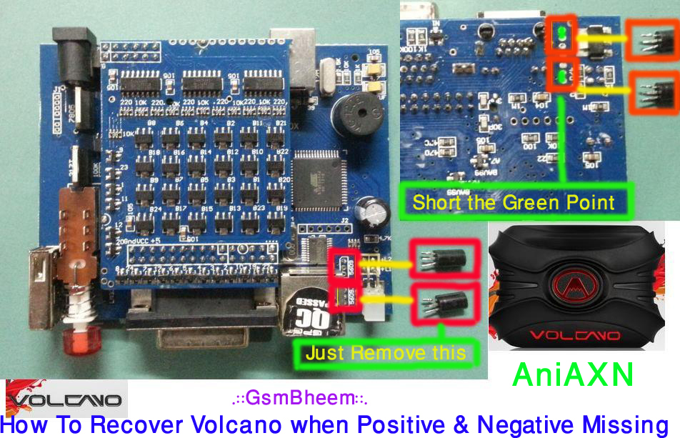

    How To Recover Volcano Box When Positive & Negative Line Missing

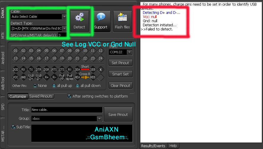

    Here I Face one Box Which Positive & Negative Line are Null
    Box Con't Detect [D+/ D-] Mode
    Box work Only [Rx/Tx] Mode
    Many User Face this Problem
    (منقول) تصليح بوكس الفولكينو = When Positive & Negative Line Missing
    If User Face this Kind Of Problem
    Do First System Recovery Also Update All Driver
    If Still Same ..Do As Bellow Like this Pic

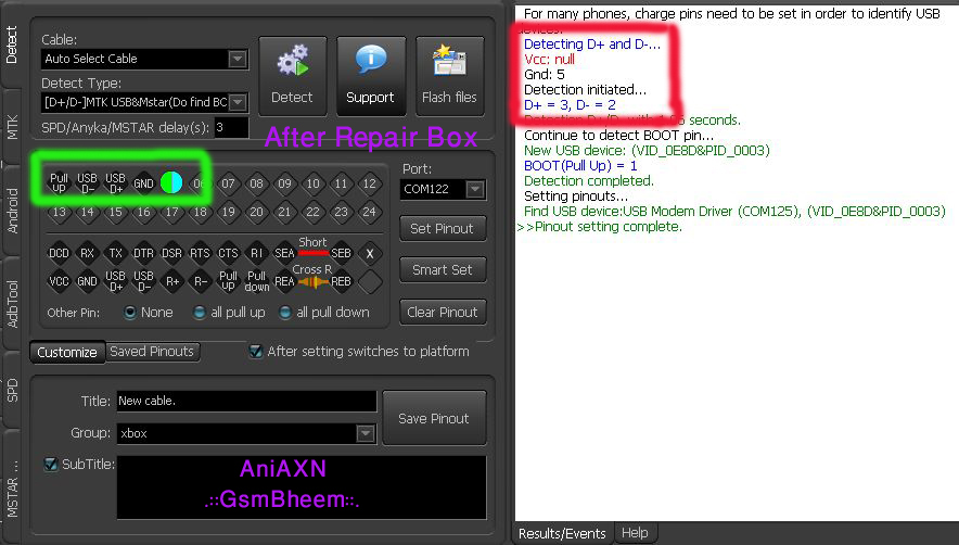

    After Doing Modify PCB Now See the Detect Shot
    biggrinAll is Ok Now Do Any Think as You Wantbiggrin
