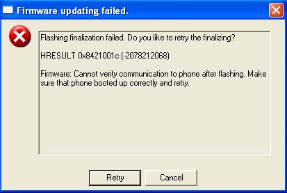

    لوج التفليش على كراك الفونيكس وما زالت المشكله قائمه
    Flashing started
    Creating product data items list
    Product data items list created
    Backup not required
    Flashing phone
    Initializing
    Download files list initiated
    Waiting for USB device...
    Booting...
    Sending EBL loader...
    Sending EBL...
    Boot successful
    Downloading file: rm607__04.40.mcusw
    Erasing 131070 bytes...
    Total progress: 6%
    Sending data...
    Total progress: 12%
    Erasing 262142 bytes...
    Total progress: 15%
    Total progress: 18%
    Sending data...
    Total progress: 24%
    Total progress: 30%
    Sending data...
    Total progress: 36%
    Erasing 1048574 bytes...
    Total progress: 38%
    Total progress: 40%
    Total progress: 42%
    Sending data...
    Total progress: 48%
    Erasing 24641534 bytes...
    Total progress: 50%
    Total progress: 52%
    Total progress: 54%
    Sending data...
    Total progress: 56%
    Total progress: 58%
    Total progress: 60%
    Data send complete
    Downloading file: rm607__04.40.ppm_m_a
    Erasing 3302318 bytes...
    Total progress: 62%
    Total progress: 64%
    Total progress: 66%
    Total progress: 68%
    Total progress: 70%
    Sending data...
    Total progress: 73%
    Total progress: 76%
    Total progress: 79%
    Data send complete
    Downloading file: rm607__04.40.image_m_a_0596697
    Erasing 11927550 bytes...
    Total progress: 81%
    Total progress: 83%
    Total progress: 85%
    Sending data...
    Total progress: 87%
    Total progress: 89%
    Total progress: 91%
    Total progress: 93%
    Erasing 917502 bytes...
    Total progress: 95%
    Total progress: 97%
    Total progress: 99%
    Total progress: 100%
    Data send complete
    Resetting device
    Phone flashing completed. Waiting for phone to boot up
    Bootup successful
    Verifying communication to product (before flash finalizing)
    Failed to verfy communication to product
    ثم تظهر هذه الرساله
    [IMG]09469052492544806016 thumb[/IMG]
