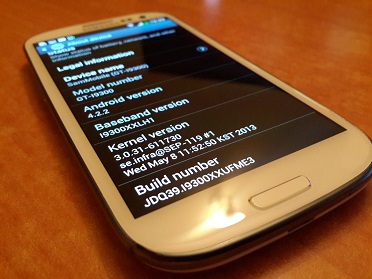

    Post التسريب الاول من النسخه android 4.2.2 لجالاكسى s3
    android 4.2.2
    لجلاكسى
    s3
    i9300
    تقدر تحمل الفلاشه
    من
    هنـــــــــــــا
    I9300XXUFME3_I9300OJKFME
    الفلاشه انترناشونال
    يوجد بها اكثر من لغه
    Firmware Details
    Android Version: 4.2.2 – JDQ39 (Jelly Bean)
    PDA: I9300XXUFME3
    CSC: I9300OJKFME1
    MODEM: N/A
    Region: Middle East
    Carrier: Branded
    Changelist: 611730
    Build Date: 8 May 2013
    مميزات الروم
    New enhancements in Android 4.2.2 update
    - Android 4.2.2 – Build ID: JDQ39
    - New S4 Lockscreen: Multiple Widgets, two Unlock effects (Ripple and Light), improved ripple effect than Android 4.1.2, ability to change clock size and set a personal message
    - New Screen modes (From S4): Adapt Display and Professional Photo
    - Daydream
    - Driving mode
    - Actionable notifications
    - New Additions in Notification Center
    - Completely revamped Settings UI (Tabbed interface – Exactly like the S4)
    - Addition of Voice controls (Let’s you control various parts of the phone using voice commands – Galaxy S4 feature)
    - Gallery modes have white background (When changing gallery modes to 3D the background changes to white)
    - Full screen Samsung apps
    - New S-Voice (from S4)
    - New smart switch widget
    - Found more? Tell us about them in the comments below!
    WARNINGS
    - This firmware will increase your binary counter but the current binary and system status will remain official.
    - We have re-packaged this firmware from dump files.
    - There is no modem in this firmware, so the Modem you will be using before flashing this firmware will remain the same.
    - This is a pre-release firmware and not official from Samsung.
    - We have fully tested this firmware and this firmware works perfectly as any other official firmware.
    طريقه التفليش
    Flashing Instructions
    - Unzip the file
    - Open Odin 3.04 (already included in the firmware package)
    - Restart phone in download mode (Press and hold Home + Power + Volume down buttons)
    - Connect phone and wait until you get a blue sign in Odin
    - Add I9300XXUFME3_I9300OJKFME1_HOME.tar.md5 to PDA
    - Make sure re-partition is NOT ticked
    - Start flash, sit back and wait a few minutes.
    - If you encounter any issues with the firmware (Any FC, Bootloop etc)
    - Boot into recovery mode (Home+power+vol up)
    - Choose to wipe/factory reset. (THIS WILL ERASE ALL OF YOUR DATA INCLUDING YOUR INTERNAL SD CARD!)
    - Then choose reboot and you should be good to go!
