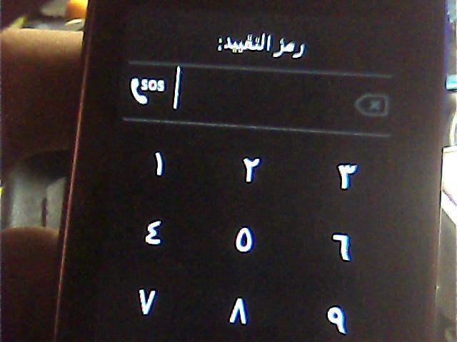

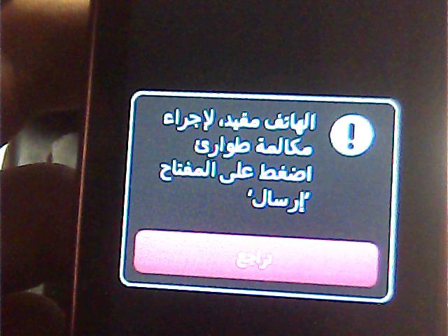

    رمز التقييد ماهؤ الحل يشباب
    نوكيا rm-714

    اخي ارفع رسالة ال Scan للهاتف

    مشكلة في فلاشة نوكيا 311مشكلة في فلاشة نوكيا 311
    المشكله ماكان فيه قبل بعد اتعريب جات

    [Nokia USB Flashing Generic]: Port opened OK!
    Processing pre flash tasks...
    Backing up RPL...
    RPL Creation started...
    Processing CMT Part...
    Proceeding with Recovery Mode...
    Booting CMT...
    Old ROM Detected
    CMT_SYSTEM_ASIC_ID: 000000030000022600010007400C192103032108
    CMT_EM_ASIC_ID: 00001051
    CMT_EM_ASIC_ID: 00001060
    CMT_PUBLIC_ID: 9C4B0000FFFB3C40BAF1072263D4457253829FC0
    CMT_ASIC_MODE_ID: 00
    CMT_ROOT_KEY_HASH: 3AB5DB70B45D23F1ADEEBB5734160706
    CMT_BOOT_ROM_CRC: 2CAC45E2
    CMT_SECURE_ROM_CRC: 3BC33C8B
    CMT Ready!
    Searching for BootCode: DualLine 32Bit
    RAPUv21_2nd.fg, Type: 2nd Boot Loader, Rev: 768.12.14.0, Algo: BB5
    Using NEW BB5 FLASHING PROTOCOL
    Waiting for USB Boot ROM Answer...
    ROM Ret: 0xFFFD125D
    ROM CMT dwAddr: 0x10004FF0
    ROM CMT dwLength: 0x00627837
    Seems ROM Initialized OK!
    Transmission Mode Requested: Control USB, Accepted: Control USB
    FlashChip[0,CMT]: 0x0000000000000000, Unknown, RAM
    FlashChip[0,CMT]: 0xFFFF000000000000, Unknown, MMC
    FlashChip[0,CMT]: 0x0020004000000131, ST, NOR
    FlashChip[1,CMT]: 0x0000000100000000, Unknown, NOR
    FlashChip[0,CMT]: 0x0020004000000131, ST, ONENAND
    Requested Algorithm: XSR 1.6 (CMT)
    FlashChip 0x00200040 (ST), Size: 256MBytes, VPP: Not Supported
    RAPUv21_XSR17_alg.fg, Type: Algorithm, Rev: 768.12.14.0, Algo: XSR 1.6
    Initializing TurboCache...
    TurboCache Loaded!
    Writing CMT PASUBTOC Certificate...
    Writing CMT ALG Certificate...
    CMT Algorithm Ready!
    Transmission Mode Requested: Bulk USB, Accepted: Bulk USB
    Box TX2 Data Pin set to: Service Pin 3
    Waiting for FUR Client become avaiable...
    FUR Avaiable!
    Adding FUR Client (CMT, State: Ready)...
    CMT FUR Ready!
    Overriding VPP Setting, USB can't use VPP
    Box VPP disabled
    Internal CMT Phone VPP Enabled
    PAPUBKEYS Hash for CMT: A3E0AA6F2F86410BA6D666BACF6186EEFBC82D28
    APE Subsystem Not Found
    NPC Backup stored in "9C4B0000FFFB3C40BAF1072263D4457253829FC0_09-06-2013_105955.NPC.CMT.crt"
    [Nokia Asha 311 USB Phonet]: Port opened OK!
    Set to Recovery Mode Finished
    Storing Product Code...
    Storing PSN...
    Storing HWID...
    Simlock Store not supported, not a PA_SL2 Phone
    Trying to store WMDRM RPL...
    Reading Keys...
    Failed to read WMDRM Key
    Reading Security Block...
    Security block OK and saved to "RM-714_12345610654321_09-06-2013_110007.SecurityBlock.PM"
    "9C4B0000FFFB3C40BAF1072263D4457253829FC0.C000612F" Exists, That is good...
    Storing Additional Data...
    Checking Superdongle Key...
    Superdongle Store Problem -> Failed to decode Security Section, Box Reported: Security Section Not Found (SL3 phone?)
    Checking CMLA Key...
    CMLA Key Store Problem -> Failed to decode Security Section, Box Reported: Security Section Not Found (SL3 phone?)
    Booting CMT...
    Switching to RAW Mode...
    Old ROM Detected
    CMT Ready!
    ROM Ret: 0xFFFD125D
    TurboCache Loaded!
    FUR Avaiable!
    CMT FUR Ready!
    Box VPP disabled
    Storing NPC...
    Storing CCC...
    Storing HWC...
    CMT VARIANT Not Found
    CMT PARTNERC Not Found
    Restoring from Recovery Mode...
    Restored from Recovery Mode OK
    Restarting MCU...
    RPL Saved OK
    RPL backup thread finished, continuing...
    Pre flash tasks finished, continuing...
    Processing rm714__05.92.mcusw (CMT)...
    Booting CMT...
    Old ROM Detected
    CMT Ready!
    rm714__05.92.mcusw, Type: Flash Image, Algo: BB5, XSR 1.6
    ROM Ret: 0xFFFD125D
    TurboCache Loaded!
    FUR Avaiable!
    CMT FUR Ready!
    Box VPP disabled
    Sending Certificates...
    Certificates OK
    Partitioning...
    Partitioning OK
    Started group flash erase
    EraseArea[0,CMT]: 0x00040000-0x000403FF, ONENAND
    EraseArea[0,CMT]: 0x000C0000-0x0013FFFF, ONENAND
    EraseArea[0,CMT]: 0x00140000-0x004BFFFF, ONENAND
    EraseArea[0,CMT]: 0x004C0000-0x0073FFFF, ONENAND
    EraseArea[0,CMT]: 0x00740000-0x0173FFFF, ONENAND
    EraseArea[0,CMT]: 0x00160000-0x0017FFFF, ONENAND
    EraseArea[0,CMT]: 0x03E40000-0x0447FFFF, ONENAND
    EraseArea[0,CMT]: 0x0F080000-0x0F67FFFF, ONENAND
    EraseArea[0,CMT]: 0x01740000-0x02ABFFFF, ONENAND
    EraseArea[0,CMT]: 0x02AC0000-0x02F3FFFF, ONENAND
    Erase Partition (CMT)
    Waiting 320s for erasure finish...
    Erase taken 0.641s
    Writing all blocks...
    TurboCache Loaded!
    Writing CMT KEYS Certificate...
    Writing CMT PAPUBKEYS Certificate...
    Writing CMT DSP0 Certificate...
    Writing CMT MCUSW Certificate...
    Writing CMT MCUSW1 Certificate...
    Writing CMT GENIO_INIT Certificate...
    Writing CMT ISA+DYNSW Certificate...
    Writing CMT ADA Certificate...
    Writing CMT PRIMAPP Certificate...
    Writing CMT RAP3NAND Certificate...
    Writing CMT UPDAPP Certificate...
    Writing CMT ISA+EXTDRV Certificate...
    Programming Status OK!
    All blocks written OK! Time taken 5.94s
    Flashing Speed: 54891.37 kBit/S
    Processing rm714__05.92.mcusw (APE)...
    Processing rm714__05.92.ppm_s (CMT)...
    rm714__05.92.ppm_s, Type: Flash Image, Algo: BB5, XSR 1.6
    Partitioning...
    Partitioning OK
    EraseArea[0,CMT]: 0x02F40000-0x03E3FFFF, ONENAND
    Erase taken 0.140s
    TurboCache Loaded!
    All blocks written OK! Time taken 1.484s
    Flashing Speed: 73740.61 kBit/S
    Processing rm714__05.92.ppm_s (APE)...
    Processing rm714__05.92.image_s_059F7Q5 (CMT)...
    rm714__05.92.image_s_059F7Q5, Type: Flash Image, Algo: BB5, XSR 1.6
    Partitioning...
    Partitioning OK
    EraseArea[0,CMT]: 0x04480000-0x0F07FFFF, ONENAND
    Erase taken 2.406s
    TurboCache Loaded!
    All blocks written OK! Time taken 11.328s
    Flashing Speed: 61250.67 kBit/S
