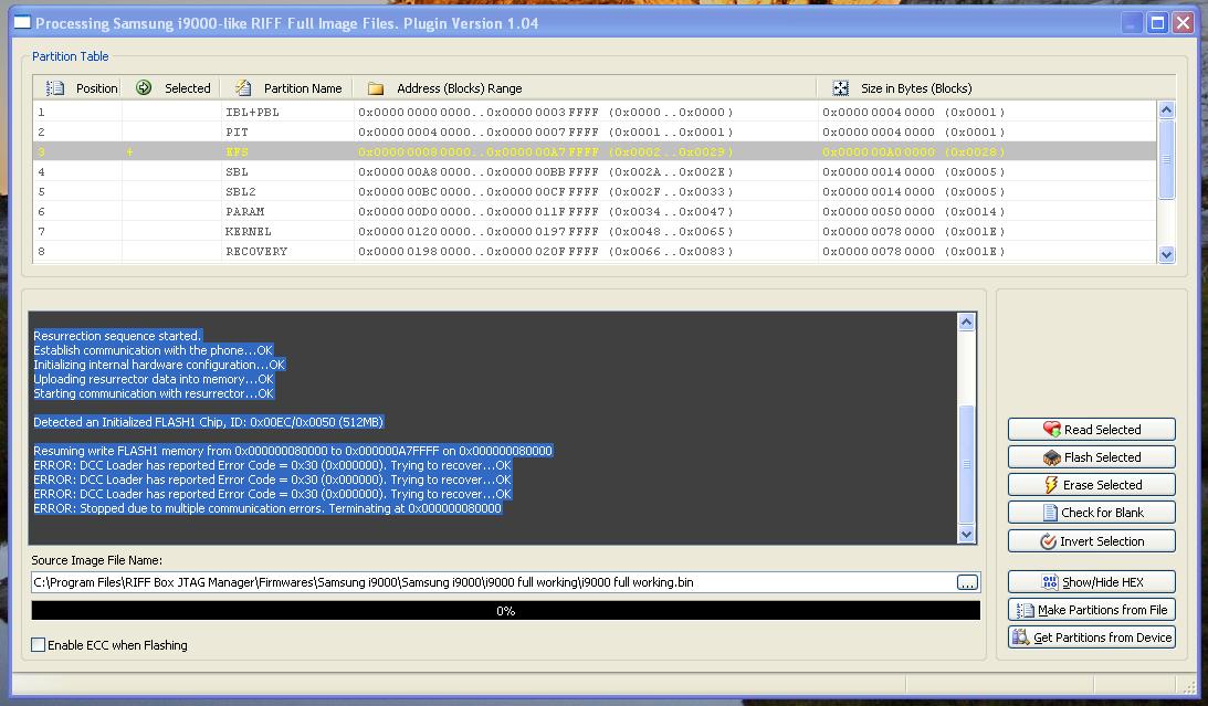

مشكل الجهاز انه فاقد imei وversion de la bande de base
inconnu
وحولة اصلاح منطقة efs بدون جدوا
Open serial port...OK
Connecting to the RIFF Box...OK
Firmware Version: 1.33, JTAG Manager Version: 1.44
Selected Resurrector: [Samsung I9000 V1.00]
Connecting to the dead body...OK
Detected dead body ID: 0x1BA00477 - CORRECT!
Set I/O Voltage reads as 2.81V, TCK Frequency is 10 MHz
Settings Code: 0x00000D00000000000000000000000000
Resurrection sequence started.
Establish communication with the phone...OK
Initializing internal hardware configuration...OK
Uploading resurrector data into memory...OK
Starting communication with resurrector...OK
Detected an Initialized FLASH1 Chip, ID: 0x00EC/0x0050 (512MB)
Resuming write FLASH1 memory from 0x000000080000 to 0x000000A7FFFF on 0x000000080000
ERROR: DCC Loader has reported Error Code = 0x30 (0x000000). Trying to recover...OK
ERROR: Stopped due to multiple communication errors. Terminating at 0x000000080000
مشكل في جهاز i9000
