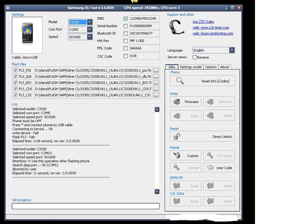

    جائني جهاز c3330 لفك شفرة
    بحثت في المنتدى فوجدت انه لازم عمل له تفليش
    و لما جئت افلشه ب z3x لايريد وها هي صورة
    c3330 لفك شفرة
    Uploaded with ImageShack.us
    99578376823835129464 thumb

    اخي هدا هو انفو لكن فك الشفرة لم تفك ما العمل اخي
    و بارك الله فيك اخي
    Selected model: C3330
    Selected com port: COM5
    Selected speed port: 921600
    Phone must be ON
    Use UART cable E210 or J750
    Phone IMEI: 35804004277812/00
    Phone SN: R21C3020VF
    Phone SN: C3330XXKJ2
    Phone user code: 00000000
    Read user code - ok
    Elapsed time: 4 second, sw ver: 3.5.0035

    تم تفليش الجهاز بنجاح
    لكن لا يريد فك الشبكة هل من حل
    و شكرا و ها هو انفو
    Phone must be OFF
    Press * and connect phone by USB cable
    Connecting to Device... OK
    Sending preloader ... OK
    Sending loader ... OK
    Erasing ... OK
    Sending...C3330DXKL1_psi.fls (psi.fls)
    Writing ... OK
    Sending...C3330DXKL1_slb.fls (slb.fls)
    Writing ... OK
    Sending...C3330DXKL1_BSY.fls (CATFISH.fls)
    Writing ... OK
    Writing ... OK
    Sending...C3330DXKL1_CDS.fls (CATFISH.fls)
    Writing ... OK
    Sending...C3330OLAKL1_CSC.dffs (temp_GT-C3330_OLA.dffs)
    Writing ... OK
    Flash FLS - ok
    Elapsed time: 131 second, sw ver: 3.5.0035
    Attention !!! Use this operation after flashing phone
    Search diag port... OK (COM1)
    Timeout
    Deactivate MSL - fail
    Unlock - fail
    Elapsed time: 97 second, sw ver: 3.5.0035
