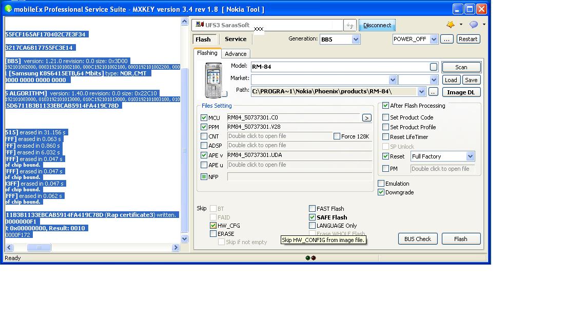

    السلام عليكم . اخواني الاعزاء مثل ما تلاحظون فلشت الجهاز باحدث فلاشة ولكن التفليش بيقطع في البداية ..
    http://39077416477793575933 thumb
    Using device: UFS_USB V2.8 (c) SarasSoft 2007.
    Library version: 1.0.0.9169(08-01-2011), 1.0.0.15596(08-01-2011)
    Preparing phone for SW downgrade ...
    Processing MCU file: RM84_50737301.C0
    [BB5,BB5 ALGORITHM,BB5,OMAP1610 GBBM-1.8.1 ALG] size: 29.41 MB
    Supported Ids: 0003192101002000, 000C192101002000, 0003192101002100, 000C192101002100, 0003192101002200, 000C192101002200
    Supported Ids: 17100701, 17100702
    CMT Data :
    SYSTEM ASIC ID: 000000010000022600010006000C192101002200 [RAP3G ver: PA 2.2]
    EM0 ID: 00000232
    EM1 ID: 00000353
    PUBLIC ID: 1C70011798286851955FCF165AF170402C7E3F34
    ASIC MODE ID: 00
    ROOT KEY HASH: E9EFF4BFAA5393217CA6B17755FC3E14
    ROM ID: F28A211FCEA7B19D
    SecondaryBoot: rap3gv2_2nd.fg [BB5] version: 1.21.0 revision: 0.0 size: 0x3D00
    Supported Ids: 0003192101002000, 000C192101002000, 0003192101002100, 000C192101002100, 0003192101002200, 000C192101002200, 0003192101012200, 000C192101012200
    FlashID0: 00EC 2250 - 0000 0121 [Samsung K8S6415ETB,64 Mbits] type: NOR,CMT
    ExtBUSC: 0000 0000 0000 0000 0000 0000 0000 0000
    TransmissionMode: 16Bit
    Algorithm: RAP3Gv3_algo.fg [BB5 ALGORITHM] version: 1.40.0 revision: 0.0 size: 0x22C10
    Supported Ids: 0103192101003000, 010C192101003000, 0103192101013000, 010C192101013000, 0103192101003100, 010C192101003100, 0303192101023000, 030C192101023000, 0303192101033000, 030C192101033000, 0003192101002000, 000C192101002000, 0003192101002100, 000C192101002100, 0003192101002200, 000C192101002200, 0003192101012200, 000C192101012200, 0103192101001101, 010C192101001101, 0003192101001002, 000C192101001002, 0013192101001002, 001C192101001002
    CMT PAPUBKEYS HASH: 0F72BF9DE5D6711B3B1133EBCAB5914FA419C78D
    TransmissionMode: DDR&TX2
    Partitioning ...OK
    Erase size: 68.92 MB
    CMT NOR area [00000000-0052B515] erased in 31.156 s
    CMT NOR area [006A0000-006BFFFF] erased in 0.063 s
    CMT NOR area [006DF000-006EFFFF] erased in 0.860 s
    CMT NOR area [00700000-007EFFFF] erased in 6.032 s
    APE NAND area [00000000-0000FFFF] erased in 0.047 s
    warning : erase sector address out of chip bound.
    APE NAND area [00010000-0001FFFF] erased in 0.047 s
    APE NAND area [00020000-000203FF] erased in 0.047 s
    APE NAND area [00050000-03ECFFFF] erased in 0.062 s
    Flash programming ...
    CMT PAPUBKEYS: 0F72BF9DE5D6711B3B1133EBCAB5914FA419C78D (Rap certificate3) written.
    Error chk C7012D0100D0000010000000F1
    Error while programming [01] at 0x00000000, Result: 0010
    RX Buffer: C7012D0100D0000010000000F172
