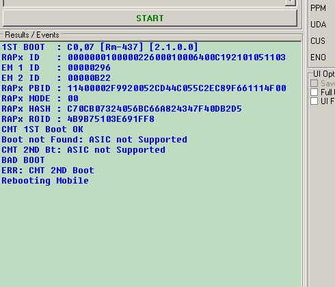

جائني جهاز E63 عند تشغيلة يعطي شاشة زرقاء مع الهزاز لثواني وينطفي
قمت بتفليشة يو اس بي بل الإصدار* rm437_501.21.001_prd.c00
جربت شيك على F-bus وكان
Using device: UFS_USB V2.8 (c) SarasSoft 2007.غيرت اللودر
Library version: 1.0.0.9274(01-03-2011), 1.0.0.15761(01-03-2011)
CMT Data :
SYSTEM ASIC ID: 000000010000022600010006400C192101051103 [RAPIDO3G ver: 1.15]
EM0 ID: 00000296
EM1 ID: 00000B22
PUBLIC ID: 11400002F9920052CD44C055C2EC89F661114F00
ASIC MODE ID: 00
ROOT KEY HASH: C70CB07324056BC66A824347F40DB2D5
ROM ID: 4B9B75103E691FF8
SecondaryBoot: RAPIDOv11_2nd.fg [BB5] version: 9.50.0 revision: 2.0 size: 0x3B40
Supported Ids: 0003192101001203, 000C192101001203, 4003192101001203, 400C192101001203, 0003192101002003, 000C192101002003, 4003192101002003, 400C192101002003, 4003192101011103, 400C192101011103, 4003192101021103, 400C192101021103, 4003192101031103, 400C192101031103, 4003192101011105, 400C192101011105, 400C192101021105, 400C192101031105, 4003192101051103, 400C192101051103, 400C192101051105, 4003192101051105
New Protocol is not supported for the current interface (UFS_USB V2.8 (c) SarasSoft 2007.).
Please select correct loader version from 'Config' menu !
ولم يتغير شيئ
ماهو السبب....
